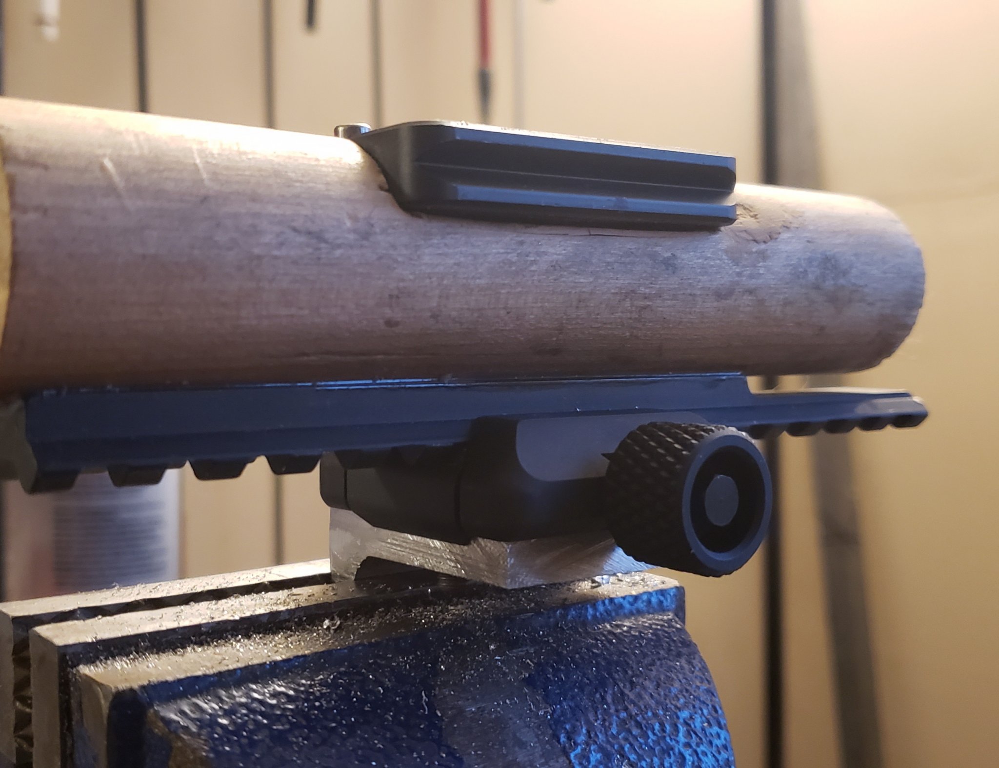

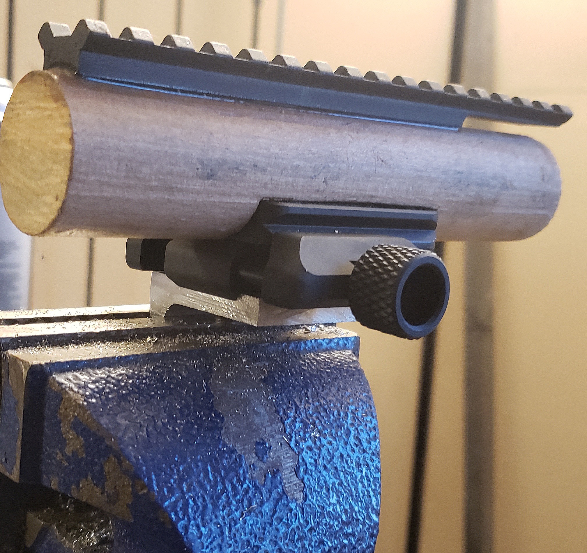

    I had this Magpul bipod mount and earlier today I was trying to figure out what to do with it. I didn't want to just drop it in a bin so I made a thing out of it for my vise.
    Some scrap 1/4" aluminum angle, 10-32 tap, and voila....
    If I want I can secure a flat top upper, barreled action, anything picatinny, it doesn't seem like that will be a problem.
    Or I can throw an arca rail in there to secure a chassis, my scope mounting "jig", etc...
    I have some polymer vise blocks that slip into AICS magwells and AR vise blocks too but most my rifles have picatinny and/or arca interfaces on the underside. If I need to secure it to go hands free to mount an acessory or clean it, this seems like a more svelte solution.

    I think it took longer to lay out the hole spacing than anything else, I think it took me about 10 minutes or so total.
    I had put together something in the same vein last year using a tripod ball head and arca clamp but it was big and not that good of a solution with a heavy rifle. I think this will be mucho better.
