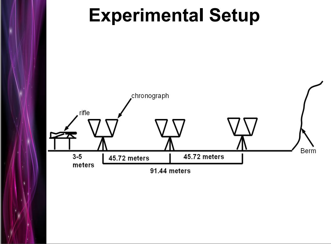

The drag coefficients for the "complete 100 yard interval" were determined from the velocities of the near chronograph at 10 feet from the muzzle and the far chronograph at 310 feet.
The drag coefficients for the "near 50 yard interval" were determined from the velocities of the near chronograph at 10 feet and the middle chronograph at 160 feet.
The drag coefficients for the "far 50 yard interval" were determined from the velocities of the middle chronograph at 160 feet and the far chronograph at 310 feet.

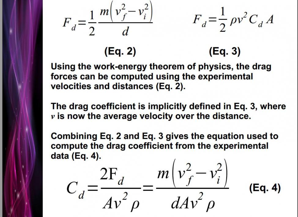

So you shoot one of your cartridges and get, say 800 m/s at the muzzle and 700 m/s after 100 yards. The calculated drag coefficient is allocated to the average velocity of 750 m/s. Then you shoot a cartridge with a lesser charge and get for example 770 m/s at the muzzle and 730 m/s after 50 yards. Again, the drag coefficient is allocated to (the same average velocity of) 750 m/s, but you expect/measure a higher value due to higher pitching and yawing at the first 50 yards. Is that right?
I think you have the gist of it, except that there were 10 shots for each powder charge. I have attached some jpegs with the experimental set-up and equations for further clarity.

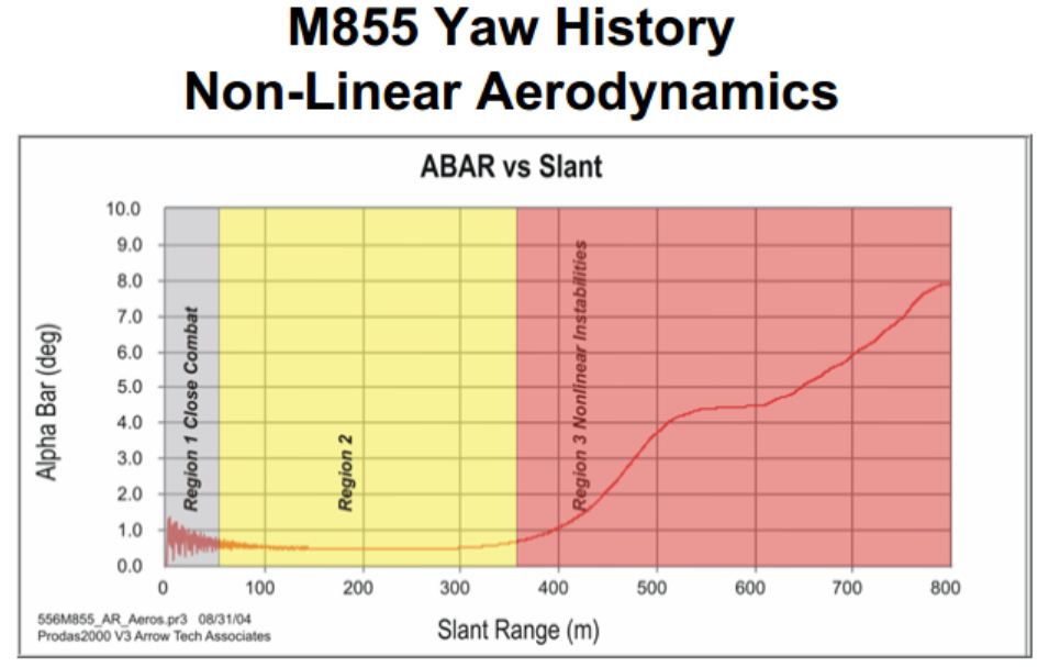

Ha... Don't get me to lying. I understand that past supersonic it "calms down" but I'm no ballistician. Litz would be best suited on that one.
It depends on the bullet and what you mean by "calms down." The 168 SMK is not known to calm down. The attachment (from http://www.dtic.mil/ndia/2005smallarms/tuesday/newill.pdf ) also shows the long range yaw behavior of the M855 bullet in 5.56mm NATO. The damping of yaw in the first 50 to 100 yards is what I consider "going to sleep." The dynamic/nonlinear instabilities that show up at longer ranges are a different thing and depend on other issues.
I could give a hoot. Killing those turkey birds at the present time. But what i meant was when a certain bullet not all, goes subsonic it "lays down" losing velocity and energy a lot less rapidly. Jeez dude. I said I don't and will never know it all. Cut me some slack
Simply, the drag in the subsonic region is much smaller than in the supersonic range.
Good point. However, it should be recognized that even subsonic drag will be much larger than expected if a bullet is dynamically unstable and develops significant pitch and yaw, especially for a long bullet like the 300 grain hybrid in .338. A yaw on the order of 10 degrees will cause both a significant increase in drag and a serious challenge for accuracy. The manufacturer of this bullet had a difficult time accurately measuring the G7 BC (or equivalently the CDO), so I tend to doubt that the other coefficients needed to determine downrange dynamic stability have been measured accurately (the quadratic yaw drag coefficient, the overturning moment coefficient, the gyroscopic stability factor, the lift force coefficient, the magnus moment coefficient, the pitch damping moment coefficient, and the damping rates for the fast and slow yaw modes). Some of these numbers can be accurately determined with PRODAS via numerical modeling, but the obtaining the complete set needed for reliably predicting dynamic stability requires a range fully instrumented with free flight spark photography. A range instrumented with an array of high speed video cameras would also work. An alternate approach to confirming long range dynamic stability would be to measure the drag after the subsonic transition. The Doppler RADAR technique is probably the best approach here.
