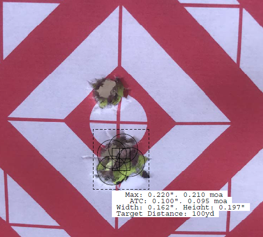

Just curious if yall think cold bores count on groups? Either way, I am very pleased with this grouping.
Here is the measurement with my cold bore shot. 5 shots total.
here it is without the cold bore shot. 4 shots total.
260 remington
savage model 10 action
26" shillen barrel
143 gr ELD-X @ 2975 fps

I'm pretty sure that standard operating procedure on the internet is to place a dime over that cold bore shot and then take the picture. :)
Also, how did you measure your velocity? 2,975 with a 143 grain bullet in a .260 sounds ludicrous.

I should start tracking the cold bore shot more, only reason is that cold bore shots don't seem to matter when you have 10 shots a stage and you confirmed zero earlier on which eliminating the true cold bore.
one of the things that I do to try to minimalize cold shooter is work on some dry fire drills right before I start shooting. this way I remember that exact moment the trigger breaks and get into that right position. Make sure everything feels right before going into pew pew mode.
Im sure a keyboard warrior will say that you are supposed to be able to jump right on your rifle and hit a target from 10,000 yards away everytime while hoping on one leg in 300 mph wind. Well, Im not him.
