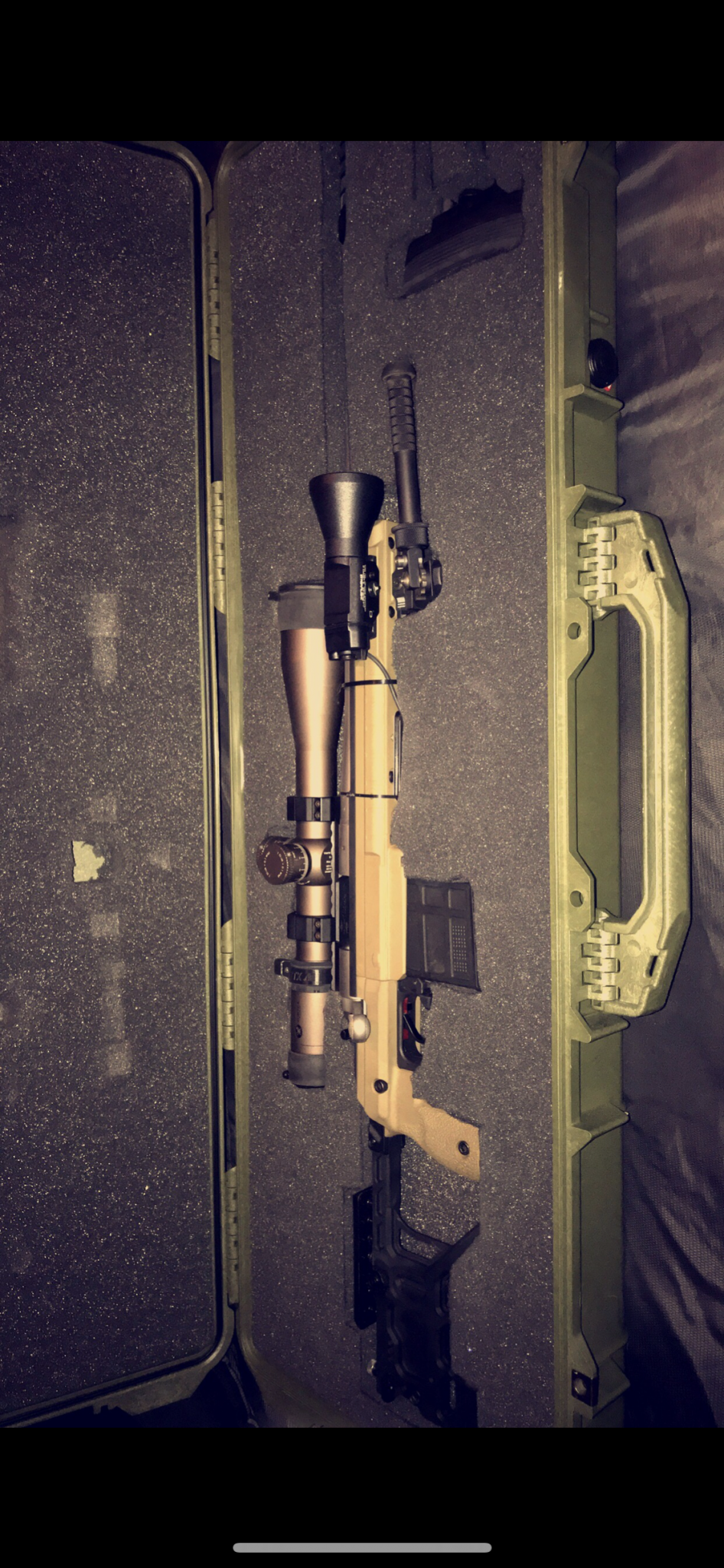

First thread post, new member to the group and was just wanting to get some information on what it’s gonna take for me to get on paper at a 1000 yards. Currently running a Remington 700 .308 fitted in a KRG Whiskey-3 Chasis, Razor 5-20x50 (MRAD) optic and a timnney trigger (uncertain of model). Any and all knowledge is accepted. Thanks.

I’m a 308 addict. Lapua large primer brass with 175 SMKs and any number of powders will get you there in style. I like 8208 xbr, 4064, 4895, and Benchmark for powders. 210m primers never let me down. Great rifle you should be happy. What twist rate are you running. What does the rest of you gear look like. Example, range finder, bipod, level, balastics app and so on.
I shoot my .308 to 1000 yards all the time. Luck to live in NW AZ so lots of room to shoot. the Razor has a lot of travel and if you don't I would put a 20 moa base. I you don't reload the 178ELD-M are a great option as they fly well out to 1000 and past. good luck

Currently running a 1-11 Twist, Atlas PSR Bipod 170-S Lever, Leupold Range Finder, Will need to invest in a spotting scope capable of seeing 1000 Yards. I’ve never shot reloads, just started attempting to shoot long distance, current longest shot is 345 yards with 168 Hornady Match King ammo, made about a 1 1/2 inch 3 shot grouping. Looking to eventually reach the 1000 yard range.
