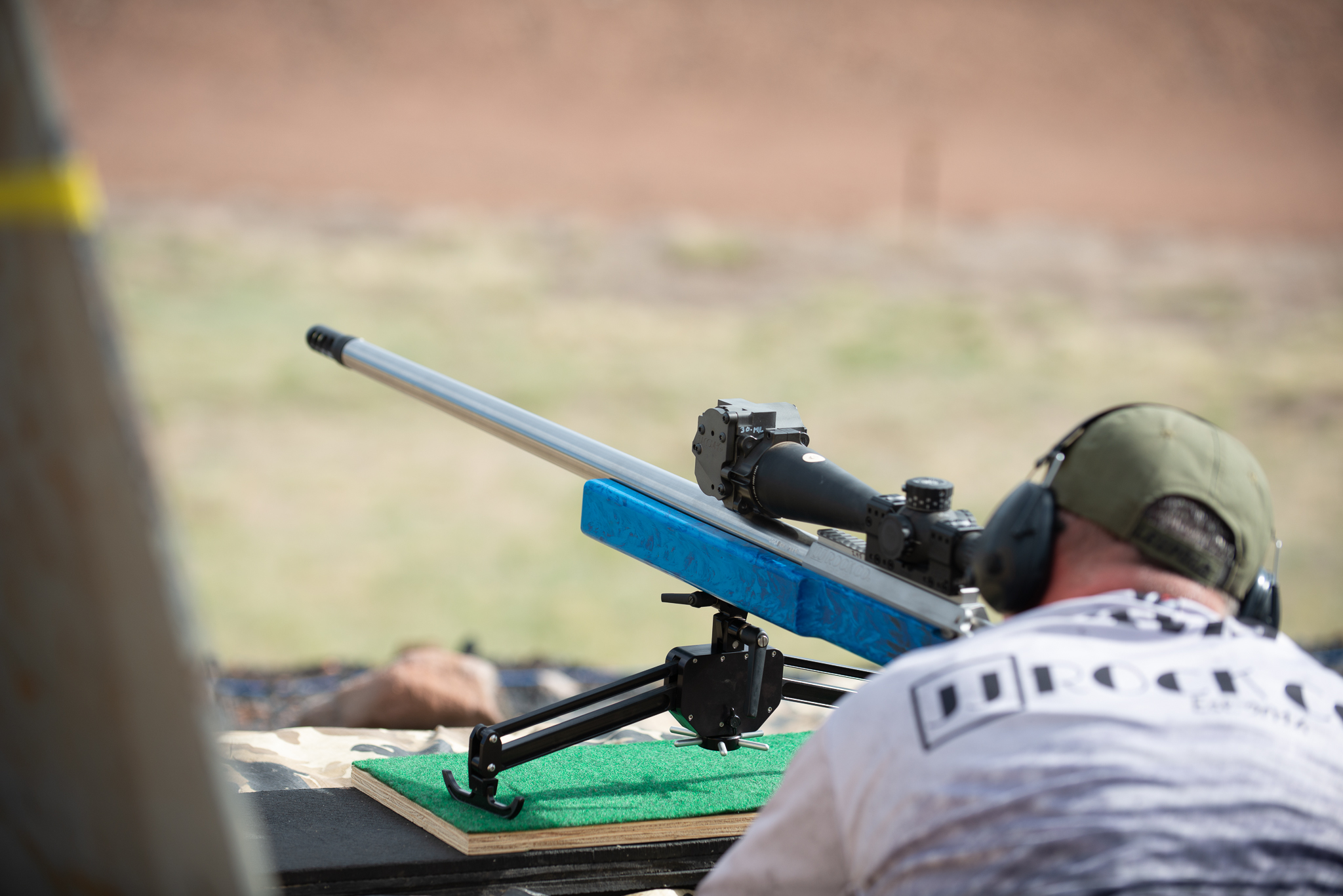

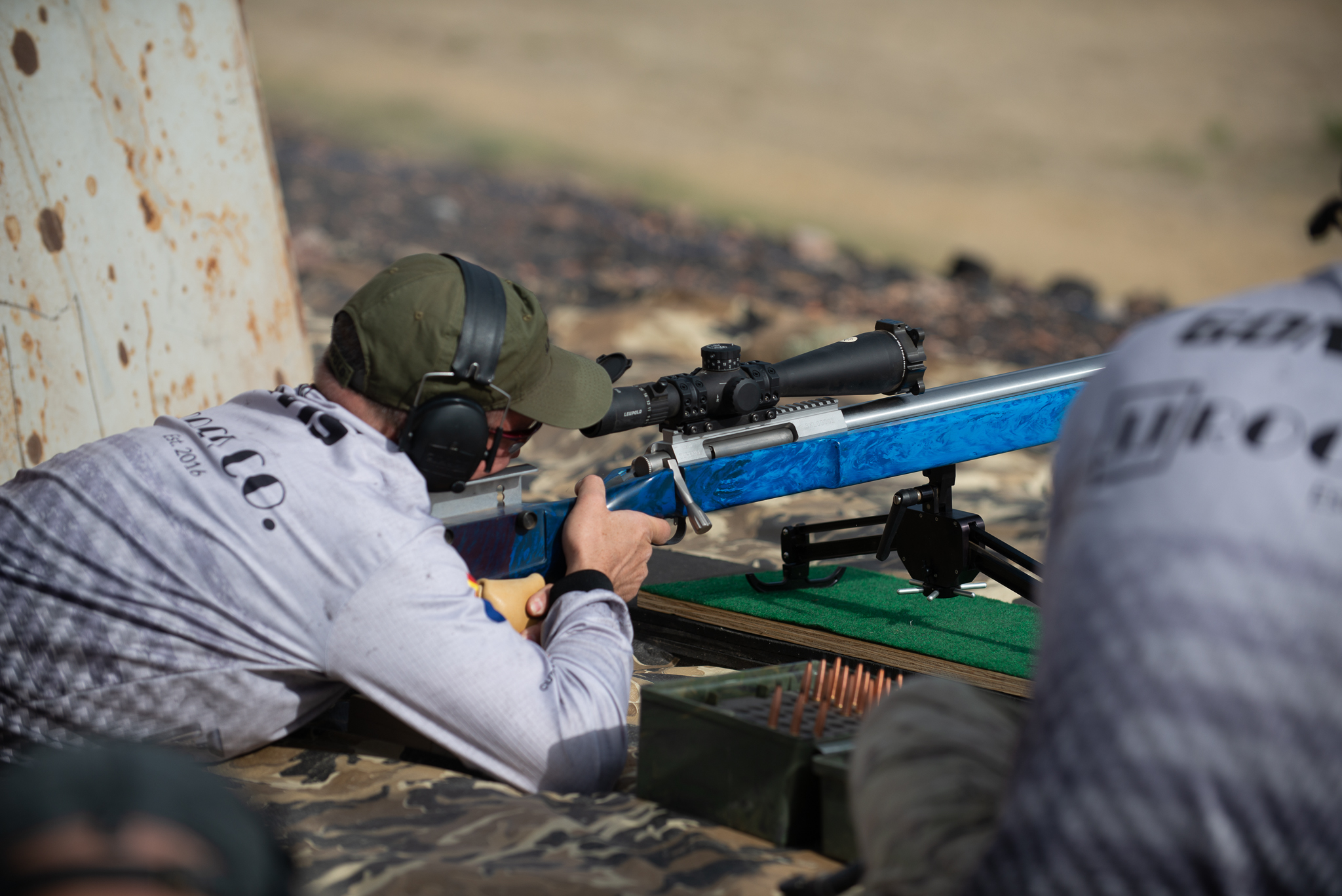

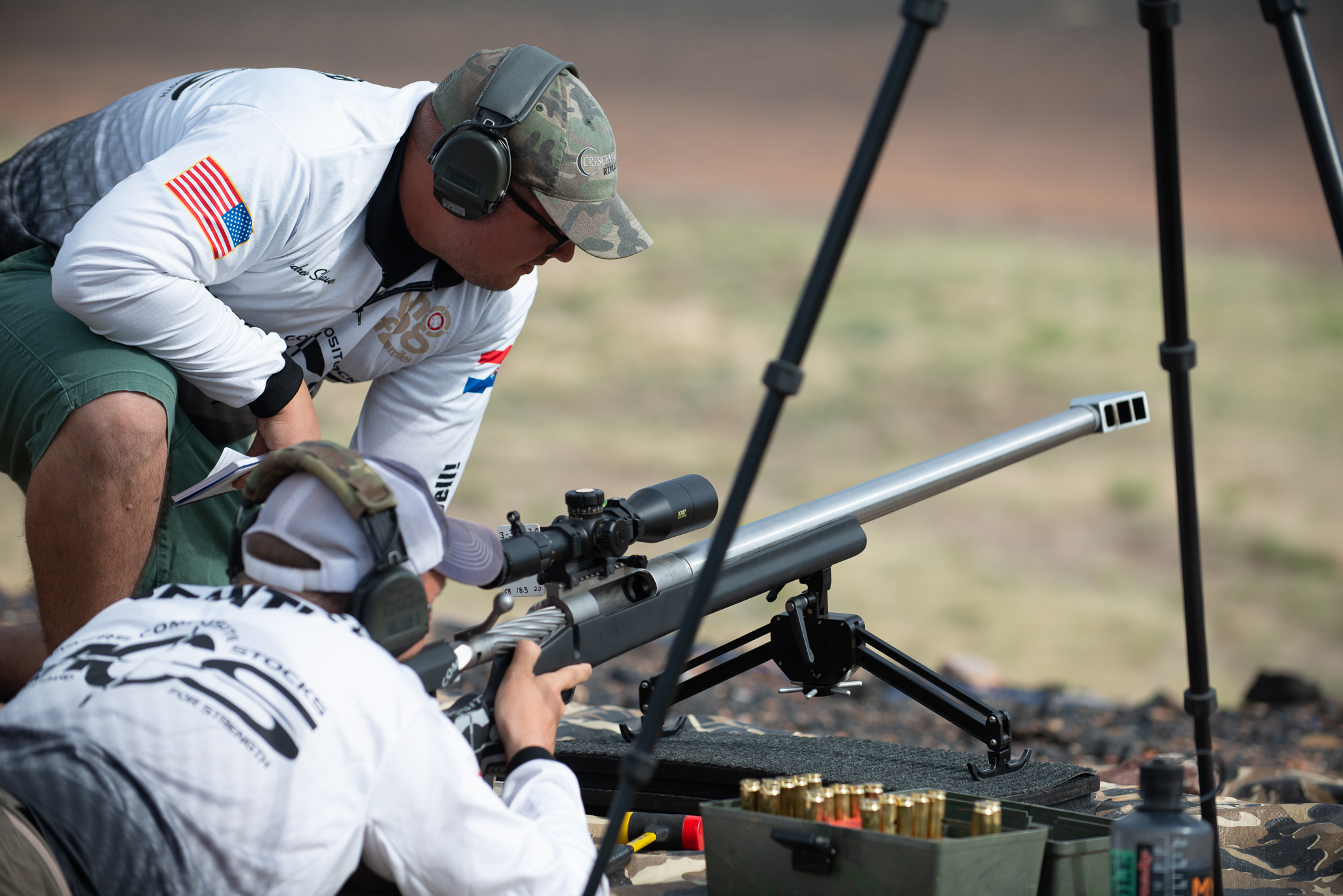

JJRock Team no level, they were top finishers
7051053
7051054
