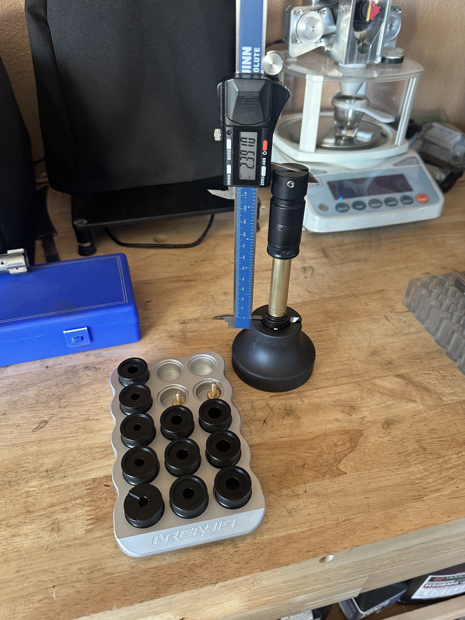

Area419 also has a very nice set with a caliper stand. We own both SAC and 419 sets. Prefer the 419 (splitting hairs). Though it isn't a cheap set.
The stand holding the calipers vertical also helps with consistent measurements as you're using gravity and not your thumb. Pretty easy to have .001-.003 variations simply from different thumb pressure on the calipers.

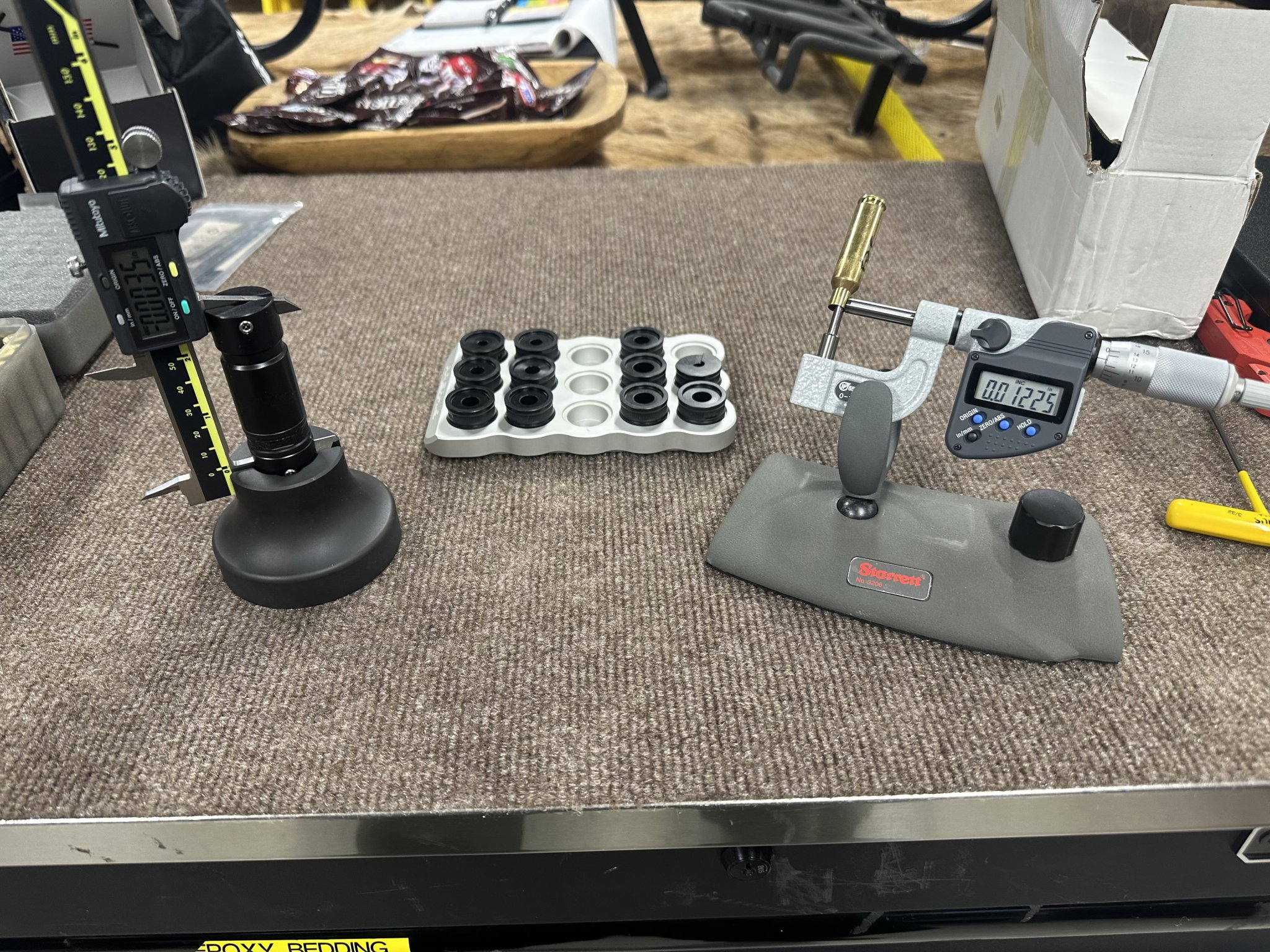

One of the coolest parts is the stand… it’s a bit more money but makes thins so much easier.
One of the coolest parts is the stand… it’s a bit more money but makes thins so much easier.View attachment 8283492
Yeah, I honestly hadn't ever really looked into it. It is pretty slick. I will be glad to have it and I need to sell some of my gadgets and stuff anyway when I move to the new room. It will be nice to have
