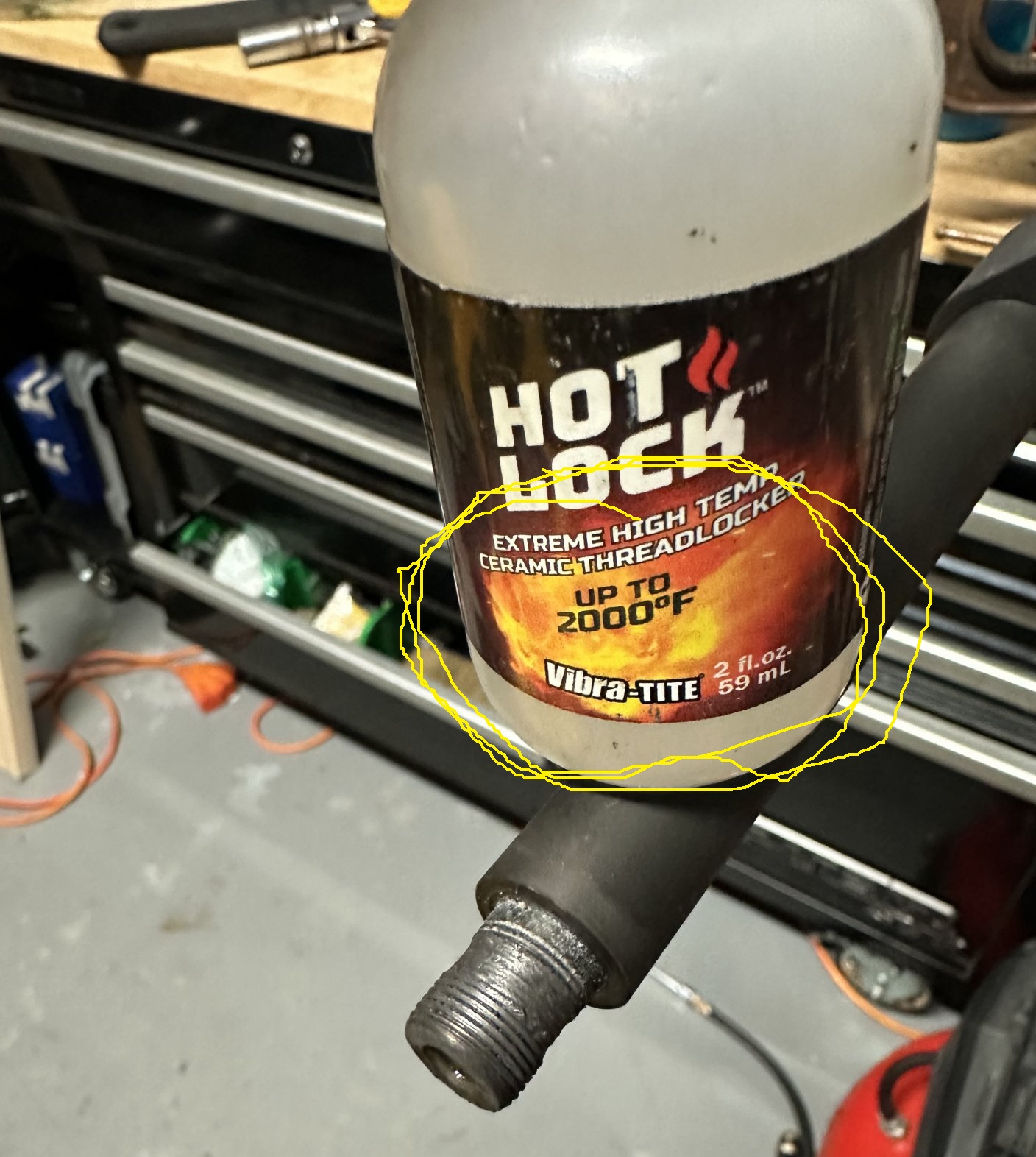

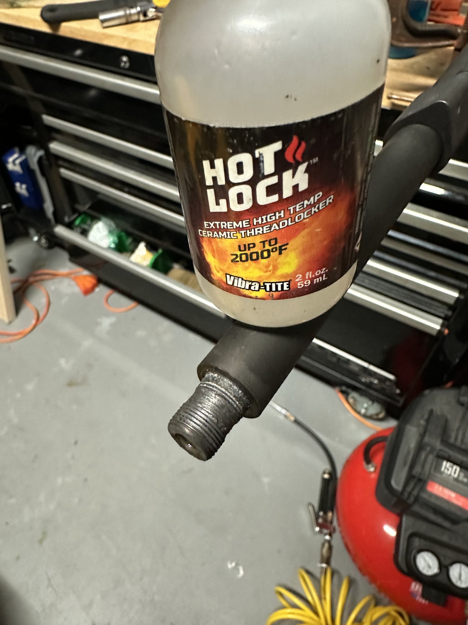

    Be warned, don’t use this shit if you ever want your muzzle device to come off. It was installed per their instructions and removed per their instructions with extended soaking time and it took half of the threads with it.
    After 2 days of soaking in water (how they say to remove it) I called vibratite because the fucker wouldn’t budge and spoke to a lady there. I told her that I had soaked it and it wasn’t coming off and asked if there was a solvent I could use.
    I was advised that soaking in warm water was what dissolved it and that it shouldn’t take long but to keep swapping the water out for warm and to also tap on the muzzle device with a hammer. The lady also said the only person that couldn’t get one off took it to a gunsmith and it was locked on because they used a spacer shim and said the spacer shims are what would lock it… my ass.
    So I soaked it two more days and this was the result when it finally came off.
    I’m going to call them tomorrow and see what they have to say.
    *UPDATE*
    I've spoken to Vibratite and Larue. I spoke to the same lady at vibratite who I guess is the main contact point. I told her I followed her instructions for two whole days of soaking and periodically swapping out with warm water and tapping it with a hammer, and that it came off but the threads came with it. She said this is unheard of and will need to forward this to her chemists to find out what happened (probably what to blame it on to deny responsibility). I'll follow up with their response but it likely won't be until next week.
    Larue gave me as much info about the barrel steel as they could for me to forward to vibratite and also said they've seen the same thing happen with rockset and is partially why they stopped using it and use a non ceramic loctite product now. This failure was not at any fault of them or their barrel but they said if I don't get anywhere with vibratite that they would replace the barrel at a reduced cost which I think is very generous.

    I installed it. Threads on brake and barrel cleaned and degreased with brake clean and alcohol and an even light layer applied to the threads.

    That sucks. Sure fucked up the threads for sure.
    Really, really tough to do a forensics on it. We have seen something as simple as one piece of blast abrasive or a loose tag of metal on a thread termination do the same damn thing on receivers and muzzle devices over the years.

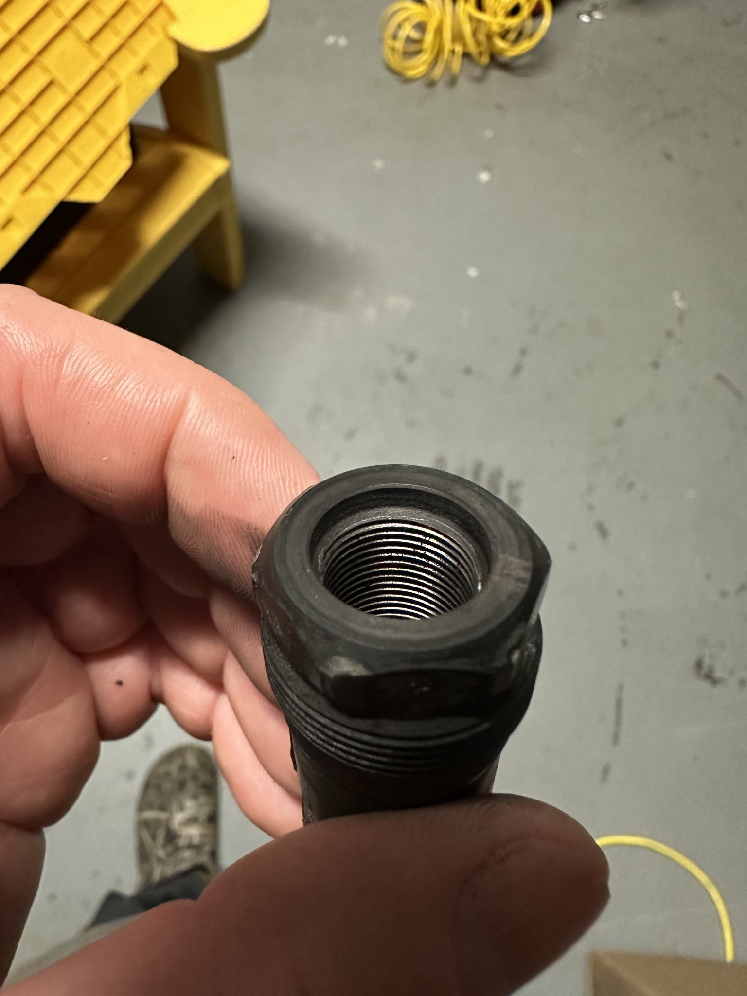

    How do the threads in the brake look?
    Could it have galled up and fucked up threads on the way off?

    Threads in the brake are mint, I’ll clean it up after dinner and try to get some good pics.. It was a nitrided Rearden vs a SS Larue… Rearden won.
    Here’s inside the brake, it’s still a little dirty but no real damage to the threads. I spun it on another barrel and it went on fine.

    I'm parly wondering if this glue/threadlocker is designed for sloppy joints vs precision joints or something.
    Reactions: BurtG
    this joint looks like it was so tight, no water could get thru
    othewise, simply false advertising that its water soluble... :confused:

    I wonder how bad the threads were before the 'smith spun the brake on? I ask because the OP did not mention any metal chips or debris that came off after the brake was removed and it looks like there would have been some chips from the missing threads.

    A smith didn’t spin the brake on, and the threads were flawless when I installed it about 2 years ago. Yes there were plenty of metal chips, I took plenty of pics of those too.
    The hot lock did not dissolve in the middle and the bond and the bond and nitrided brake was stronger than the barrel threads.
    I haven’t had the same experience with Hot Lock across any of the last 10-15 muzzle devices I’ve done and I can’t say I’ve soaked all of them either.

    That looks like it was cross threaded on / off. Thread lock will not remove threads.
