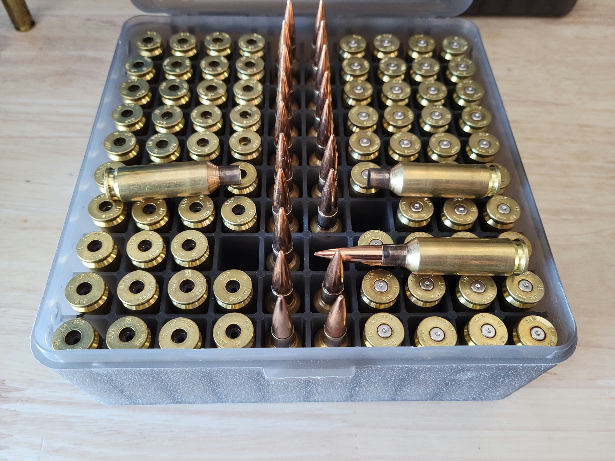

I use both methods, depending on what I'm trying to accomplish with my loads. I don't clean larger batches of brass (usually from 100 - 150 pieces or so), so several dry cleaning methods are more appealing to me. And I've experimented with both methods to see how they can be used for the best use of my time. I do wet tumble sometimes, just not often because my dry tumbling method takes less time than wet tumbling and I like leaving some carbon residue on the inside of the necks. My brass doesn't get very dirt when I fire them as they never touch the ground upon ejection from my bolt guns. Sparkly clean brass just isn't important to me. :giggle: This is good enough for me:
