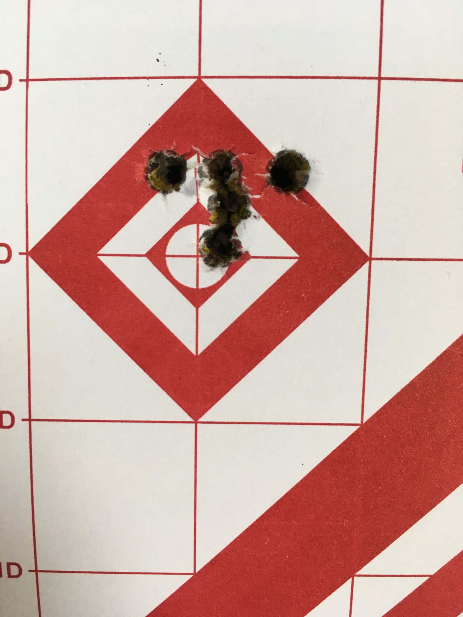

    Here’s an example of why I ask these things. I loaded these for my factory rifle, put them in my match rifle, and this happened. Both times shot suppressed.
    First group (7 shots):
    Tonight’s group (same exact load):

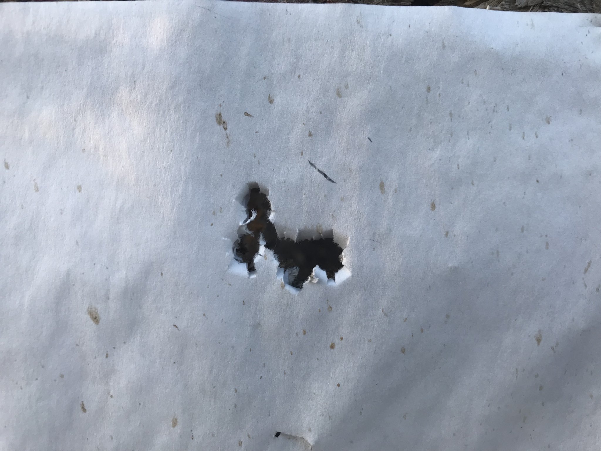

    Hey, I bought your Weaver 6-30... this is how it shot suppressed. I doubt I’ll shoot without it... this was a group of 5-6 shots... I forget. HOT barrel and can! 30-40rd string dialing out to 400-700 and this was the return to zero check. In gusty 15-20 mph winds.

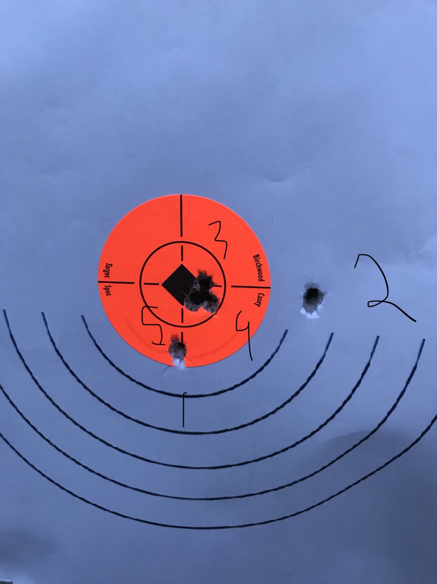

    So I shot suppressed and unsuppressed today on some 55 vmax and accuracy was no different. Just a 2” vertical POI shift. Groups sucked touching the lands and .005” jam.

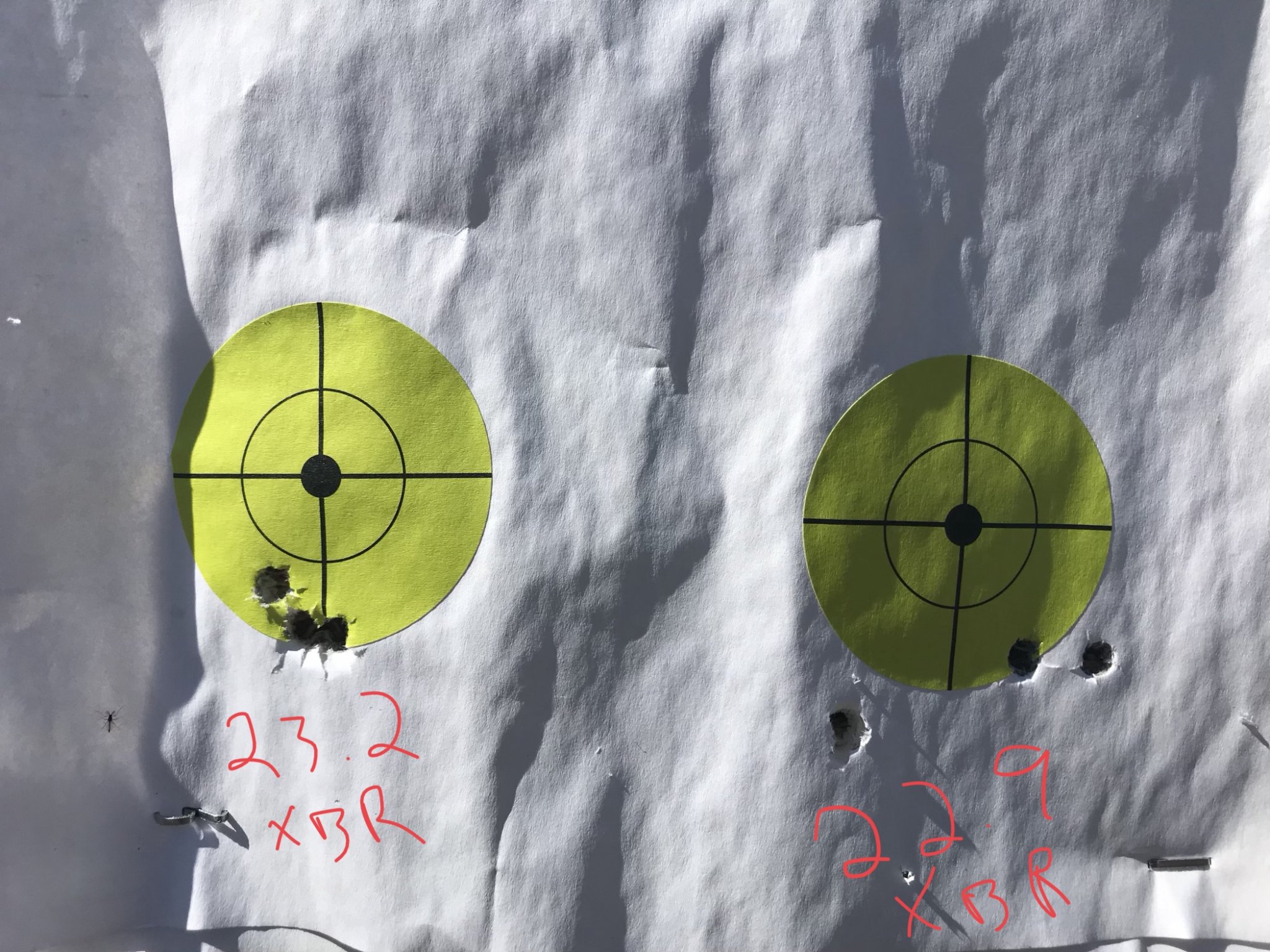

    Switch to 77gr Noslers and shot 22.9gr and 23.2gr IMR XBR loaded to the lands. Is it normally for .3 grains to make such an accuracy difference?

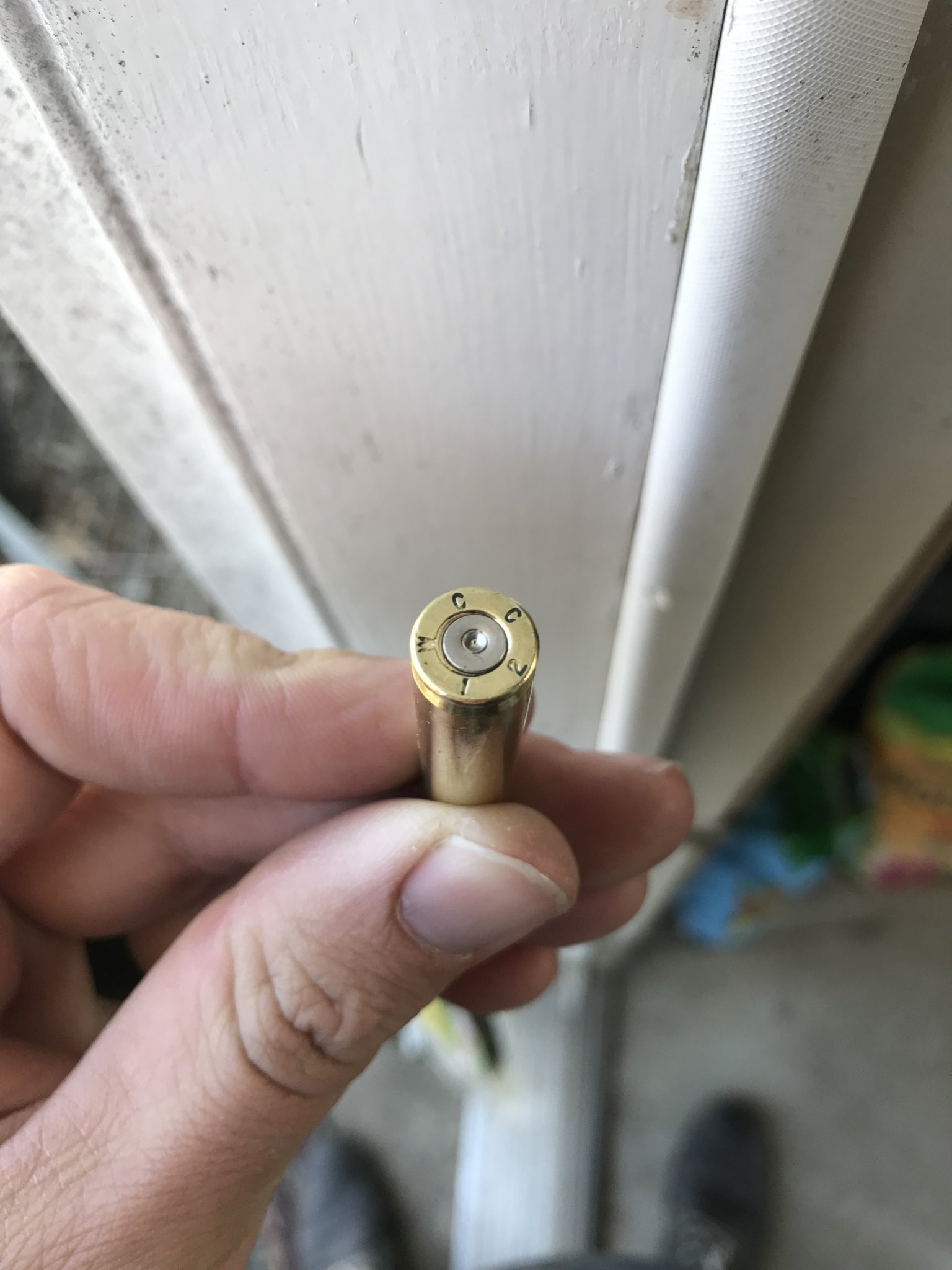

    Also, the problem is my max load of 23.2gr produces the best accuracy but also is flattening primers a bit and making the bolt a little “chunky” on the way up.

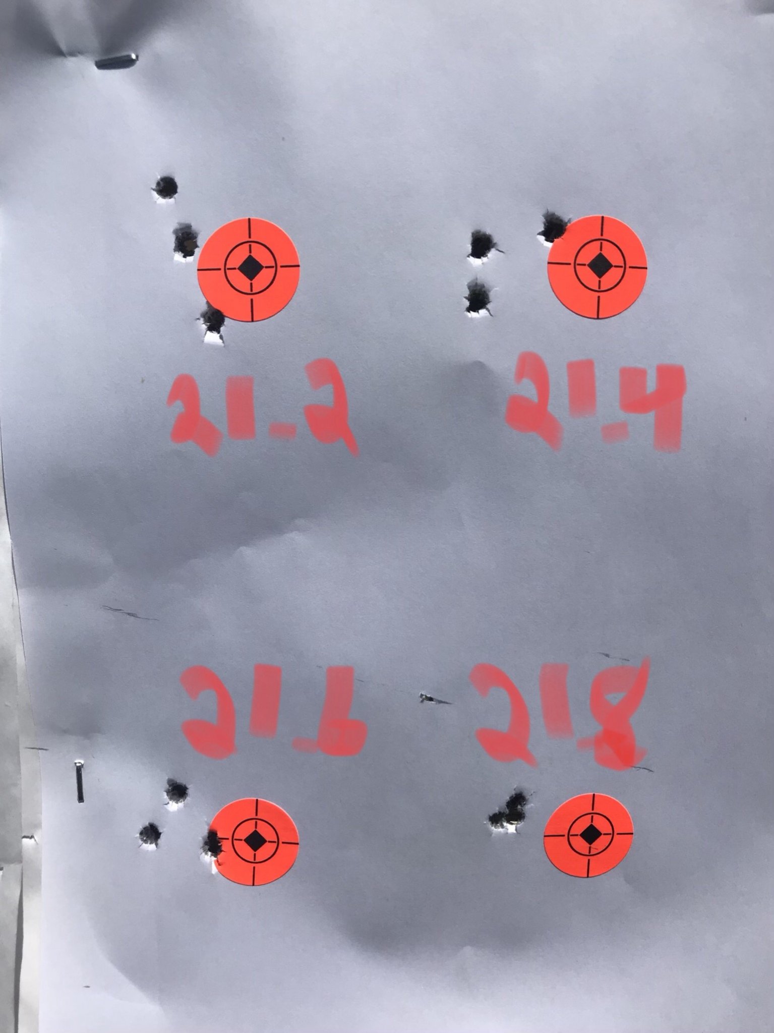

    Not for the heavies. I’ll drop it down a full grain and do the .2 increments to see what happens. What are you starting at for load length? I know some people do it all at a .01-.02 jump but I’ve always had more luck touching or kissing into the lands a hair.
    So start your OCW at the lands and once you find your node, do a seating depth test on that load. It only needs to be three or so different seating depths. One of them will likely show you that it's the one for your rifle.
    Range report. Loaded to the lands and shot the following groups. I’m VERY happy to see that the highest charge provides the best accuracy as well. I think I’ve definitely determined this gun hates a jump. I was shooting factory hornady 75gr HPBT and factory 73 ELD and both groups were absolute garbage again; like 1.25”.
    So now would you shoot a 5 Shot string of that 21.8 and leave depth where it’s at?
