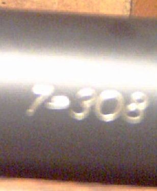

I think I have several problems with my set up. Like thicker neck FGM 308 brass, which ends up even thicker when necked down, and quite a bit shorter than 7/08 spec. My barrel has 7mm 308 on it. Maybe it is diff. than the newer 7/08 version. I was going to neck down some Lapua 308W brass I have, but now I think better to go with real 7-08 brass, or neck up .243 brass, or fireform .243 brass out to 7-08. Will have to start searching for some 7-08 brass. Thank you all for the great tips. Ron.
In 1979 the round was still a wildcat IIRC. You, most likely, do not have a SAMMI spec 7mm08 chamber. And, for the record, I have only had to neck turn brass when I necked up Lapua 260 brass for 7MM08. That was not worth the effort (if you are curious).
I am thinking the SAMMI spec 7-08 had the .316 to .317" neck. Can't seem to bring it up to look again. That was in 4/80 I think. I have a dim from Sierra for 7mm-08 Remington, .315". Also Wiki same. Do these agree with your interpretation? Was the later, after Sammi in 1980, changed to tighter neck? As my bbl shows, 7-308. The buyer got it in 1980, when I called Shilen they said it was made in 1979. Neck meas. .316 after fireing. This is not clear to me what I have, doesn't mean beans really. Just interested in it. Shot this .3" four shot grp yesterday at 100yds, so not complaining. MUCHO workups, etc. to get there. Used neck turned FGM brass, .311" ND. Search for 7-08/243 brass, but ones I saw were OOS. Thanks. Ron.
