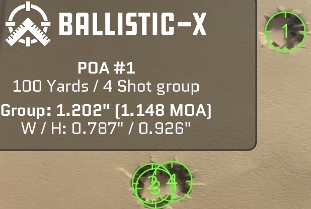

I will say this upper/caliber combo has been the most fickle thing I've ever dealt with. Usually your search for accurate loads on a "ladder" is "not good, okay, better, pretty good, good, great", then back up in size.
This thing is "awful, awful, awful, awful, almost amazing, awful, awful, awful.." :D "How can .3 grains of powder make it open up 2+ inches!"
Today I learned it really likes 29.2 grains of powder for some strange reason. Two different powders, two different bullet brands/weights, four combinations of same, they all liked 29.2
And didn't like anything else.
ETA: A day later, more frustration today.
"...almost amazing..."
Example:
29.2gr
