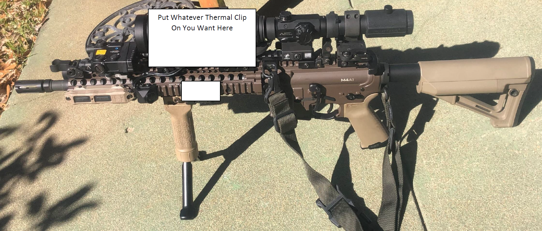

Yep, I run it all on real 1 and done 24 hr guns.
IR Point with IR Illuminate (one press of a button), White Light and Green Vis Point (one press of a button). Green Vis Point Only (one press of a button). White Light Only (one press of a button) 1x Prism with 3X Magnifier for day sight with a thermal clip-on in front of day sight and a Triji RMR on top of thermal clip on so you have a usable day sight at night if you should need without having to remove your clip on thermal. 3X Magnifier is a flip to side or remove for the night if you like. Clip on can be either a shorter range option for the night or longer range option for the night.
Can seamlessly use any of it instantly without turning dials and fumbling for stuff at night etc etc. Takes a good bit of thought to integrate all that into one functional package but it can handle any situation that presents itself.

Sounds cool can you show us a couple of pics
That is the best I can do. Hecque, this rig even has Irons (Tritium Inserts) on it. So if all the electronics and even the etched Prism day sight were to fail, hit all them quick detach mounts and you back to a "stone age rig" in short order. From high tech redneck to low tech redneck before you can say redneck. :LOL:
