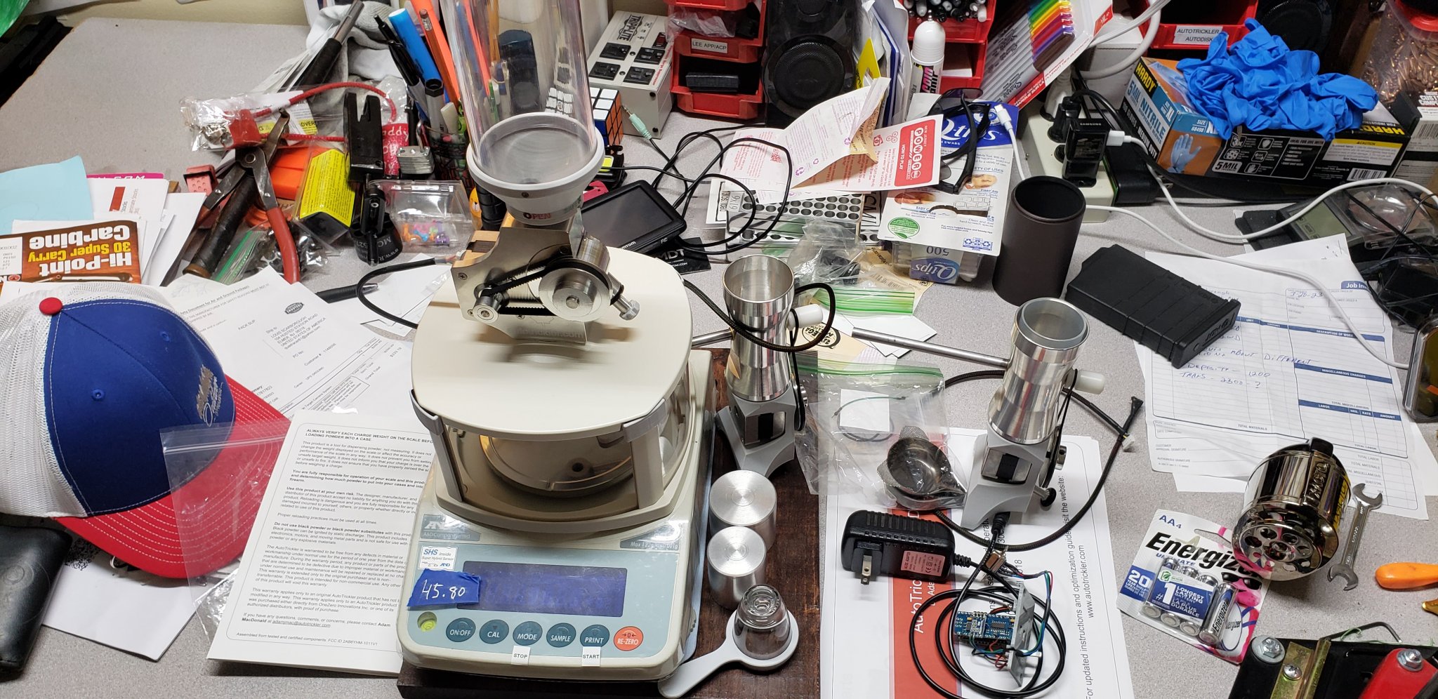

Because I have limited space for reloading, I almost always set up and take down my FX when charging a batch of cases. So, when I'm setting it up I have marks on my heavy duty desk where I align the FX's feet so that it's always exactly in the same place. I've put a little blue Locktite on the threads of the adjustable feet to resist any change in its setting and a small Sharpie mark on each foot the the desk alignment marks for quick and precise alignment; this way my bubble is always centered and no adjustments are needed. Once I plug it in (it's plugged into a good surge protector), I turn it on and let it sit and warm up for a least 1/2 hr. After that half hour I'll zero the setting before I change the mode to grains, then when I change to grains I put a 50 gr test weight on it to be sure I'm getting an accurate measurement (zeroing while mode is still in grams has worked best for me). I have a funnel in the hole at the top I use for trickling into the shot-glass like powder pan, which I fill using a Lee thrower and then trickle up. To keep the surrounding air still, I keep any fans, heating or air conditioning off while the FX is in use so no air is moving through the open front panel of the FX. During the process of charging the cases, I'll test the scale with the test weight to confirm the scale is still giving me the correct weight (once in a great while, usually when it hasn't warmed up long enough, the indicated weight can actually not be true and if so I'll simply re-zero it to bring it back).
I use an RCBS M1000 beam scale, which is sensitive to the individual granule of powder.
Time for me to hand throw and hand trickle a charge on it is ~30 seconds after years of practice. Probably closer to 45 seconds when I started out. Of course, there is no going on to seating bullets etc... while you're throwing a charge as it takes all of your attention. This is where my reloading OCD started.
Upside: I get stupid low ES and SD with quality (Lapua) brass, giving up nothing in consistency to the best scales with auto tricklers.
Downside: It takes considerably longer for me to charge and subsequently seat bullets than the best scales with auto tricklers.
If time is money for you, and you reload to shoot - stay away from my setup. The 120i with auto trickler is a clear winner here.

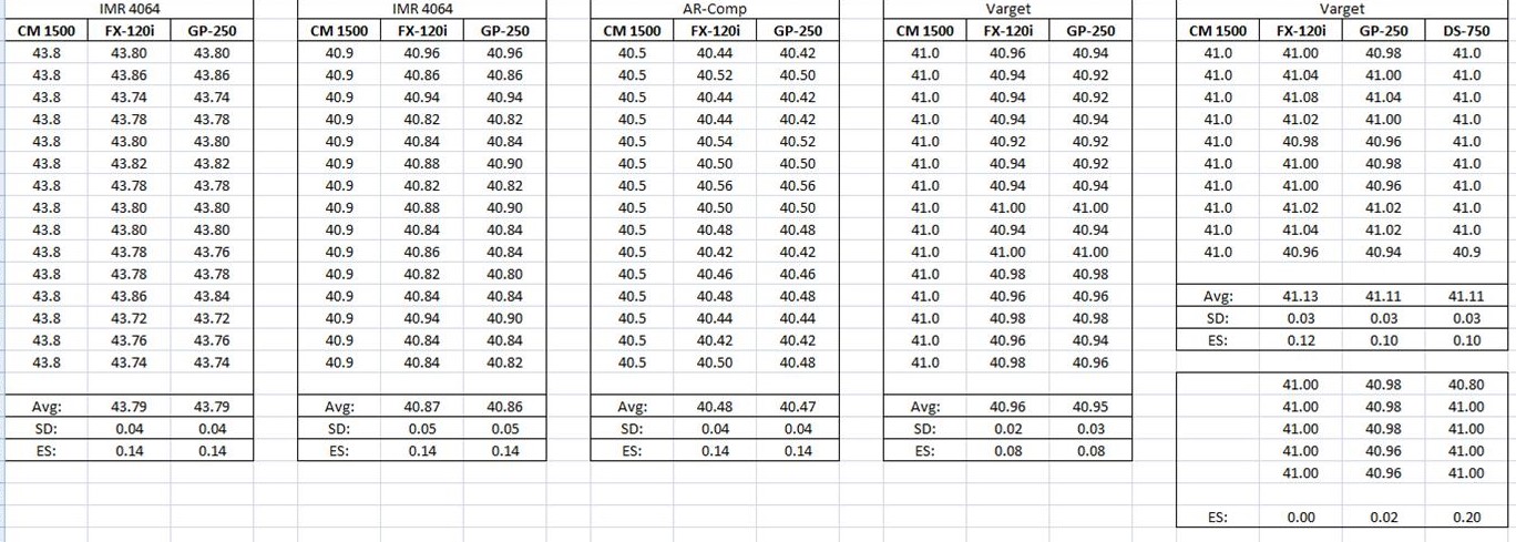

those are real data:
so in reality, if you can operate with ChargeMaster, you wont gain very much by analitic charge. 0.1gr is 4 or 5 kernels of powder.
how much more precise your gun will be with that at short or middle range?
but if you need for long or extra range, you should buy it.
and dont trust people here, who cant operate with scales.
good balance scale (RCBS) is as good as A&D FX-120i and with both you can weight to 1 kernel. so those who get much better results with analitic scale than balance scale, are loosers who cant operate with balance scales.
FYI, in the test @MarkyMark007 posted the data on, I don't know the number of rounds fired but if you compare the 10.7 versus the 8.7 SD and analyze whether the 8.7 is actually better than the 10.7 based on 20 rounds (based on the 20x note) using the F Test for variance there is only a 81% chance that that is the case. This is a case where comparing test data without analyzing it can be misleading. To actually have 95% confidence that the 8.7 is lower than the 10.7 would require a minimum of 66 shots per scale.
I'll catch a lot of S__T over this but if you looking at a good 0.1 grain scale versus a FX-120i you might be a little disappointed. Properly used the FX-120i is a 0.044 grain scale considering its readability and precision. If you are comparing a Chargemaster versus the Autotrickler then its a different situation because the Autotrickler is faster and has a finer trickling capability. This is especially true for the Chargemaster 1500 that had programming hacks to speed it up.

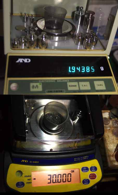

Here's something I posted this on other threads; a comparison I did a couple years ago to get an idea of the accuracy of my CM-1500 using the FX, ChargeMaster, GemPro and a Frankford Arsenal (make of it what you will):
Deja Vu all over again! The load cell and electronics on the Chargemaster are obviously more accurate than the display. The display is a large part of the cost of the scale. The other issue with lower end scales is zero drift which to some extent exists on every scale. The load cell scales use a bridge strain gauge which is not temperature sensitive. The electronics are a different matter. That issue is solved by zeroing (Tare) the scale before every measurement. The Chargemaster 1500 does this automatically when the pan is returned to the platen. The FX-120i also has this feature and it is recommended in the 120 manual. It is common lab practice also.

Warm up both scales for 30 minutes. Place a weight of around 40gr on each and leave it for more than 10 minutes. Note the drift between the two after 10 minutes. Remove the weights, rezero the CM and weigh the same object on both scales. The discrepancy is why the FX is so much more expensive than the CM.

I suggest users of good digital scales perform a drift analysis of your installation.
Temperature differences of floor/bench/nearby walls , and air currents can induce a flowing heat flux.
Check accuracy with a check weight. Like 2 grams for a 30grain charge.
Watch the reading (non zero and large enough for good resolution) over time.
One advantage of having EXTRA resolution is seeing beyond what is needed.
You can always ignore the last digit if you want, but it's there for a confidence check.
One little kernel of SB6.5 is about 25 counts on the top scale, about one count on the bottom scale.
My environment just isn't good enough for the ER-182A.
