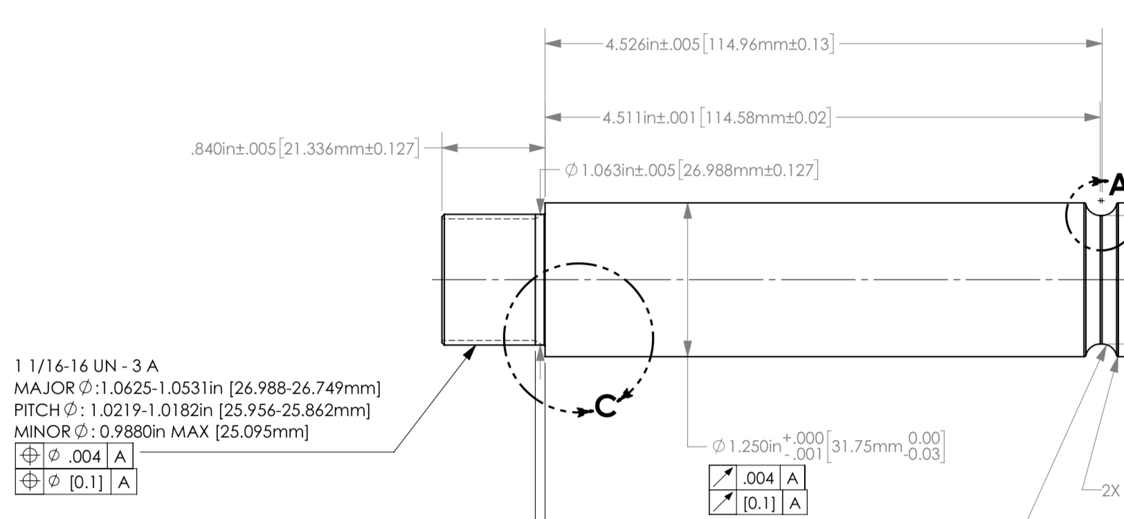

Does anyone Desert Tech barrel specs print for the first gen and the A1?

I want to buy a new barrel for the gen 1 SRS I have and I have an A1 I need to get a 6.5 creed barrel for. At $1200 for a barrel I think I can get my smith to make them far far cheaper with the same Lother Walther barrel blanks DTA uses. Does anyone have the spec prints to profile and thread the barrels?
Thanks,
Ghilly
Here’s the A1/A2 print. I’m not 100% sure but I believe these should apply to the gen1 as well. The extension would be unique of course.
once you factor in wrench to remove/install extension and the cost of an extension, I doubt you can beat the price of a barrel from es-tactical even if the gunsmithing was free
