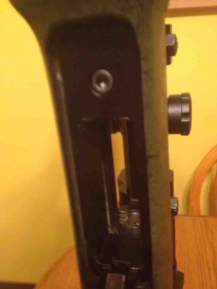

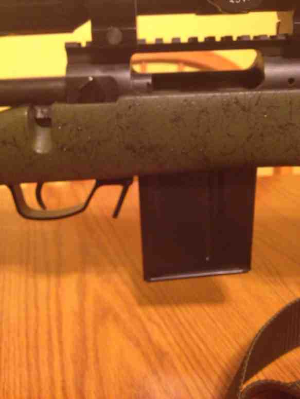

    ImageUploadedByTapatalk1385439706.150923.jpgImageUploadedByTapatalk1385439727.433707.jpg
    Bell and Carlson Tactical Medalist for a Savage Model 10. DBM is CDI. Only complaint is how deep it had to be inlayed. I think smith did a fine job for how the stock was formed very happy with it. DBM is bedded in and I also had the action bedded while I was at it. Id say its worth it! Rifle also shoots < 1 MOA. .40-.65 groups are the norm at 100yds.
