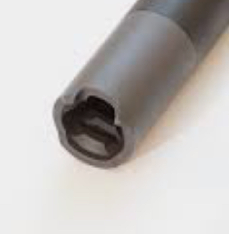

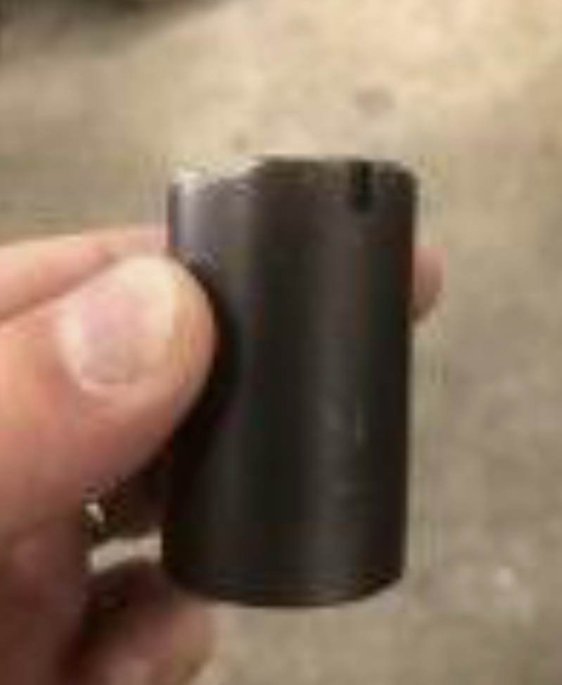

Gen 1 extension has a little notch to index onto a pin in the receiver. Gen 2 extension has large notch to more robustly index off of feed ramp. So the Gen 2 will fit in a Gen 1 receiver, but a Gen 1 extension would be blocked from fitting the Gen 2 receiver.
Gen 1 has little notch to index off of sacrificial pin
Gen 2 improves by making a large notch that indexes off of feed ramp.
So you can see how a Gen 2 would just have the pin slide into that large opening, but the feed ramp would obstruct a Gen 1.
