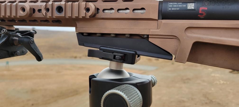

One stock I’ve seen that is designed around an Arca plate is the Manners LRH (long range hunter). Here are some pics, it seems like maaaaybe the rail is recessed enough for hand comfort?

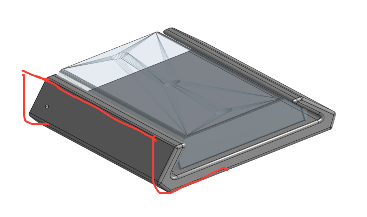

Friend of mine (whose service/industry bonafides you'd like a lot but I'll let him decide what he wants to share if he joins) has gotten a series of increasingly nice 3D printers over the last months, for hobby stuff. Already this morning got him excited for this so:
(May be radiused more than this, etc).
And... it's printing now. I say someone other than me will use this a lot harder so PM me to say you want to be the prototype user and I'll have him ship it to the first one with a good enough story or big enough bribe :)
Retention is a concern (so it can be slid on to install but doesn't slide OFF under general use) so we'll discuss that once it's installed; expect that is the biggest thing to tweak in prototype phase.

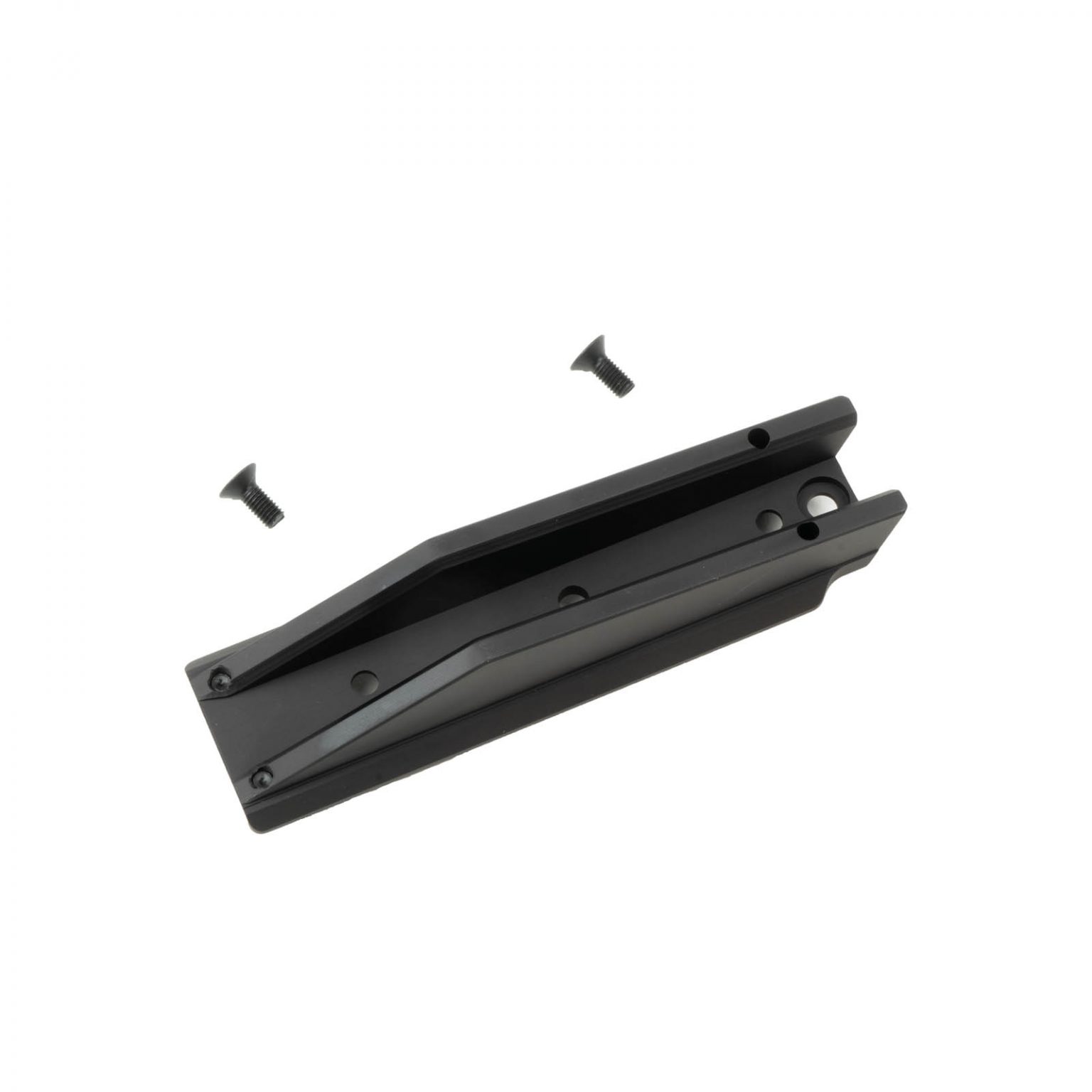

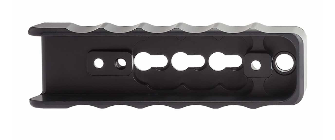

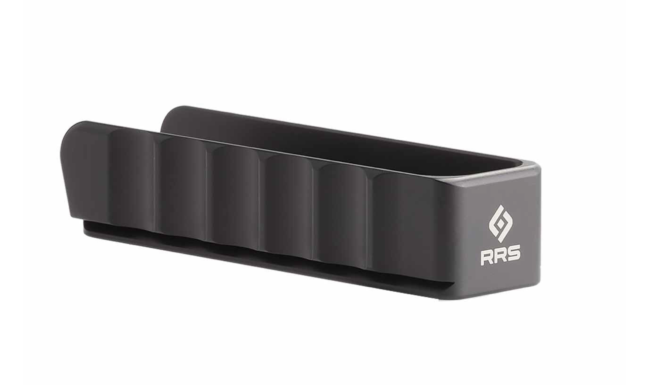

Some people are just not understanding the problem. The solution is to flare out the section that the upper hand grabs so the lower hand doesn’t contact the sharper Arca angle.
Above is a solution that works. I own one; it’s for an AIAX. The upper ridged section is wider than the Arca rail below. It’s leagues more comfy than a better-looking and competing product made by Sawtooth (below). I really hope you can see why.
I own the Sawtooth as well.
If all you do is replace an uncomfortable jutting piece of metal with an uncomfortable jutting piece of plastic, you are not understanding the problem.
Reactions: BurtG and R_A_W

Huh seems I'm a member over here from WAY back... surprised password still worked... Anyway YES I was asked about a cover... not knowing what this is I designed what is seen above... and I can apply a texture to the thing as well, printing from TPU shore 95A if you understand durometer readings.. I can add to it give it grips etc and change length width etc... but I do have to make sure it fits the rail intended in the first place...
