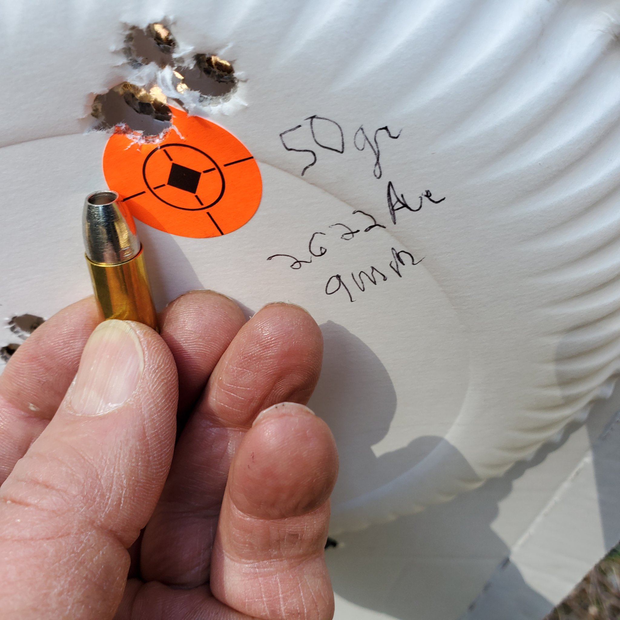

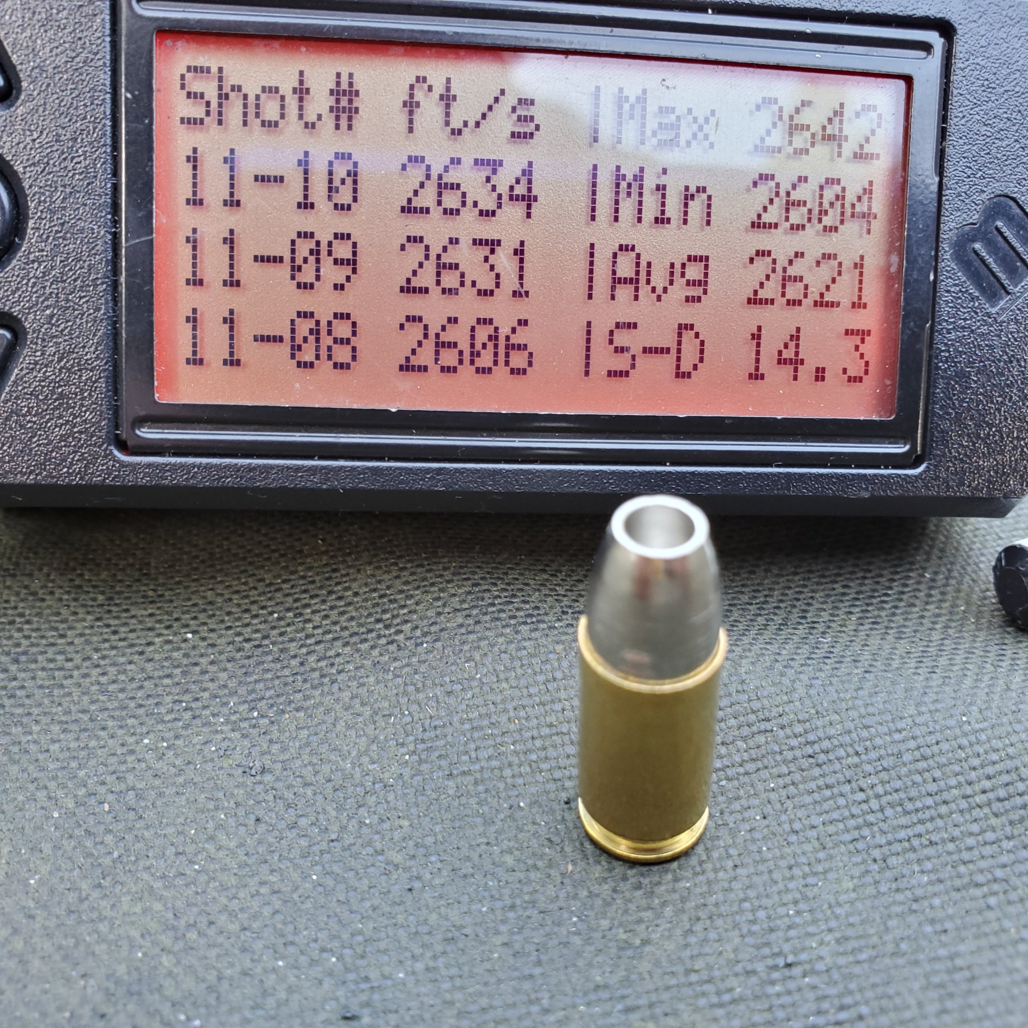

50 gr copper HP 9.0 gr Auto Comp COAL 1.120" 2600 fps.
The 9mm with a 16" barreled AR moves it to 357 mag pistol energy, and easily make hits on 3/4 steel torso at 200 yds ...10 out of 10.
The fastest 9mm load in the 16" AR is this 50 gr copper HP at 2600 fps, and it accurate in my rifle ...but it sheds velocity fast. A fun plinker for reactive targets, and functions well in AR, with the Stern adapter and Glock mags...and 1966 fps in Glock 26...this is the only dual load..but it is ➕ P...mostly an AR load, with an AR 15 set up properly, with heavy adjustable buffer with a few tungsten weights added, so all the AR 15 9mm loads are .1 gr under max in load books or ➕ p loads.

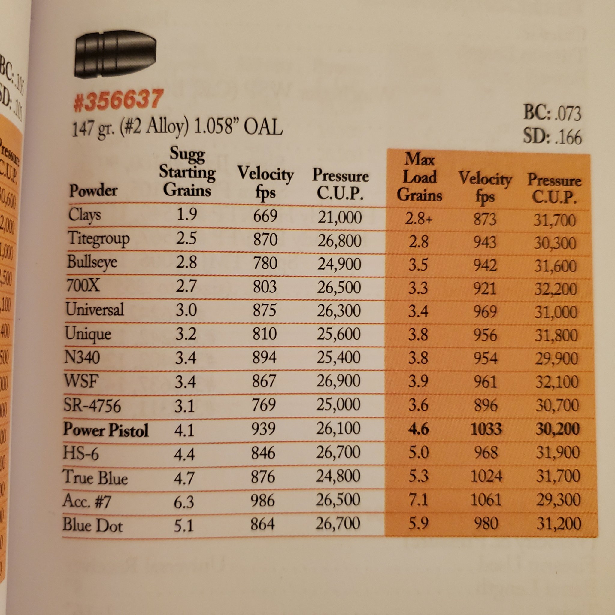

Here is load data for cast bullets 147 gr 9 mm Luger...pick a powder, work uo a load.
