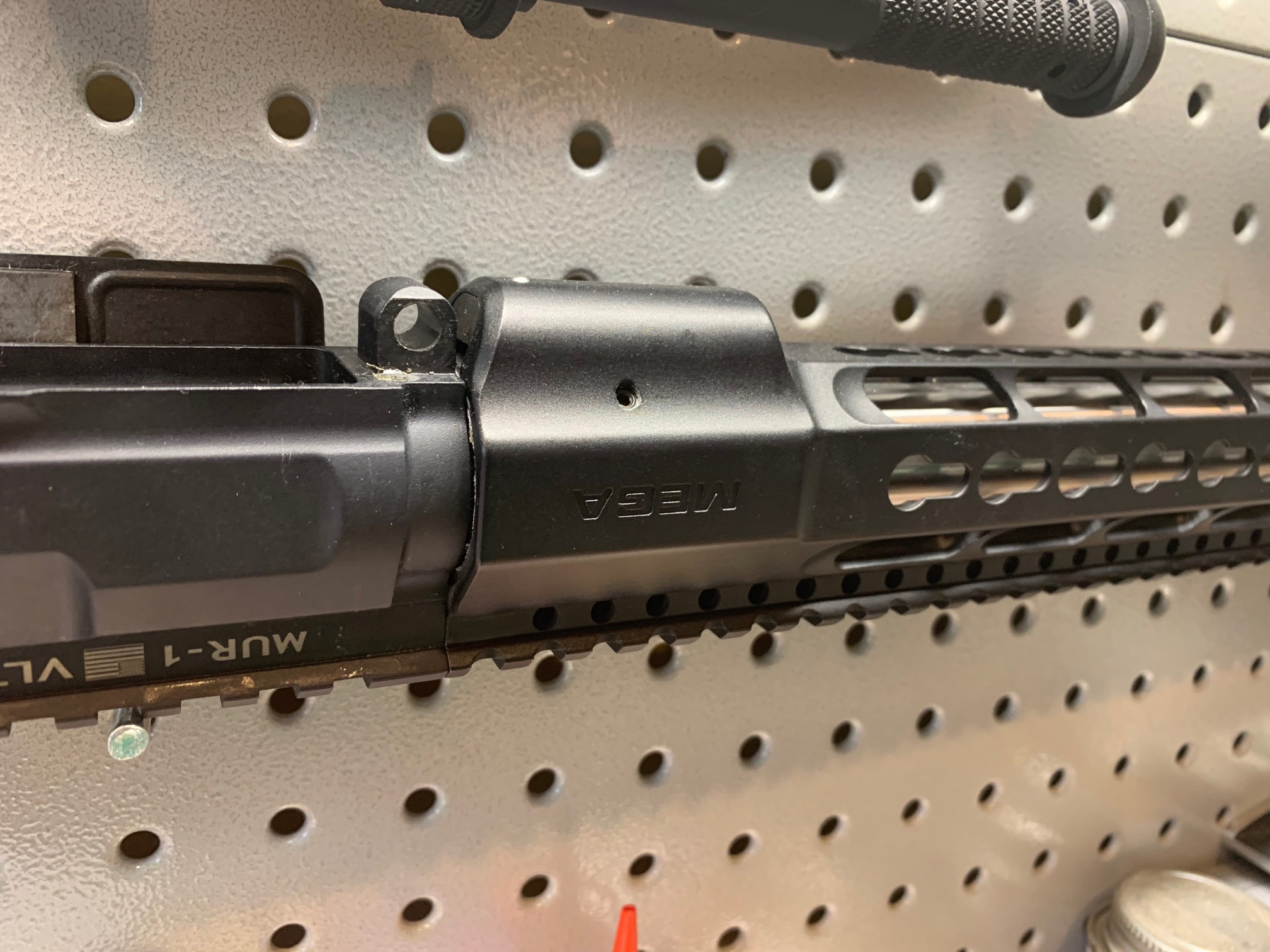

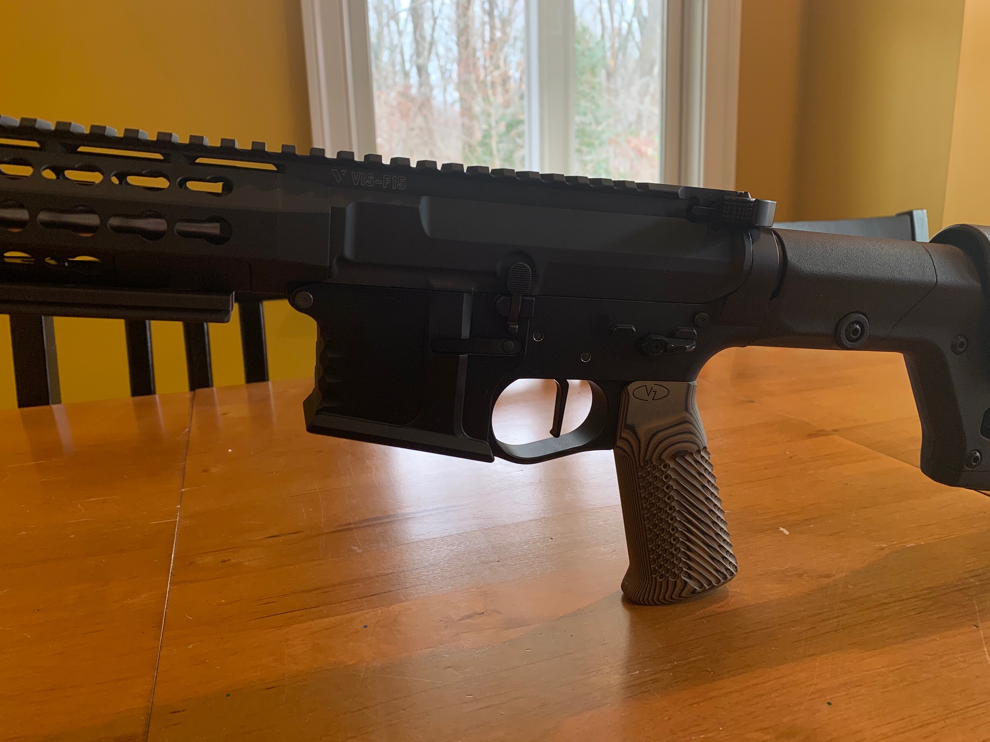

    It's Monolithic VLTOR fusion on a 6 ARC I'm building.
    The other rail is a Mega 7075 on a 20" 223W proof steel barreled DMR. I could sell that one but it is a really nice rigid rail.
    Just seems crazy to me that no one sells quality hardware aside from the proprietary stuff that comes with their own mounts.

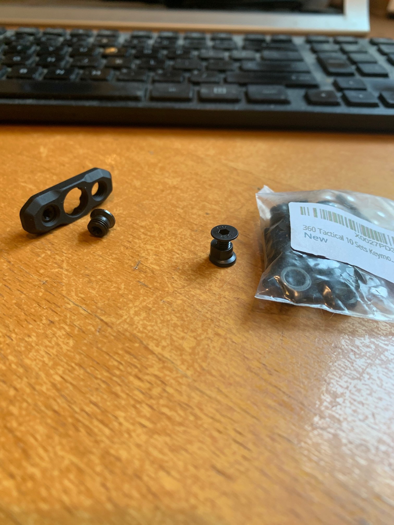

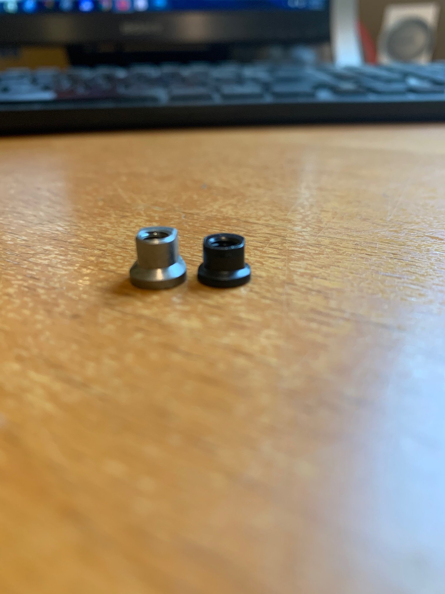

    Arisaka is great, I have no complaints. Their Key-Mod hardware is inverted. It's a great design that's proprietary and not for sale separately.
    Pictured below is Arisaka next to Amazon key - mod nut.
    My frustration is trying to mount quality parts that do not come with hardware such as an Arca Rail and rail weights.
    Even the AI Key-Mod rail weights (out of stock) use a proprietary fastener & AI does not sell Key- Mod fasteners.
    Below is a picture of the Area 419 Key-Mod nut (presumably BCM) that came with the 419 Key-Mod Arca rail. That nut is 8-32 and in spec. Next to it is the Chinese Amazon nut. Clearly the Chinese nut (Metric) is out of spec. Doesn't fit the rail worth a shit. And no, Area 419 does not sell just the Key-Mod hardware.
    BTW the 419 rail doesn't fit the Mega rail. I'm going to have to machine the key-mod locators.
    Why can't I just buy in spec nuts anywhere?
    Fuck Key-Mod!

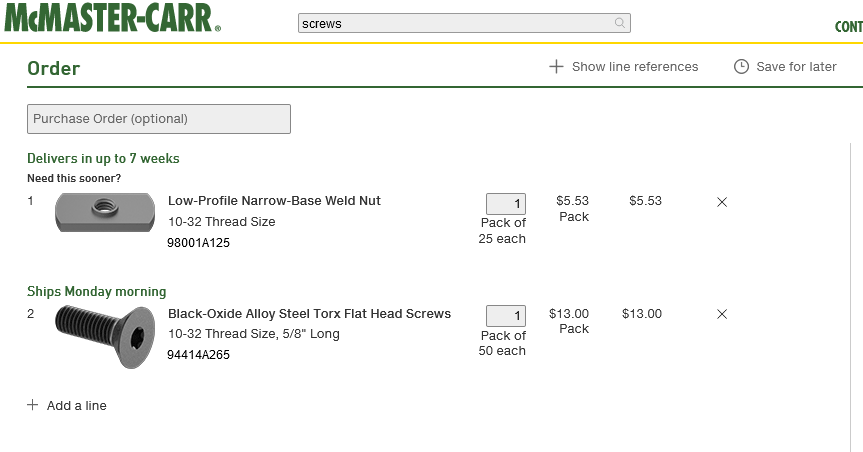

    I solved the first hurdle mounting a heavy Arca rail using leftover KRG hardware. Flat head weld nuts lay perfectly in the rail and the nub centered it in the slot. Problem is now I'm out & have nothing to mount weights with. 7 week lead time from Mcmaster............. Fuck!

    Have you tried Grainger or MSC?
    I'll give them a shot & maybe Fastenal.

    Oof, Mega and VLTOR, a man of fine taste 👌🏻
    I’m very close with the Arisaka guys and even do some peripheral design tasks and admin work for them.
    Last I remember discussing this issue, the nuts you have pictured above are manufactured by BCM and were updated to the captured design because of people losing the nuts after backing the screw off too far. As far as install goes, I think the captured Keymod nut update is easier and more foolproof than more prolific alternatives, but we know where the cards ended up falling with the RTZ and strength testing on the .mil side.
    Shoot me a DM with your shipping info and I’ll see if I can lay hands on some of the old hardware in my own Annex stash of development parts and if I don’t I’ll see if Arisaka can help. Let me know how many you need, I can’t promise anything but I’ll give it my best when I’m back from SHOT.

    Damn, that Mega Wedgelock is gold, I'd pay well over what used to be MSRP for it if it wasnt keymod.

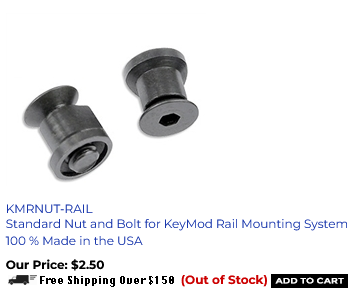

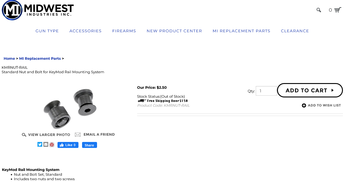

    Well son of bitch. Thank you.
    I'd looked at those but on the product page it made no claims as to origin so I assumed it was repackaged Chinese crap.
    On the link you posted it clearly states 100% Made in USA. Also Sadly out of stock. I went ahead and ordered a dozen along with some M-Lock hardware.
    Also I found the double tab 10-32 weld nuts in small qty's in stock in Michigan at JHP fasteners so I ordered them in both SS & Carbon steel.
