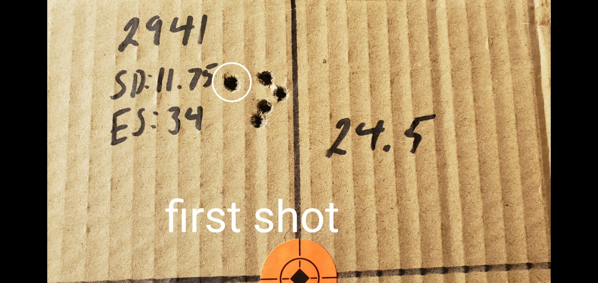

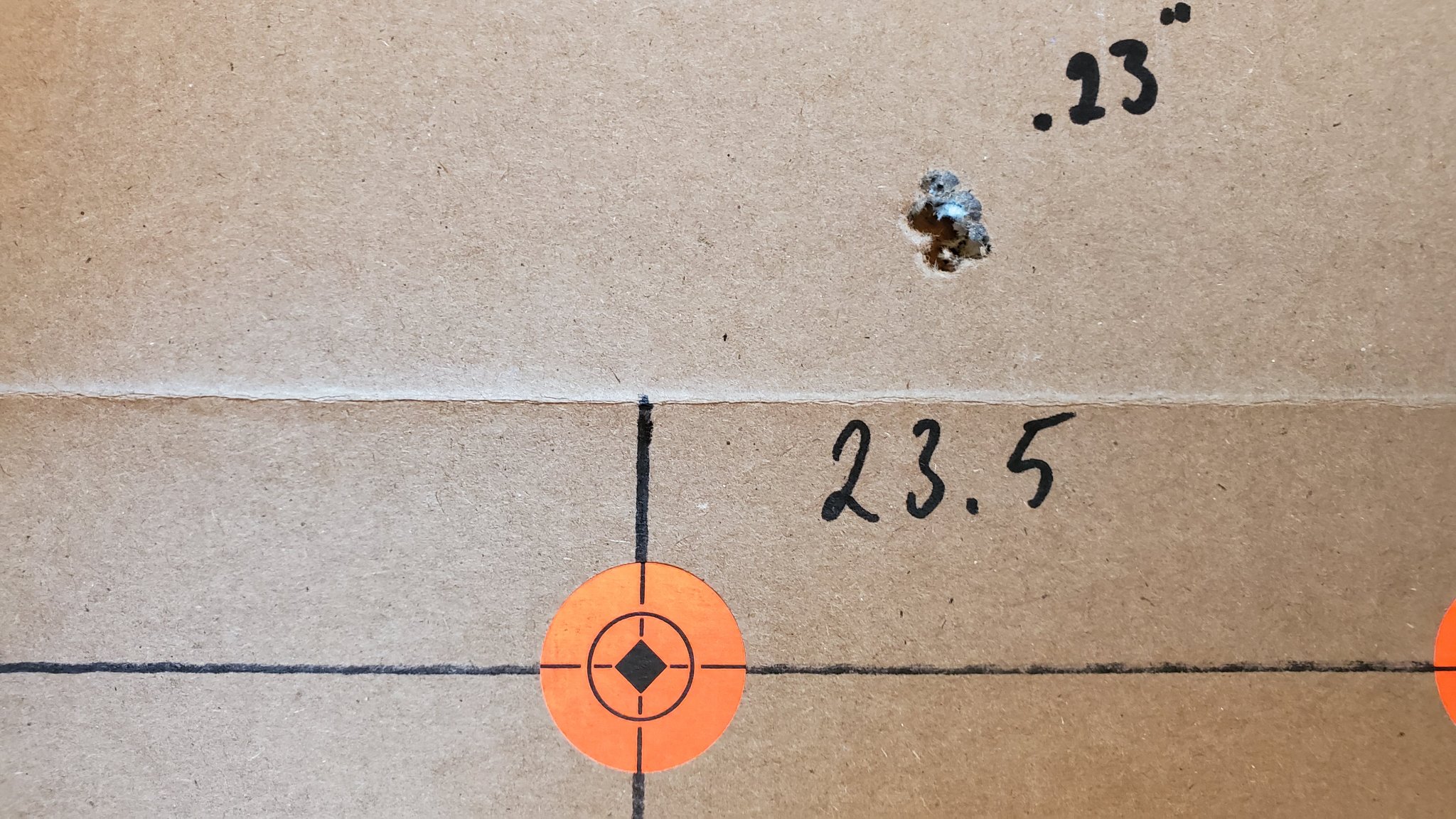

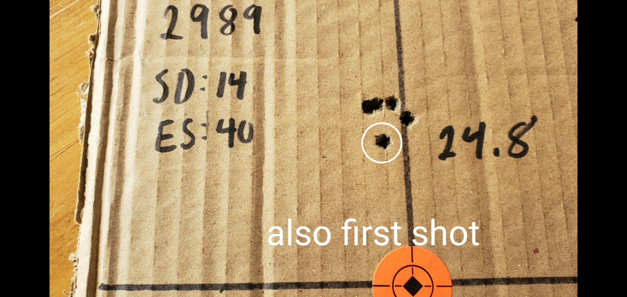

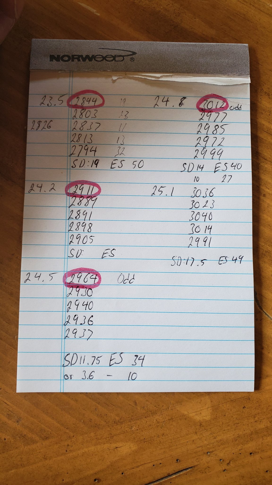

I noticed a trend in my load development today.
I'm shooting a bolt gun 224 valkyrie and I'm loading 80gr eldms with H4895.
On 4 of the 5, 5 shot strings the first round has the highest velocity of the group and it throws my ES/SD off.
Is this just coincidence or is this common? I am using an F1 chrony so take that into consideration. Although SD/ES are correlating with group size and numbers seem realistic for the given charge.
