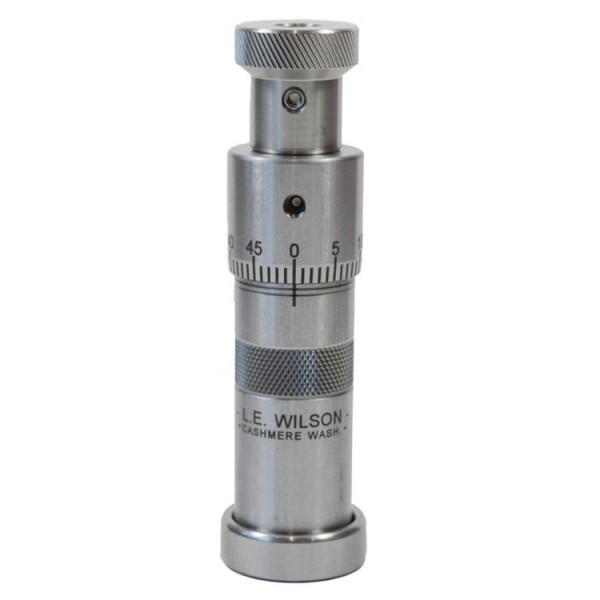

Yes. It matters. Sometimes.
I switched to LE WIlson bullet seating chamber dies, and am now always within 1/1000th of an inch concentricity.

My concentricity gauge says otherwise. All the other dies I have tried Leave me 3 to 5 thousands out or even a little more. These Wilson dies get it spot on every time.

My only point about Wilson bullet seaters is that they get concentricity dead on.
