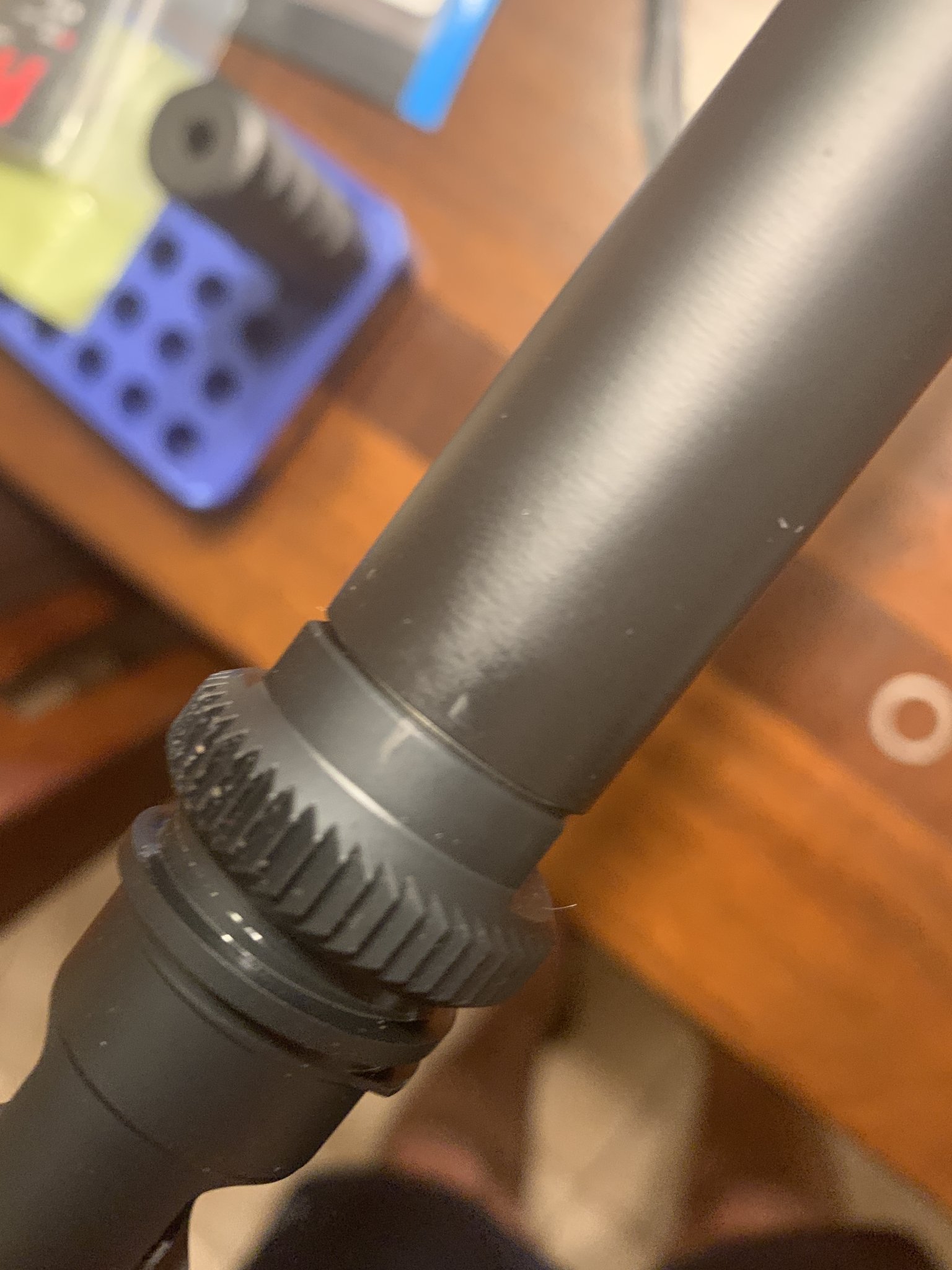

See pic for amount of timing it is off. I can’t find a combination of shims that get it closer, and this is with two packs. Note the pencil marks.
Just wondering if this has any appreciable effect on accuracy. For what it’s worth, it is an MPA Switch lug in 6.5 creedmoor.

You can try sanding a shim on a sharpening stone, or see if adding a few more will turn it out to be lined up better.
I had a similar situation and wound up making a paper shim. It timed the brake perfectly. I'm not saying I recommend it, but I tried it and it worked on that particular application......
I was able to get it by just torquing it a bit more than usual. I usually use about 5 ft pounds (basically hand tight) to keep the effect on the muzzle as little as possible but nudged it up to 10 and it got it just right. I’m hoping with 5/8x24 threads 10ft lbs shouldn’t have too much of an effect on accuracy.
