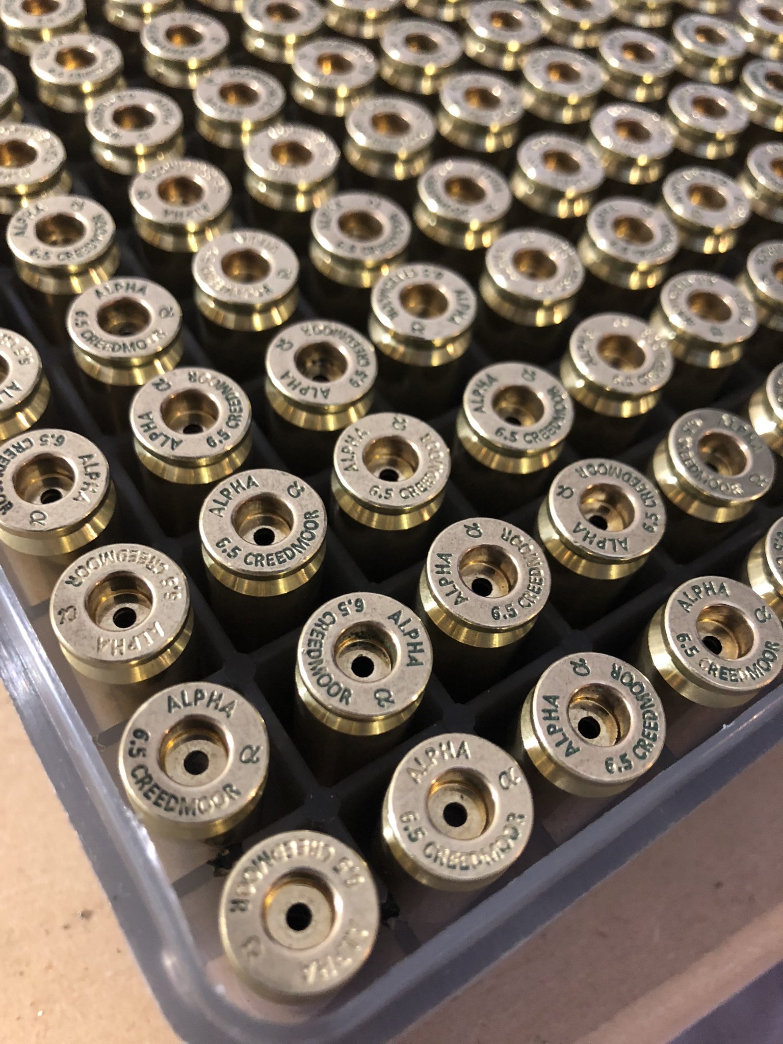

Curious is you guys's media does this to your brass. Its not that huge of a deal but I just don't like the way it makes my clean brass look.

Ah, I dont know about new brass but I can say all my fired brass looks like that.
What media are you using? If cob etc throw some dryer sheets in to collect the dust. I assume thats all it is.
Your brass will shoot just fine though.

Ill give the dryer sheets a shot. I knew it wouldn't affect shooting it was really just killing my OCD ?

I've been using the same RCBS green walnut shit for probably 15 years and it doesn't do that to my brass. I just drop a few lumps of wheel polish in once in a while while it's running and it cleans primer pockets well enough and leaves the brass looking beautiful and a little protected. Never had a residue in the head stamps.

Either your media is hopelessly dirty and needs to be changed or you need to try the dryer sheets.

To the OP; I think the dryer sheet will cure the crud in your letters. If not, try some new media. Depending on the number of cases that you tumble one of those gun cleaning "tooth brushes" should clean them up.

Even when my walnut media gets filthy dirty, I have never had the markings look like that. Originally I used Nufinish polish, now just a little bit of mineral spirits. Never had any thing like that.
Color fill, it's all the rage now. But seriously, what is in your media that causes that? I even used walnut with red rouge polish and never gotten that.
I use walnut, nufinish and mineral spirits mixed and toss in a used dryer sheet.
