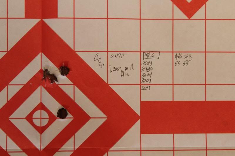

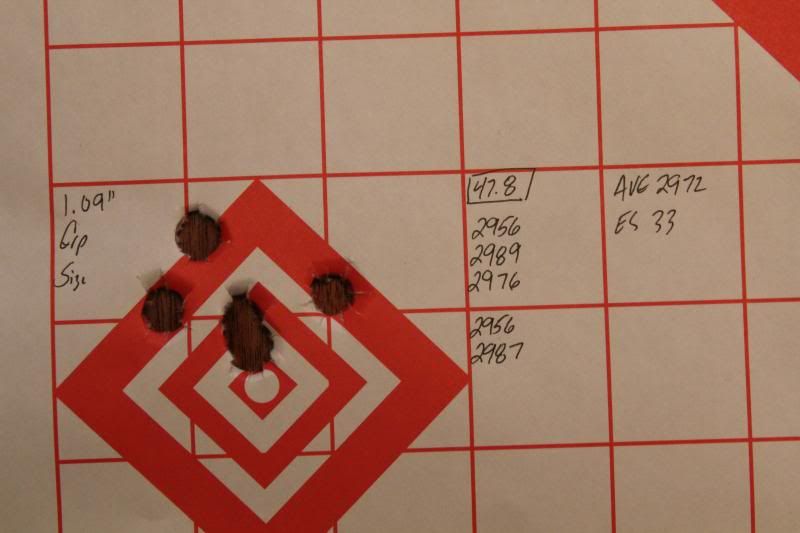

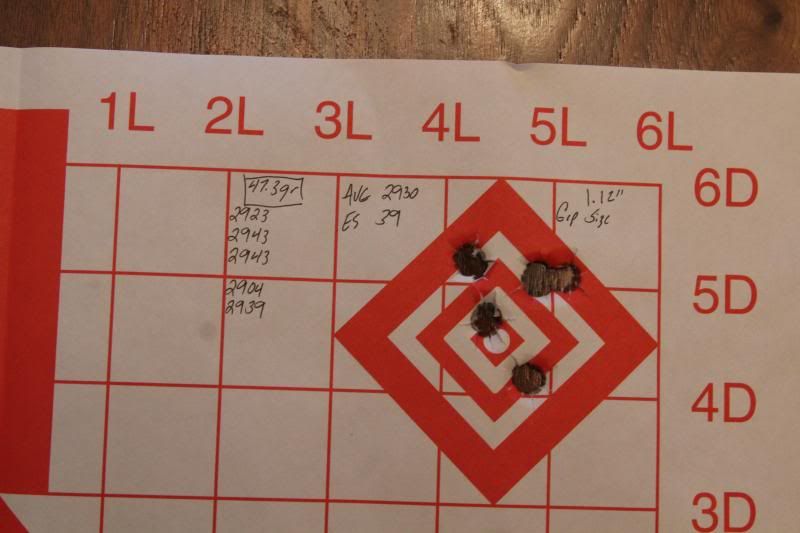

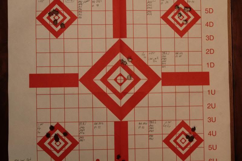

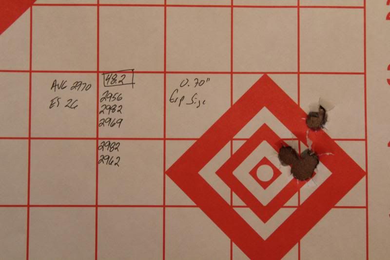

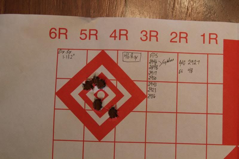

So here is my OCW test that I did with my .308. I don't know what to look for to be honest. Overall I was disappointed with the group size, but the velocities were pretty awesome IMO. I was shooting the 155gr Scenars here. I already have a pretty good load with the 175SMKs but wanted to see if the Lapuas shot any better. If I develop the load further I may play with the seating depth some to tweet it. These were all loaded 10 thou off the lands. The chrono numbers were with my Pro Chrono, which I have modest faith in at best. The charge weights all are highlighted with a square around them. Any input would be greatly appreciated.

Shooting for LR? Look for vertical, looks like bottom right, but if you wanna good 155 load try 46g Varget, and work up. I found a node around 47.5 if I remember correct. Sorry can't read any data at all. I imagine these are all shot at 200yd?
Also Scenars aren't sensitive to jump, so you can load them to 2.800-2.810, and stay with the same oal. too many variables going on here.
I should have mentioned that this test was shot at 100yds. The groups sizes are all around 1". Not what I was hoping to see.
Everything looks good there,lol. Don't know your builder, but I'd say you need to tweak your load. It should be printing 1 ragged hole with factory FGMM 168 & 175g. Get a box of that, good rest, and shoot it and post pics. Most 08's I've owned run Varget and H4895 very good. But there are many powders for the 308 case that will work. Make sure everything is torqued to specs, and put some Fed match through it. Also it's a brand new rifle so shoot the heck out of it. I'd actually buy 100 FGMM in both weights, and after having fun shooting. I've had a rig or 2 that drove me crazy at first, but after the tube started getting broken in, vel increased, and so did accuracy. Sounds like a nice stick, if you wanna just send it to me, and I'll break in in over the Spring n Summer, lol. It will come around, and you'll be smiling.
By the way, .10 off lands? Back those suckers back into the case a bit more, and see what happens. Try 2.810" OAL and show groups. Like I said, scanars are similar to SMK's and sometimes like to be jumped more.

It would help if you wrote what group is what here... Its impossible to read the small text through the blurry image.
Also, vertical does not matter regardless of whether your going LR or not. This is an OCW test, groups,vertical and horizontal don't matter. If your just trying to test a bunch of weights and see which shoots best, thats fine, but then its not OCW.
I only work loads up at 200yds. 100 just won't show you any signs of what the bullet is gonna do at distance. At 300, wind comes into play, and that's no good for load development. If I get signs of vertical at 200, and I'm on a good solid rest I won't choose that load, but if it's some horizontal... It can be wind. I don't do as much OCW load dev. as running a OCW/Ladder test. My first Smith taught me this process years ago when I was in the BR game, and it wasn't as fun when shooting for Sponsorship,$, etc. Now that I'm loading and Hunting game from far away, I still use the same process. A little vertical at 2/300 is a missed target at 1k-1300yds.

The 48.2 load looks promising, but please don't load those scenars that far out. Load 3 ea .20/.30.40" off the lands and see what happens. That's just 9 rds, and I'm a believer in 3 shot groups. YES 5 is better, but 10 is better than 5. The only problem I have with 3 shot groups, is it makes everybody's gun a qrtr min gun,lol. It will only get better from here.
