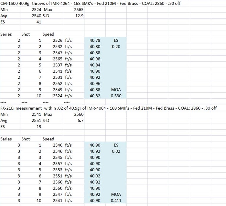

Here's a comparison I did for my ChargeMaster 1500 with a very accurate scale, the FX-210i. My CM would read 40.9 grs, which was the target charge that has been a verily accurate load in my gun, but the FX had enough resolution to show something significantly different (the FX weights shown in the blue shaded area). Then you can see the difference in chrono data (as taken from a Magnetospeed v3) as well as some difference on paper in terms of MOA:
Hmmmm??? Unless your beam scale is something like the Prometheus ;) I don't think a manual beam scale is going to have enough resolution to tell you much in that comparison with your CM Lite.
Your FX does not measure within .02gr
Your FX measures within .08gr if you were to compare it to a better scale.

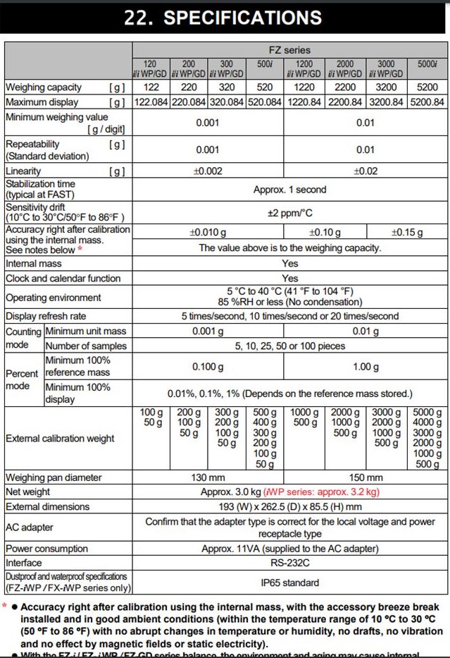

Yeah, I know it's not within .02gr. Based on the spec sheet, I figured it to be more like +/- .03gr . . . saying within .06 gr if you will.

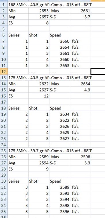

I never had any difficulties getting 6-7SD’s or better for 10-20 shots with my Hornandy and the RCBS is definitely a bit better scale than the Hornandy.
My old 5-0-5 easily resolves individual grains of H4350 like my FX-120 does and I Didn’t see any major improvement in SD since I started running the V3 setup.
But it’s so much faster and quicker to get set up.
