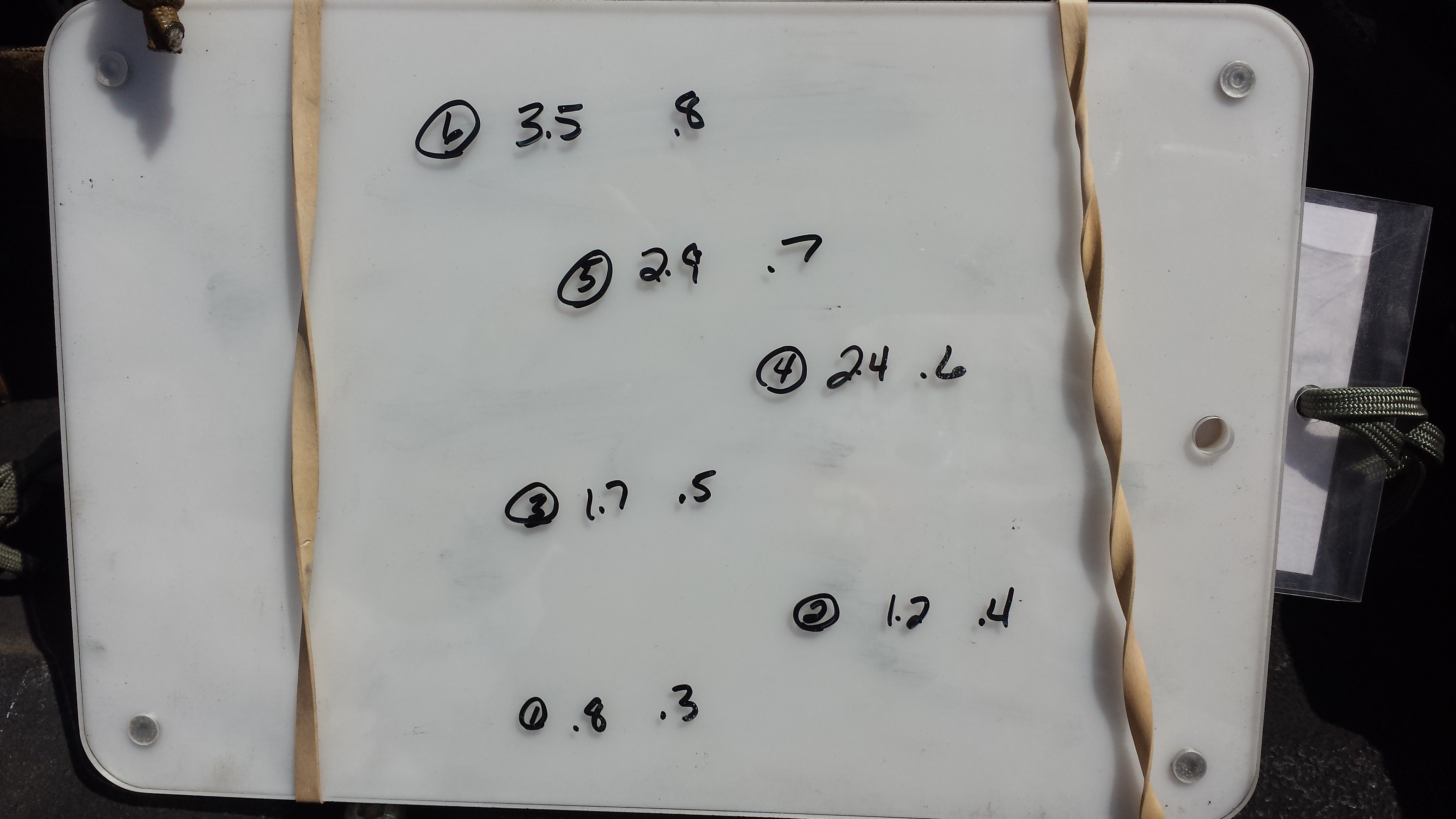

At the Steel Safari in Logan NM a few weeks ago a fellow shooter handed me a replacement dope board/white board/range card thingie.
I have been using a white board for a few years to write down target locations and distances. For me it is easier than a wrist band.
Member Tim K makes these on a CNC machine and uses magnets to hold the clear top on the white bottom.
I tape a dope card on the bottom and have a pie wedge shooting area with a 500 yard line on the bottom part. I mainly use my data card hanging off the side of my rifle, but having a back-up right where the target ranges and locations are is nice.
The clear top piece is where is write down ranges and other info I might need to complete a stage.
It weighs about 10-12 ounces and fits perfectly in a cargo pocket or outer pouch on most packs. My old ones were too big and didn’t weigh much at all. Often a breeze of more than 10-15 MPH and it would take-off.
Ray from Thunderbeast was running around telling everyone how cool they were. I think Tim gave away the dozen or so he bought in a matter of minutes...
Very impressed. A better mousetrap for sure.

I got to check these out at the Steel Safari a few weeks ago and was jealous, put my wristband to to shame. Really would have been to useful on the bigger stages, when I kept forgeting which targets were at which distances :(
Another great invention from TimK, I'll be sporting one of these soon!
I've used something like this for years for different purposes. Why I never made the smaller version and used it for shooting just proves that Tim K is a craftier individual than I.
I've been using one of the prototype versions for a while now too. Some may have seen me with it at the sniper's hide cup this year. Its a straight forward and simple solution for complex stages. Or in the case of shc. I used my pre shoot time to map out all 4 stages on the board to take away some of that clock pressure.
Works great with dry erase or wet erase, markers or a grease pencil. I use the wet erase when its dry out and a grease pencil if there's precipitation involved that day.
Works well, simple, and doesn't go anywhere in the wind.
I RO'd Hoser and really like the board he was using. Later in the match I RO's Tim. I mentioned how much I liked his board and asked where he got it. He said he made it and handed me his. I like it way better than the armband game. Heavy enough for the wind not to blow it around. Perfect for long range matches.

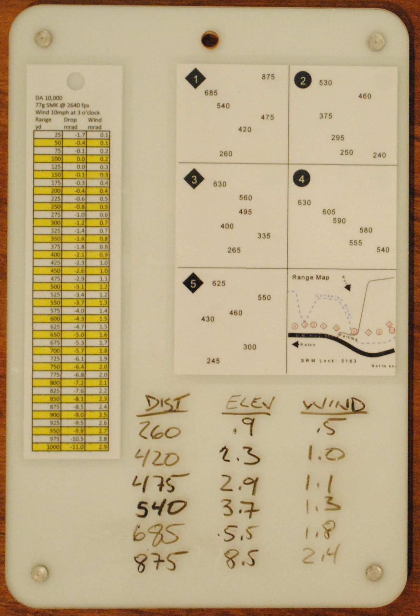

I finally got to shoot a match with one of these dope boards. I used it at a sporting rifle match in NM. I guess I saw 10 or so guys using one while I was there.
Here's a photo of it from the match:
Breakdown:
• My dope card is on the left hand side of the board. It's under the top piece of clear acrylic.
• The match course is on the upper right, annotating the target array and ranges.
• Given that we had known target distances, when I rolled up to the stage (in the picture, it's doped for Stage 1), I immediately figured out my elevation and wind for each target from my card and wrote it down on top of the clear acrylic with a dry erase pen.
• It took less than a minute to set up for each stage.
• I set the board up next to me as I was shooting each stage. A quick glance at the board gave me a heads-up display for each target; including relative position, distance, elevation, and wind.
• It was easy after that. Shoot, glance, dope, repeat.
Here's a look at how it could be used for not-previously known targets:
Breakdown:
• Dope card is at the top of the board, under the clear acrylic.
• The targeting "V" and ranging yardage are drawn on the white acrylic with a grease pen.
• Once a target is identified and ranged, quickly mark it with a dry erase pen on the clear acrylic with the target array.
• Jot down the elevation and wind from the dope card.
• Repeat for each target.
• Set the board up at your shooting position, and use it to quickly have the relative position, distance, elevation, and wind of each target.
Honestly, I am impressed at just how handy this thing is. I'll keep using it for sure.
