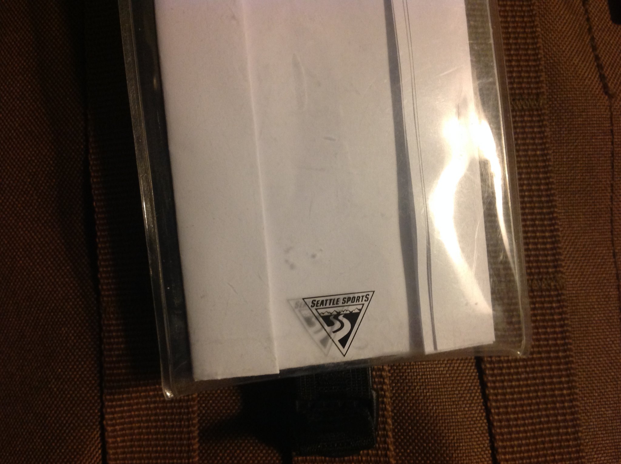

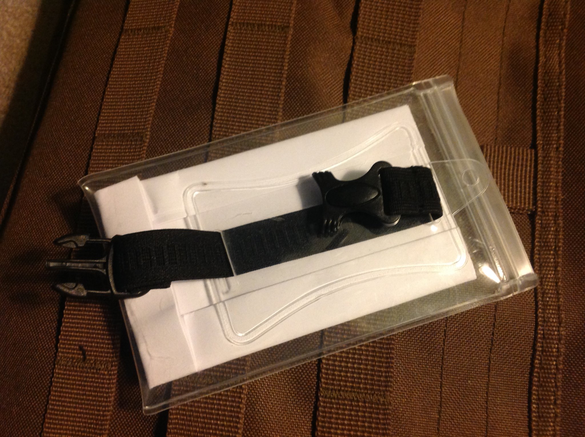

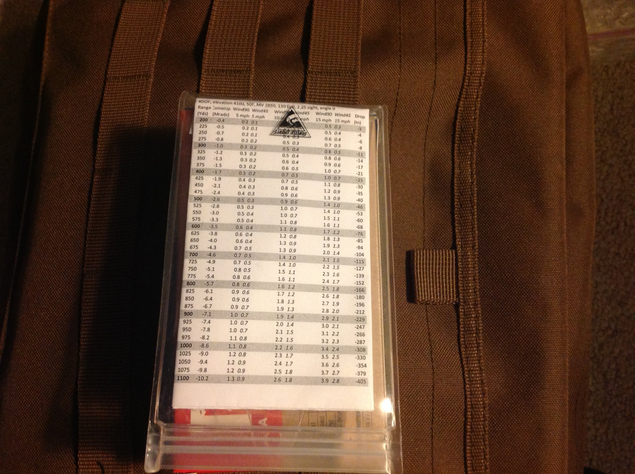

I found a plastic sleeve intended to protect a cell phone to be pretty handy. 10 bucks at REI, made by Seattle Sports. This is the iPhone 5 model, which is just right for a 3x5" card, or in my case, a folded up piece of paper that I printed out. Size is similar to a box of ammo, and there is an elastic band on the back you can use to clip on wrist or equipment to keep from blowing away. Best part is just hitting print to make an updated version.
Love it! Way to think outside the box! I'm usually too lazy to do what you did and pay whatever to accomplish a simple task, not to mention not creative enough! :) Thanks.

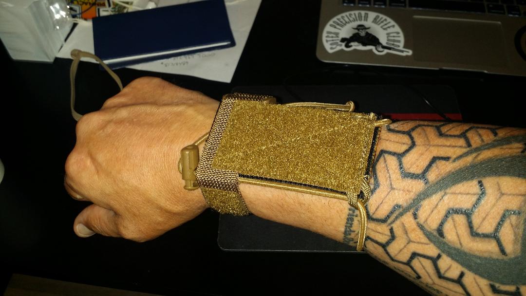

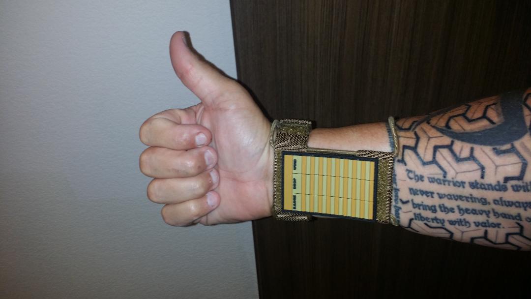

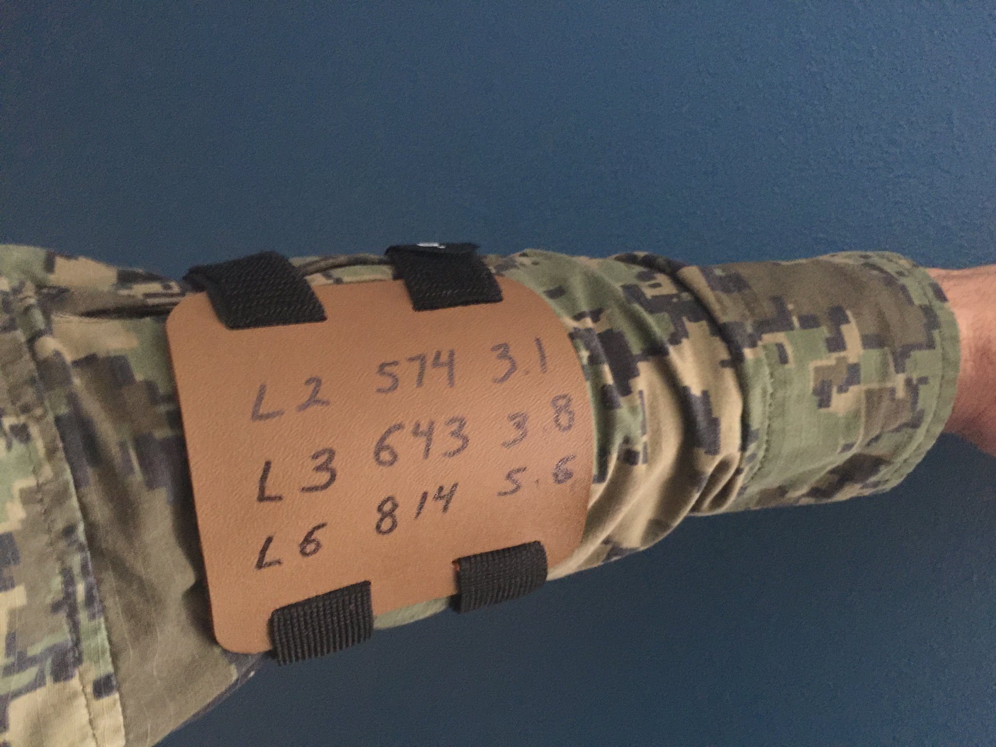

I recently ordered a "Gen 2" wrist board from Sunrise Tactical. Shipping was very quick and I've been able to use it a little so far. I really like it, especially the 3 shock cords to attach to your arm. Each one is tightened differently to adjust to the taper of your forearm. It doesn't move around at all. I usually just run just one card, but you have to ability to open it up and have a second (or third if you use the inside of the top flap). My solution is to write dope on a pocket size tan Rite-In-The-Rain notebook then tear the page out and slide it in the wrist board.

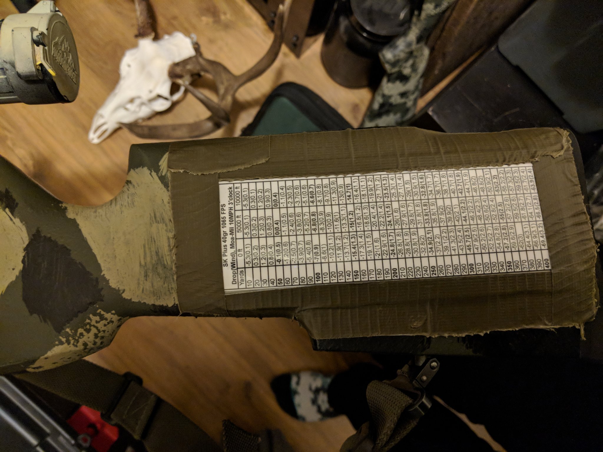

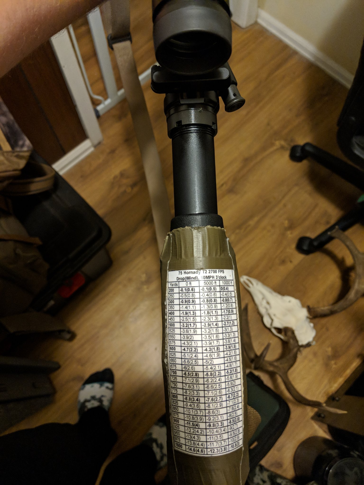

Laminated on the top front of the buttstock and occasionally on the scope tube when there's not much and it's small.

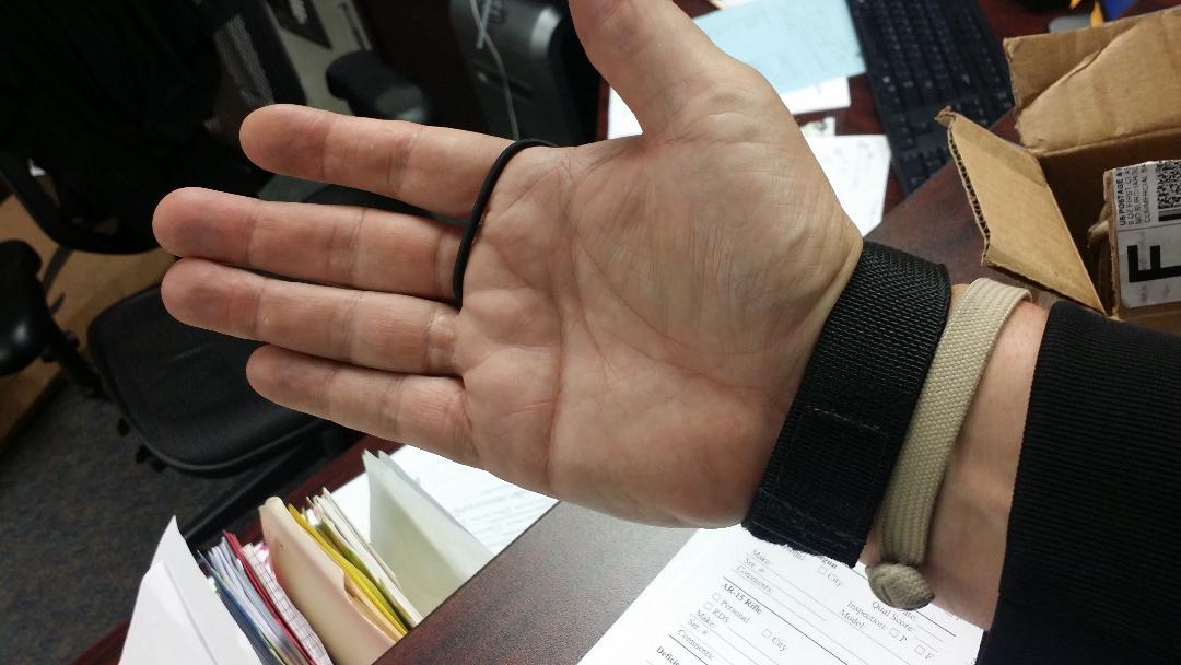

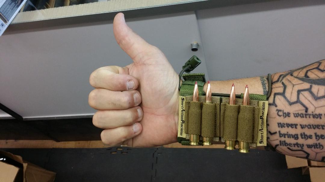

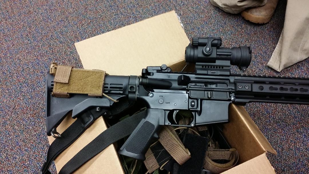

This is the HDC Gear Handy referred to above. I've personally never had good luck with wrist coaches. I've never needed that much info to fill up a wrist coach. That being said I don't go on 3 day patrols or extended sniper missions. I believe that this is the best competition data holder and patrol holder ever made.

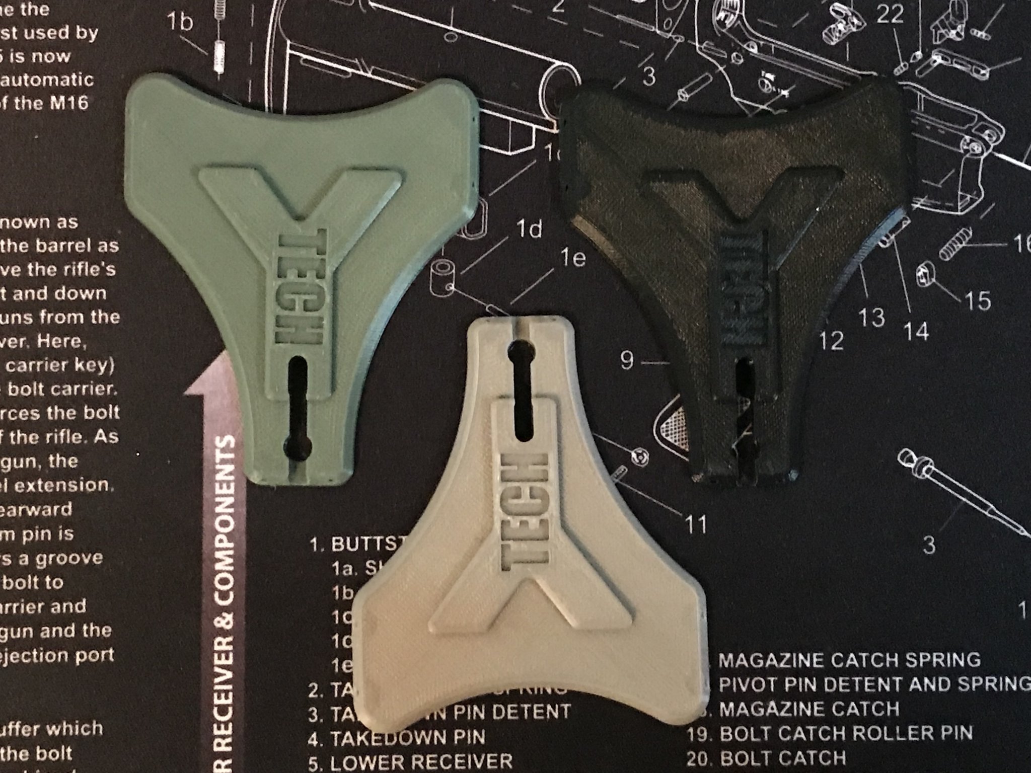

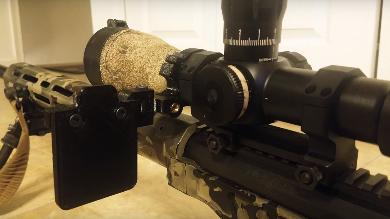

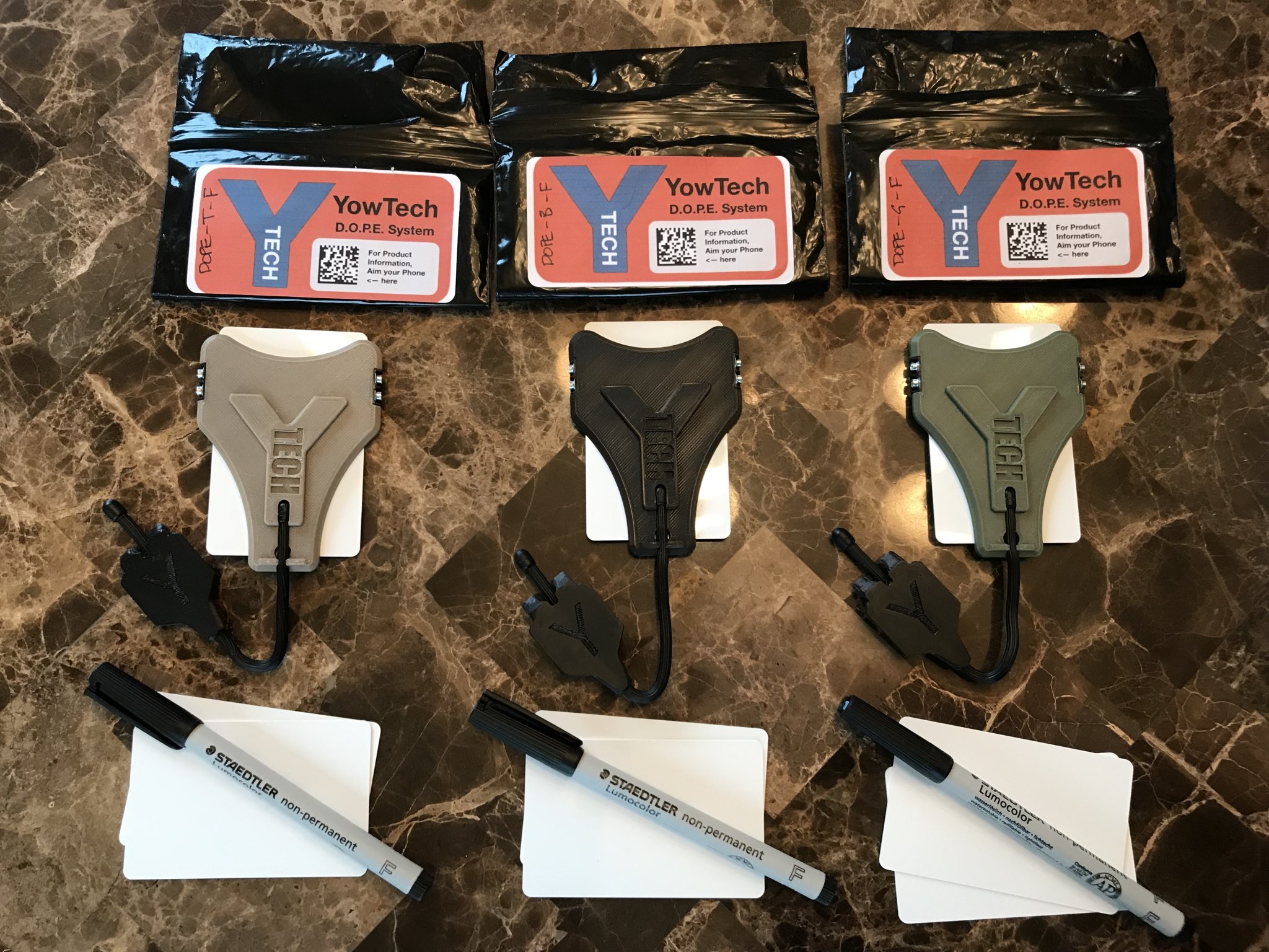

I just stated to sell this solution. It attaches with zero tools to an "in specification" picatinny rail. The cards are easily pulled out and will not fall out. I have three different colors and two different pen options on my website. I also have demo movie showing how it works
www.Yow-Tech.com
Let me know if you have any questions.

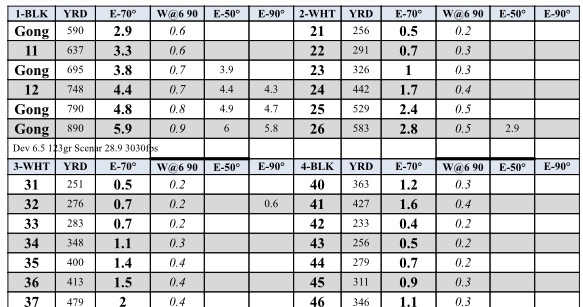

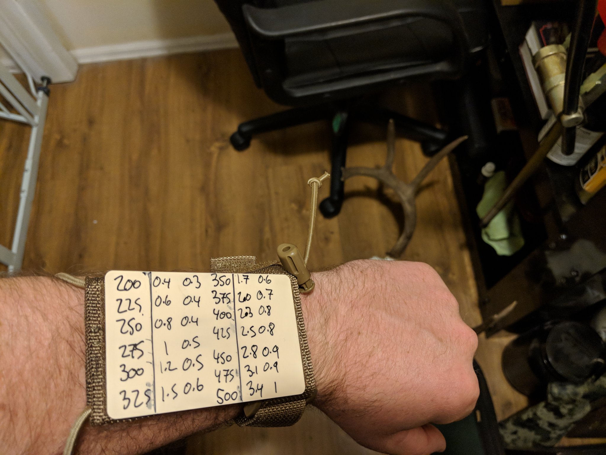

I keep something like this in the base page of my base wrist coach, but run the stages in the first flap-
the card shown 2-3/4x4-1/2 gives me a large temp swing to work with. In this case 50 degrees- I only list the changes from the main temp I expect to shoot.
Stage page— prePrintrd if the book is provided before the match - otherwise I leave the info blank/ I fold it over so I get more stages when flipped open on the back side. (Note the two cards are not from the same shooting area. The generic drop chart is from today at 23inHg)
But I also use a sidewinder if it’s really hot or cold
Reactions: seansmd and TACC

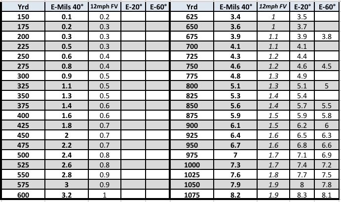

@Apnea Did you use an app to generate your dope card or set it up in an Excel type spreadsheet ?
Sorry @CaptNemo, I never noticed replies to this posting. I used Hornady 4DOF and downloaded the file. After that I took what I wanted in Excel and formatted to fit the size I wanted. You could run a few different sets of environmentals and print and then pick one closest to your current situation. Since it is just a sheet of paper you can easily write updates on it before the match starts.
@Diver160651 is there a reason you go by temp instead of DA? I've though about using DA since it takes temperature into account, but perhaps there's something I'm not thinking of.
Yes, Station is super consistent day to day at given location, temp is not.
Wind and optical issues aside, temp is by far the biggest factor in DA and easiest to account for with the fewest tools.
The net result is that it simply is faster and easier to adjust even just using your head

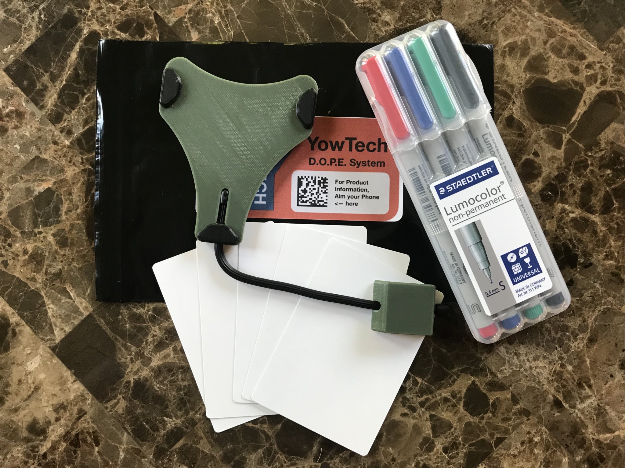

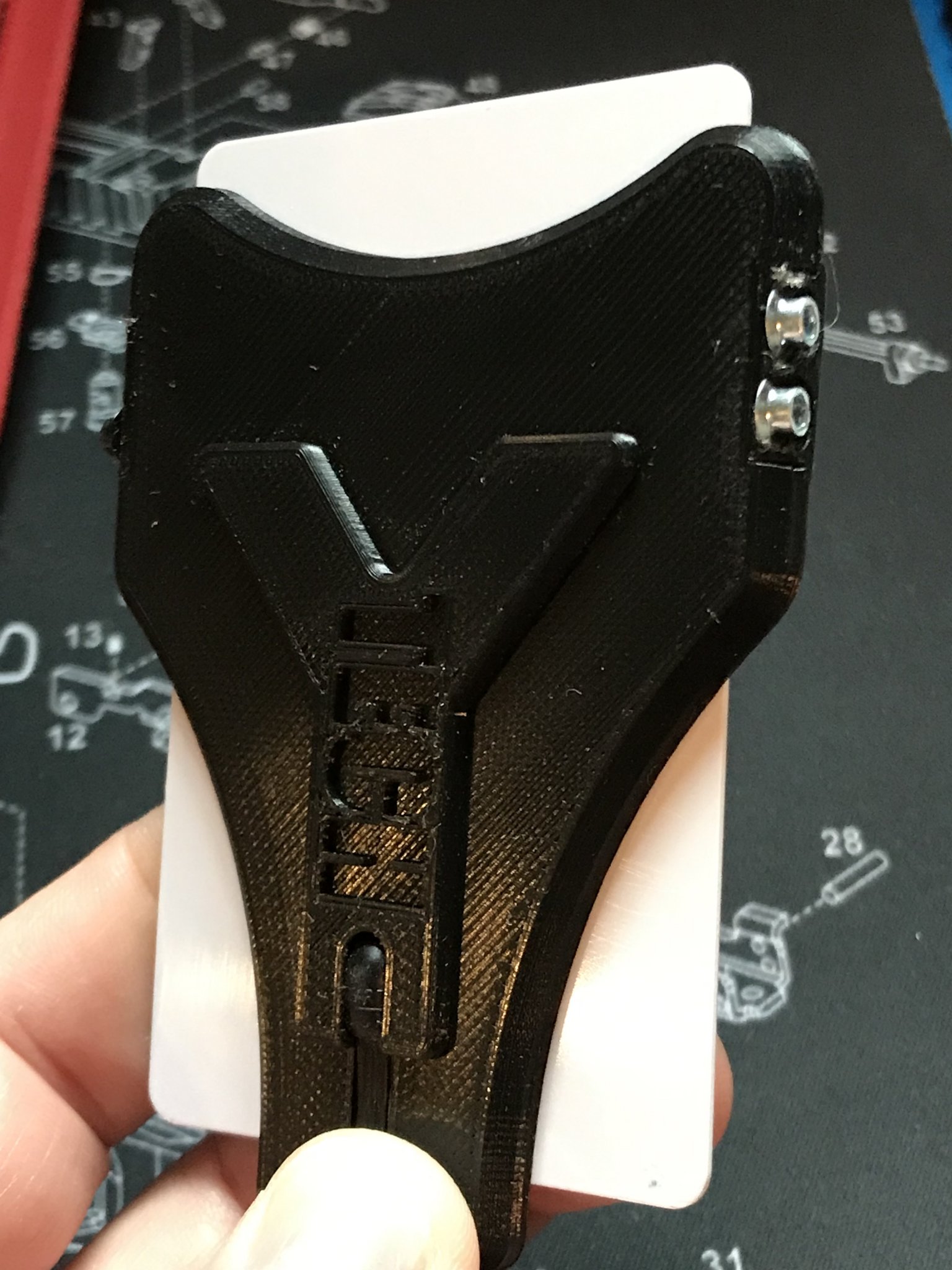

After lots of feedback on the Yow-Tech DOPE card holder we made 4 big changes.
First, The card size and card type has been changed. Based on feedback from national shooters we redesigned the holder to accommodate a more robust card that is as thick as a credit card.
Second we changed the way the holder is assembled. We now use screws vs. glue to build a very strong product.
Third, we once again changed the rail clamp material to an even stronger and less brittle Carbon fiber filled resin that can survive the heat without deformation.
Forth, we changed the pen to correctable version with an intergraded eraser.
www.Yow-Tech.com

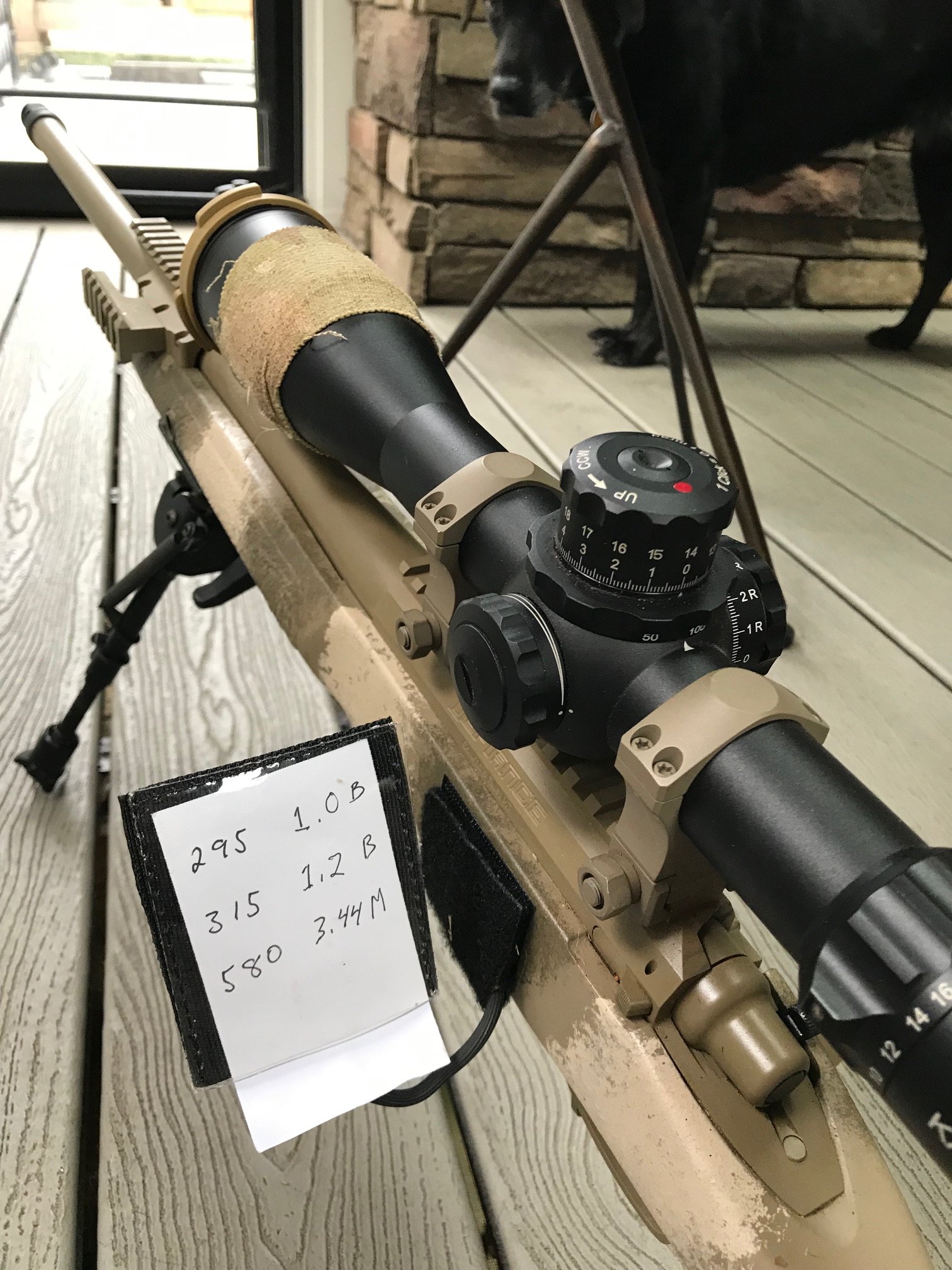

Tape on, as well as the handy. Custom cards for the handy are easy to make, swap every 2,000 foot DA.

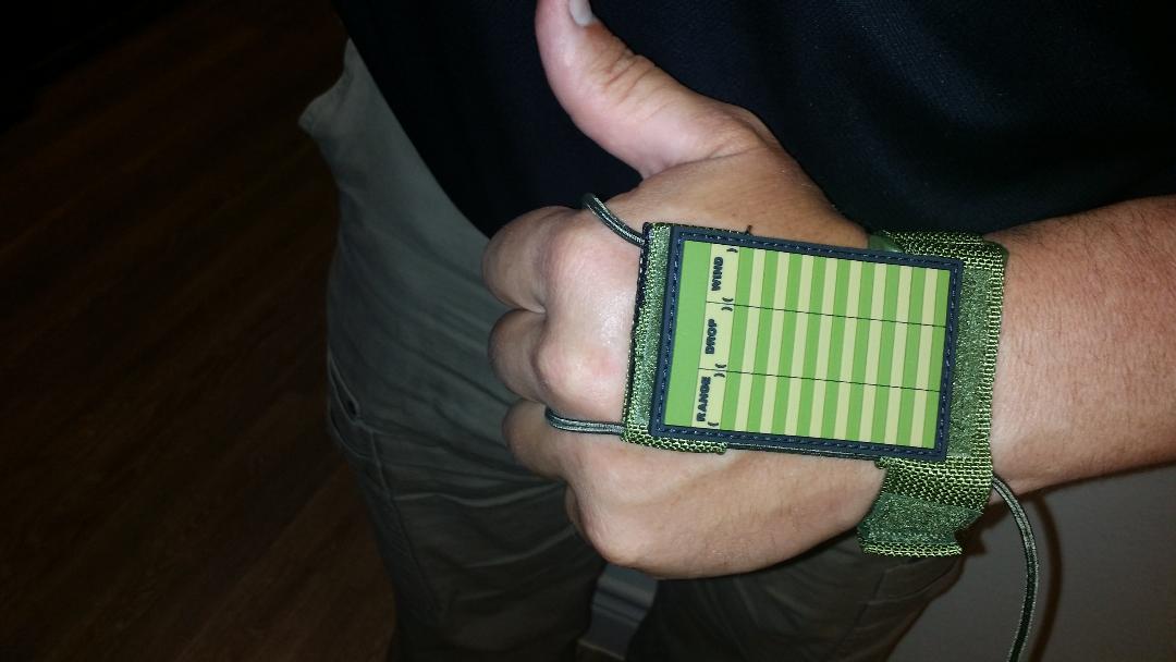

Football wrist coach. They're made of moisture wicking material generally so I don't find sweat an issue. I like the wrist coach because it doesn't stick out at all and it's generally easy to read. The rifle mounted ones I have bumped on barricades because they stick out. 3x5 recipe cards fit perfectly in them and will stay out of the rain. I generally write dope for 2-3 stages on one card.

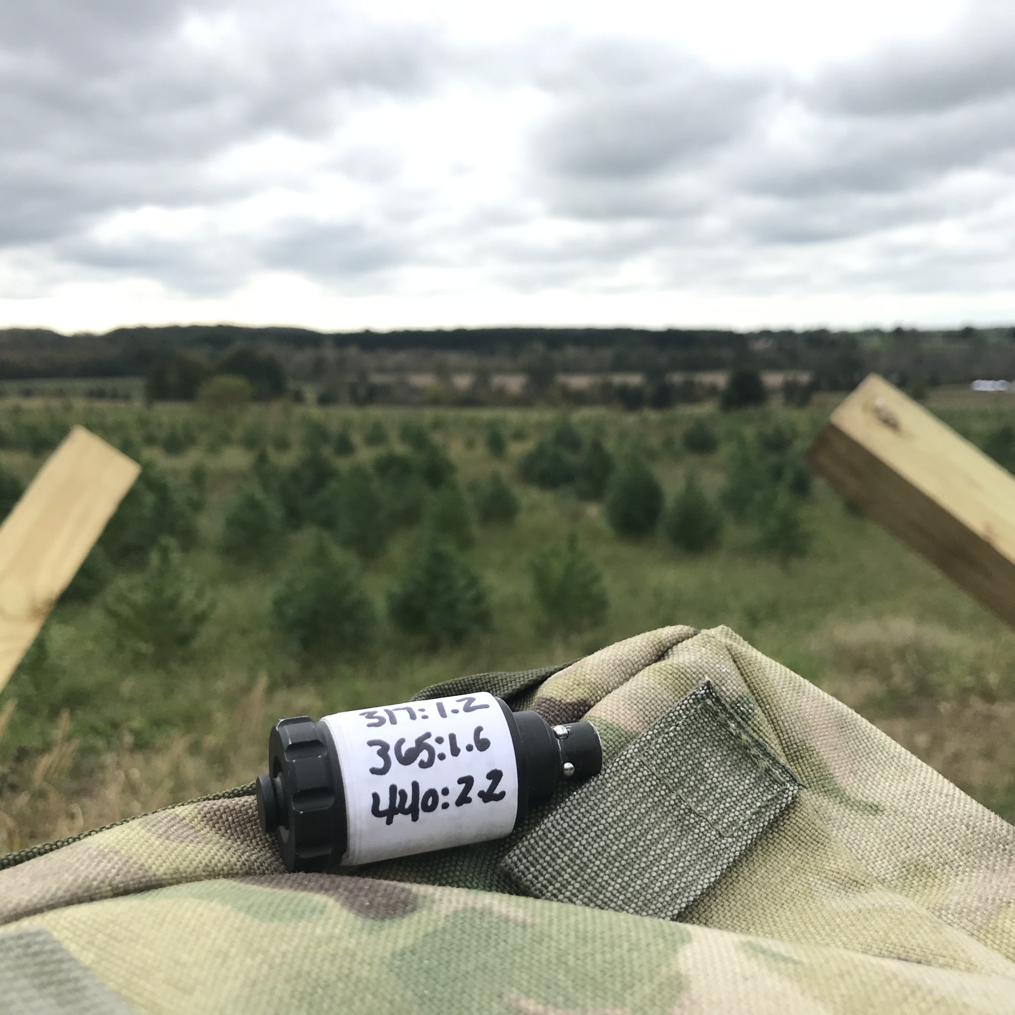

I took a photo with the DOPE Roller in its natural surroundings at a match earlier this fall. Please note the lovely surrounding foliage :giggle:
