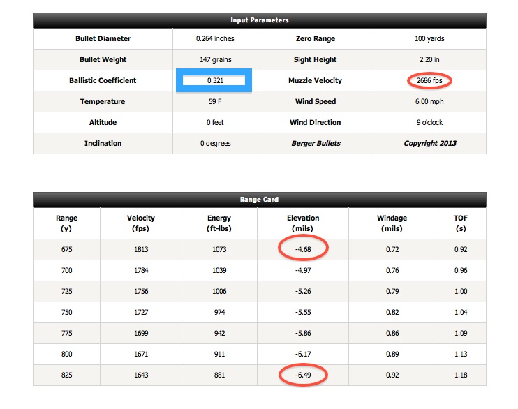

Here is some minor tweaks and run thru web version of Berger Ballistics...
[Estimated] 685= 4,4 (actual 4,7 -> 0.3∆)
[Estimated] 810= 5,8 (actual 6,5-> 0.7∆)
