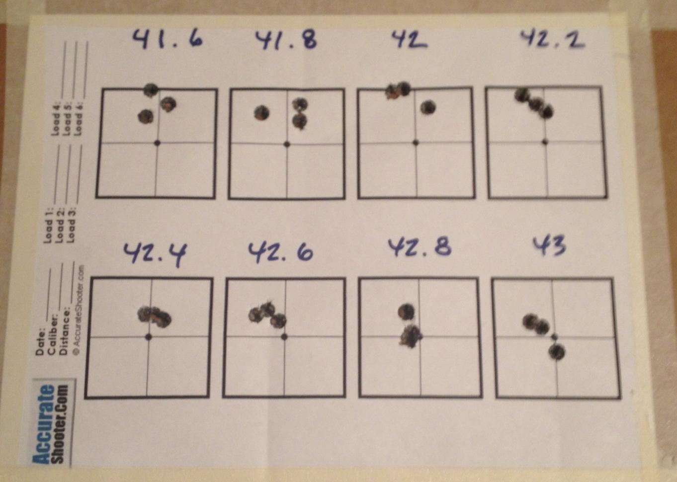

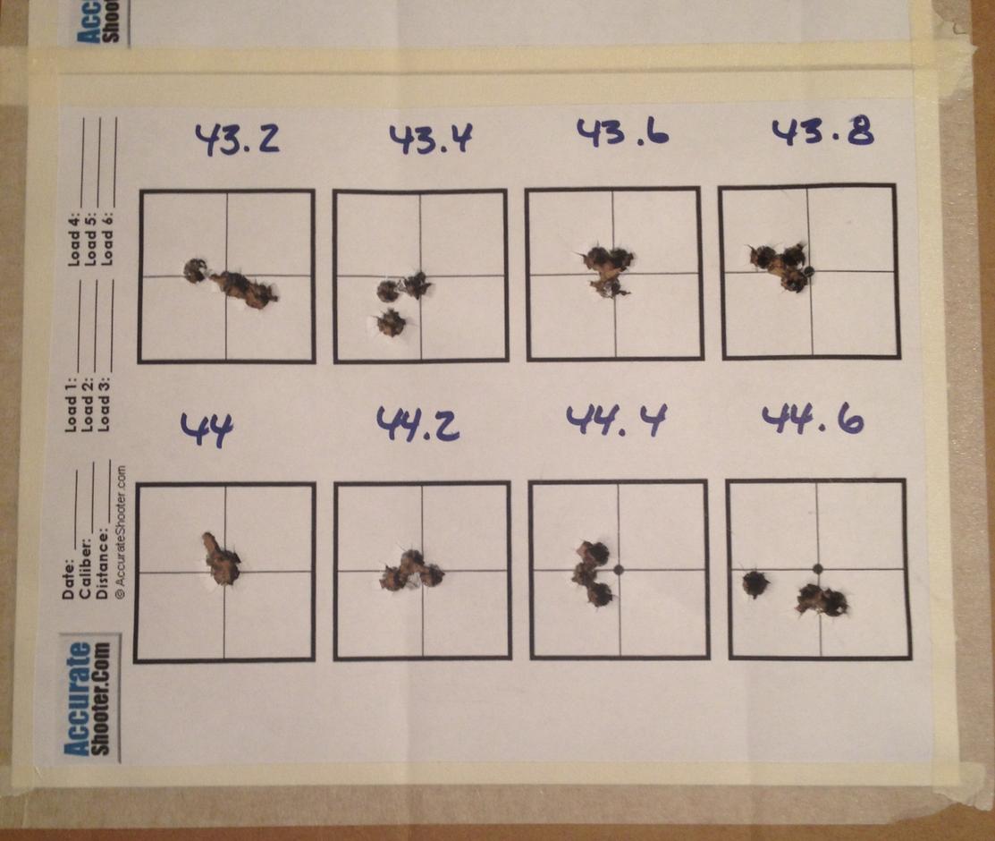

My rifle is a Remington model 7 and 44. is a WELL known accuracy node for a 308 pushing a 175 MK. Here are some pics of my OCW test. You can see I went beyond 44. and I did not see any pressure signs (hard to lift bolt handle, ejector marks, flat primers etc..) ALWAYS slowly work your way up and look for signs with every increase! You still have a little bit to go before your closing in on a hot load with high pressures.

Do you know what kind of velocities your getting around 44 gr?
Gi'day,
Depends on temp and barrel length - for 25-26" barrel I get about 820 m/S = 2,690 fps with SD = 3 m/S or less (10 fps).
With colder temps (10C/50F) = 815/2675 and warmer (25C/78F) = 825/2710.
I used to use 44 gn with my 'tuned' Rem 700 PSS. After putting a new custom barrel on it, it definitely prefers a bit more powder (44.5 looks good for now).
Cheers
Sorry but no, I don't have access to a chronograph and only go by results. The 44. on my test was nearly through the same hole and surrounding groups were all close to the same POI. I have not yet had a chance to get back to the range to see how it does at 200 but before this test I was shooting 1/2 to 3/4 moa at 200 using 42. so I'm hoping to see greatly improved results. Remember that these tests are giving you a general idea what your rifle likes and can be further fine tuned after you decide what charge you are going to use.
