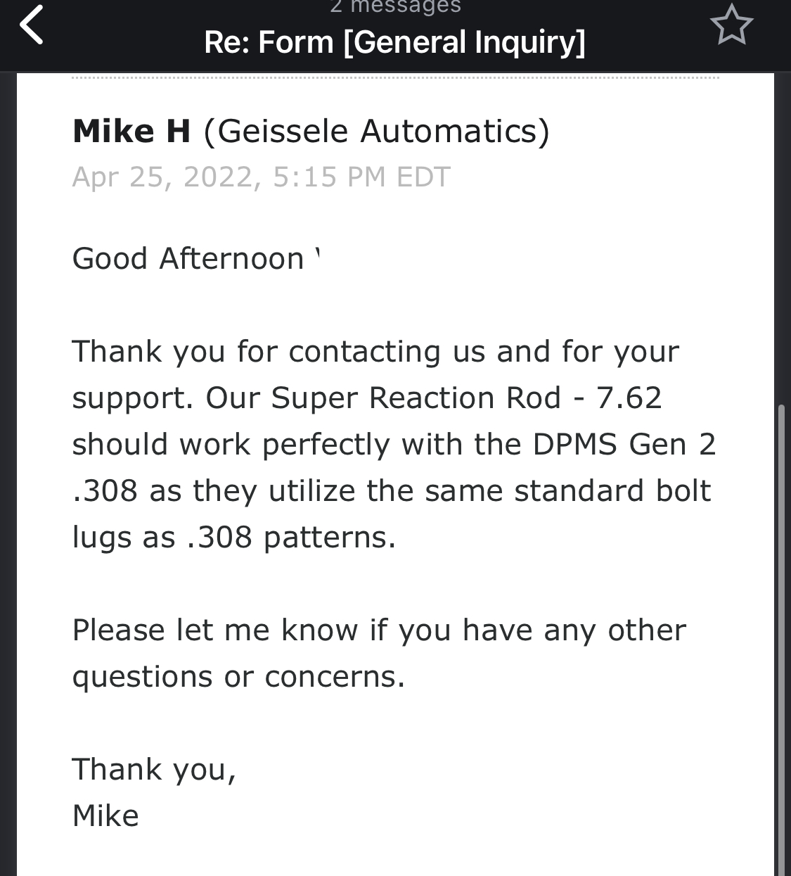

Thanks. I was more interested in how the Geissele large frame reaction rod was going to fit in a small frame upper, but those vise blocks should work fine.
Oh! I’m sorry. I did say was going to get the reaction rod.
I hesitated to buy the Geissele reaction rod due to the wording of their email. The Gen2 doesn’t use the same bolt lugs as the Gen1. When I found the upper block I decided to go this route instead.
