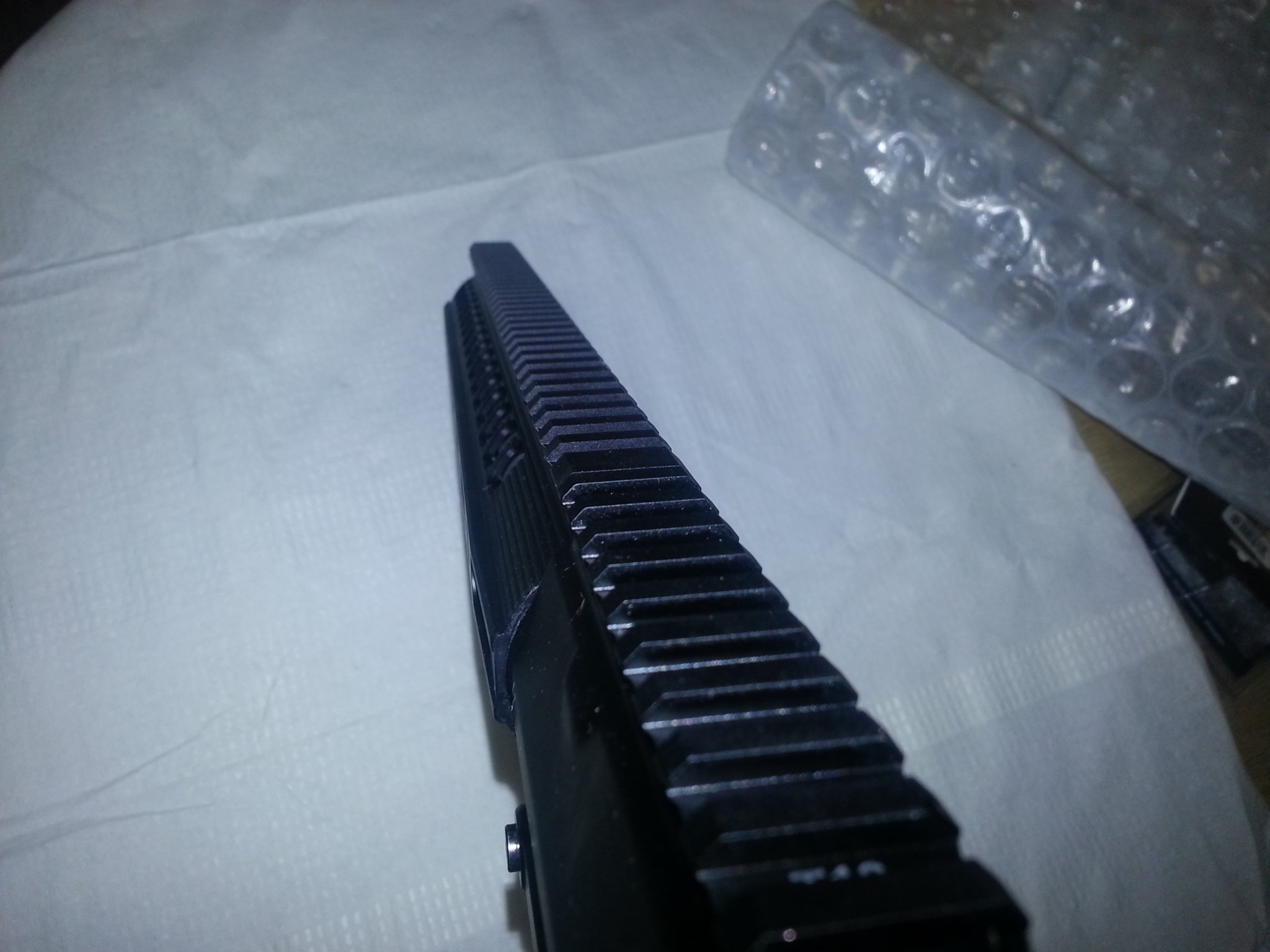

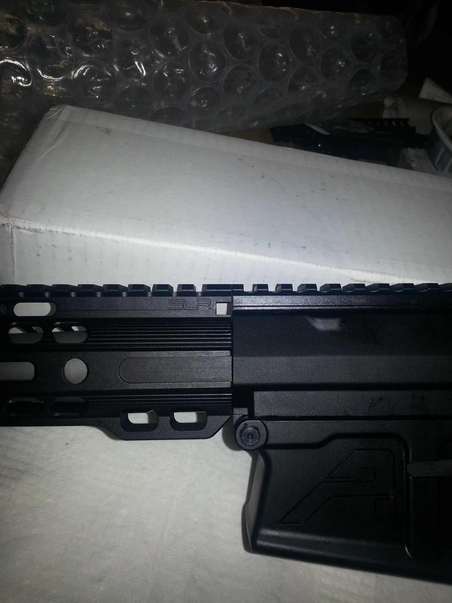

...check out SLR Rifleworks, they make both "high" and "low" DPMS pattern HG's. The Aero M5 uppers takes a "HIGH", attached is my M5 with the SLR HG showing the fit. They have multiple models that have the short rails up front, scroll thru the offerings to find what you prefer. You will want the ones that are labeled "308H" designating its the HIGH model for DPMS pattern. NOTE: They also offer Armalite AR10 pattern HG's, make sure you select the "DPMS/SR25" option in the pull-down menu. Aero M5's are DPMS/SR25 pattern.

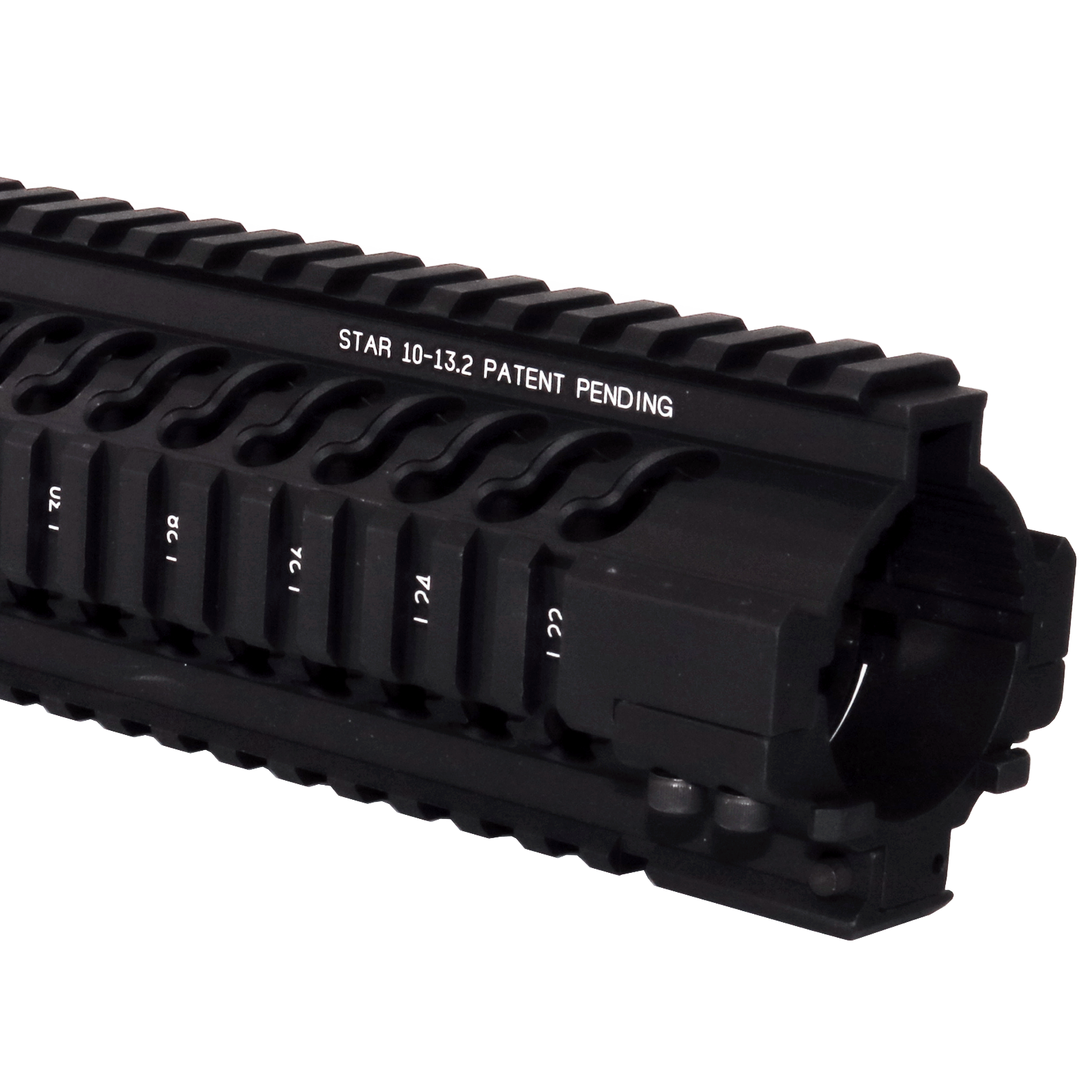

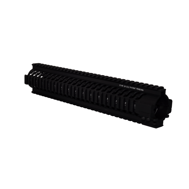

I'm slowly building my ar but I was only able to find a manufacturer named Samson.
I'm also building off a "High profile" dpms platform
Not a fan of the s shaped vents but it's the only quad rail out there

Samson offers that and is American made. I would know nothing about about the quality though.

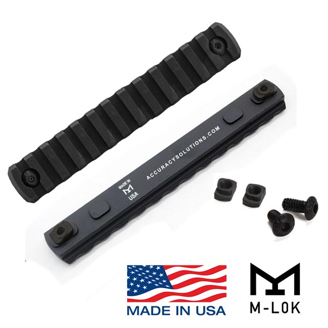

The last option for anyone that wants a true quad rail handguard would be to just buy MLOK quad rail adapters but irt wouldn't look uniform unless there's handguard covers.
These guys offer that kind of option

I ordered a 13.2” STAR-10 from Samson back in November and I’m still waiting on it… I’ve had better luck just scanning all the classified ads for used stuff. It’s kind of fun because sometimes you’ll come across some absolute gems. But, be ready to fork out the cash though because people know their value now that everything is discontinued/out of stock. Saw a DD Lite rail go for $650 a while back 😬
