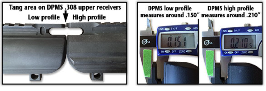

That's the rub...there are actually 3 profiles, Low, High, and Extra-High/Target whatever, which is what I have. My issue is/was determining the dimensions of the Low and High, and what the mystery rail I have matches.

I came to post this. Within the LR-308 and AP4 1st Generation large frame DPMS rifles, there are 3 rail heights.
This does not include the Gen II small frame.
You have:
LR-308 “Lo-Pro” which came out in 2003, had no forward assist or ejection port door
LR-308 AP4 “High” .210” (which is lower than the "Lo-Pro")
LR-308 AP4 Low ~.151"
The small frame GII has standard M4 receiver height.
"Freedom Group” shut down the DPMS brand, along with Bushmaster and Remington, so DPMS parts are now a finite quantity.
I always heard the 0.535" height rifle as being called the "DPMS/Panther Sportical" (sport+tactical). 2012 DPMS/Panther catalog PDF. There are other quasi DPMS receiver heights out there, most notably being the PSA PA-10, which is slightly higher than DPMS low. CMMG does not specify which profile (high/low) OPs rail is on their website. It may be in between, and as the OPs concern is cosmetic, that may be an issue if he's building around the rail. I would contact CMMG for clarification.

Now that I know the height of the various receivers, and the height of my existing receiver, I can measure the rail based on that and give me a clear idea on which way to go.
