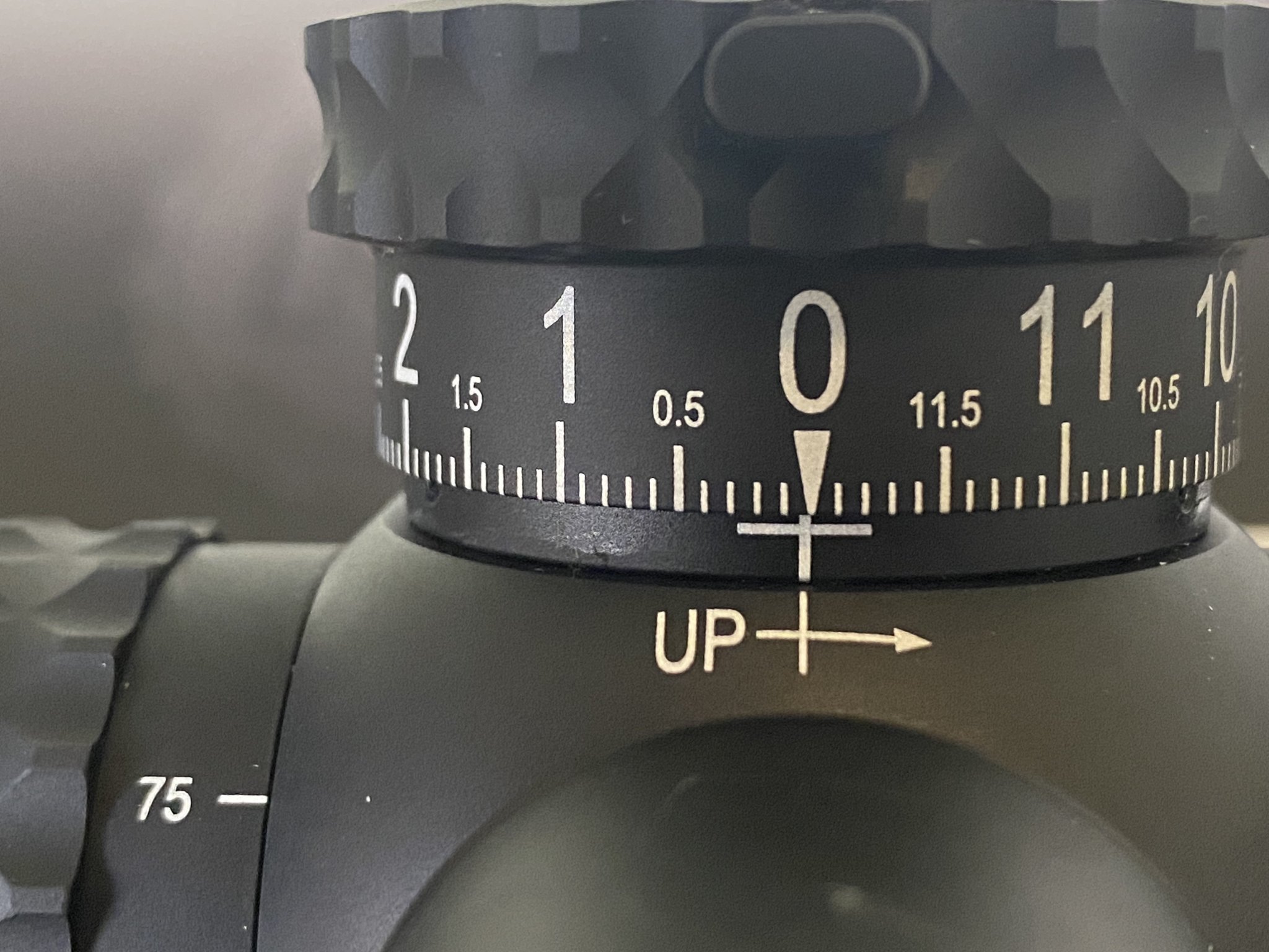

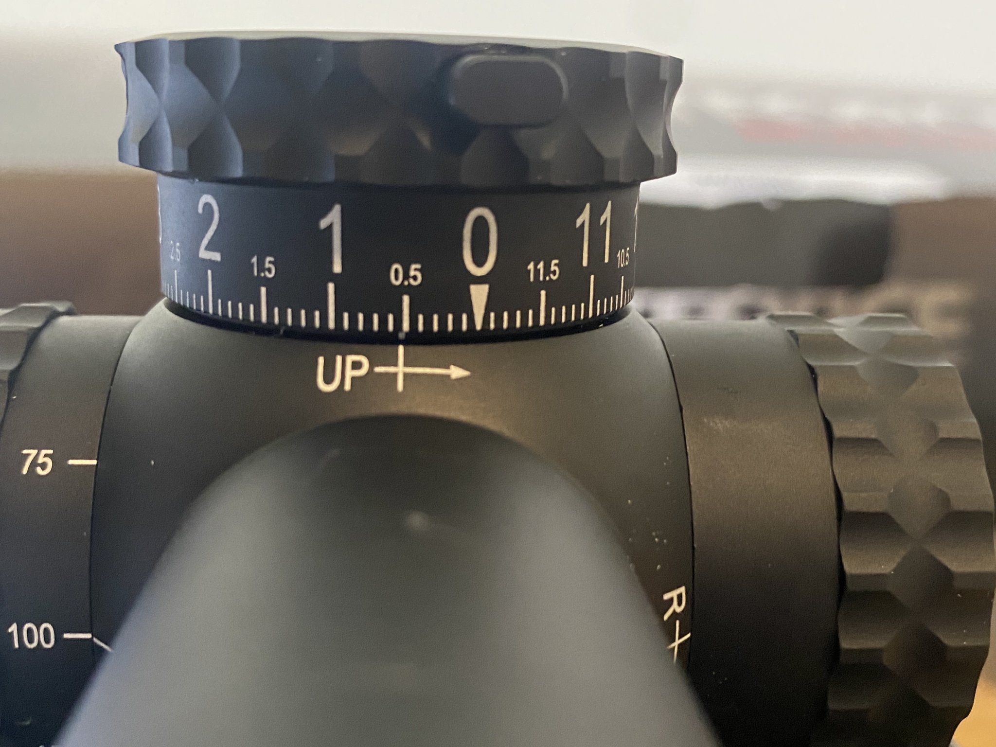

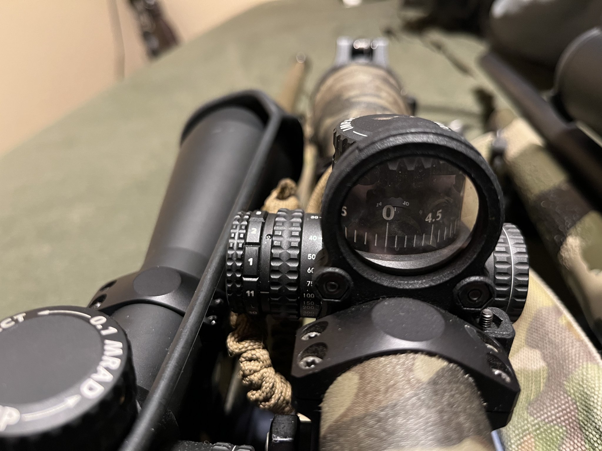

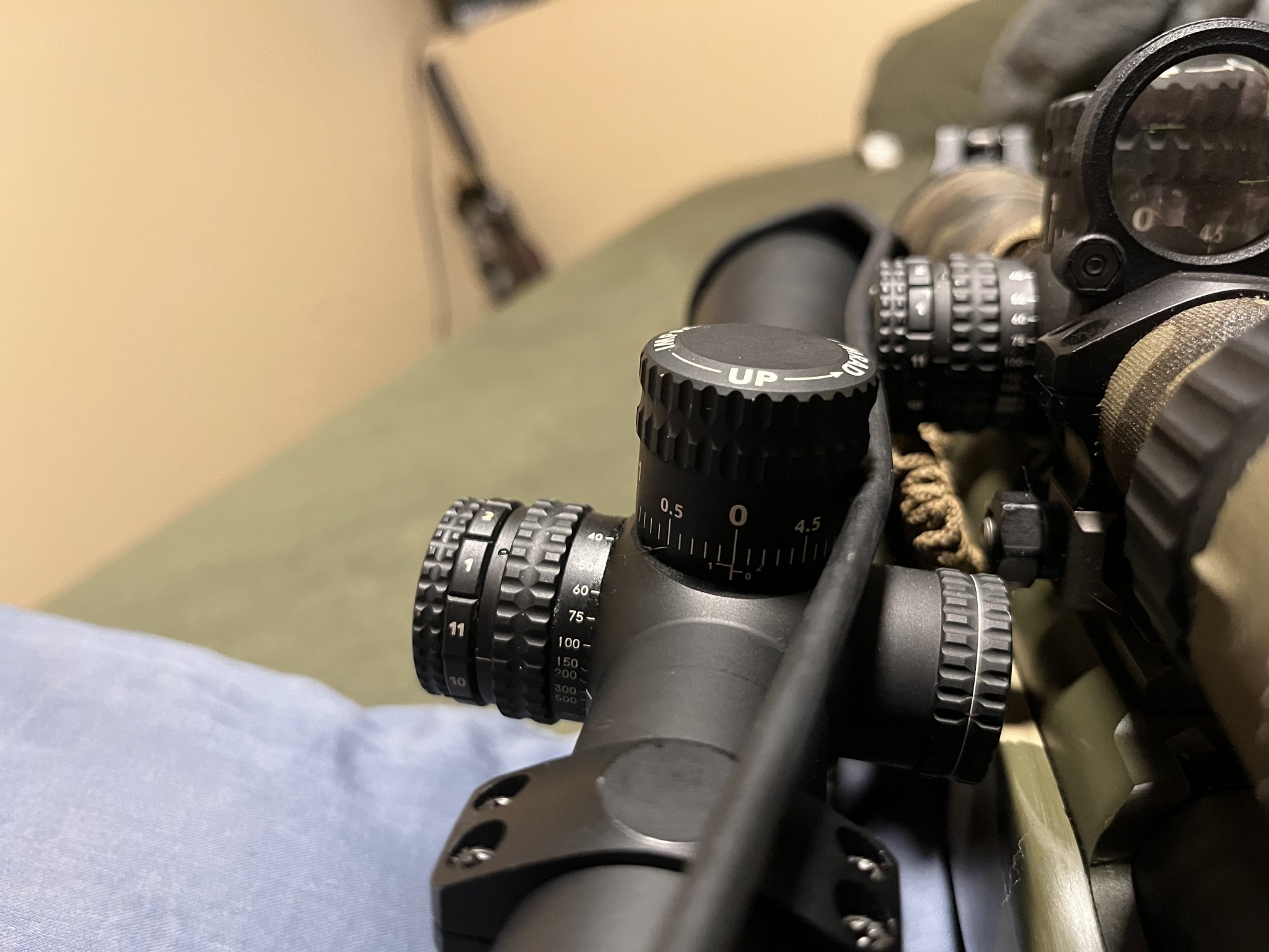

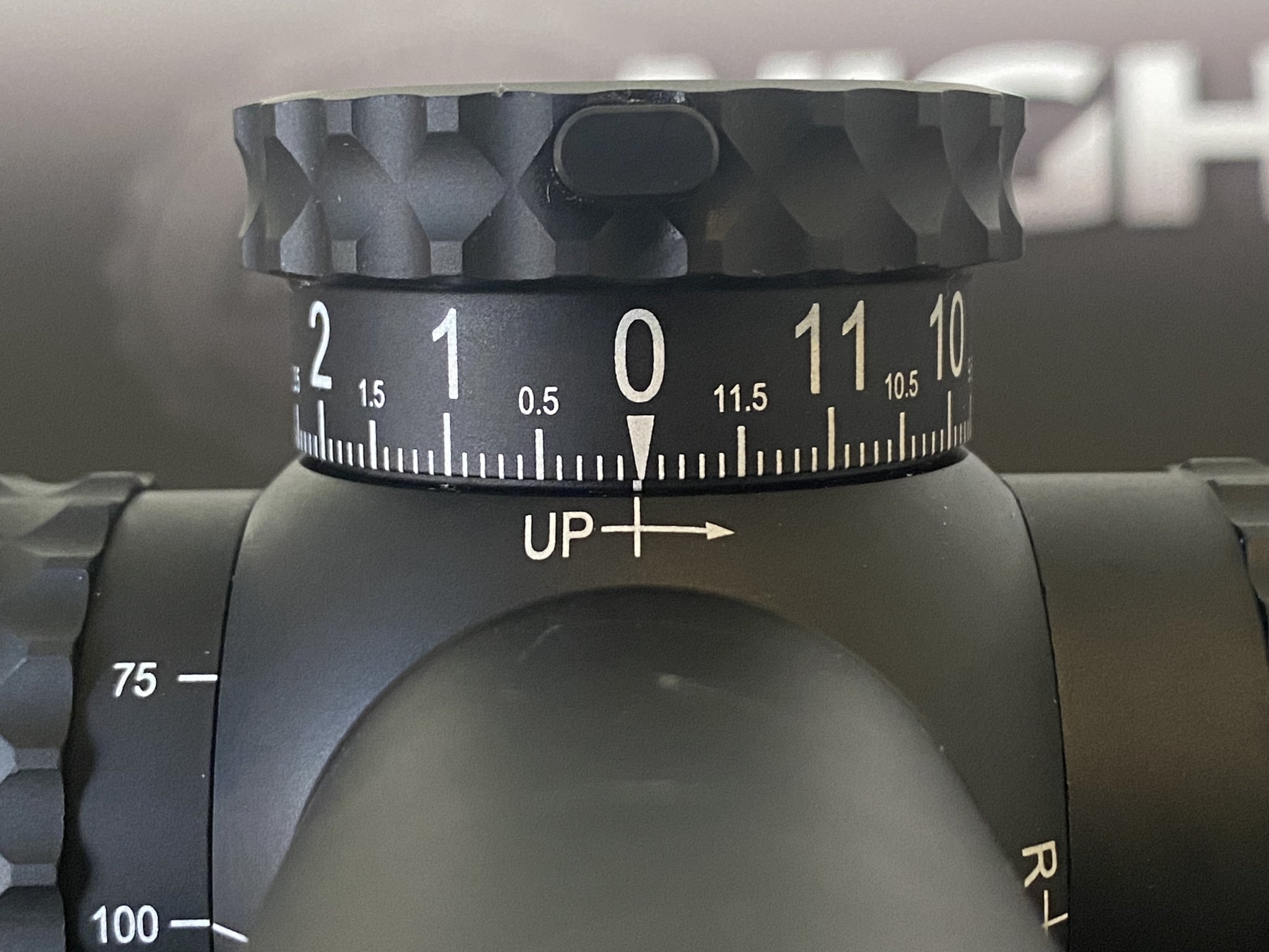

Received my ATACR 4-16x42 F1 yesterday. Below are three photos of the elevation turret
dialed at 0.0, 0.5, and 12.0 mils.
As it sits, the marks are a hair "overclocked." I removed and reinstalled the elevation cap and it's still the same. There's an extra mental step I have to take when I glance at the turret after dialing to know with certainty what I've dialed to. I could count the clicks, of course, but my expectation was to glance up and be able to say "0.7" or "1.2" or what have you, instantly.
Question: Do the marks on your turret match perfectly with the index mark on your scope body? Should I contact Nightforce?
I've done that multiple times, and I'm doing it correctly. Misalignment persists - very consistently.

You can't set a ZeroHold cap anywhere except in line with the channel of the ZeroHold steel collar that's attached to the turret, and any bias you could apply to the turret cap during the resetting process is limited to the leftover tolerances between the OD of the ZeroHold pin in the cap, and its corresponding channel in the ZeroHold collar.
There are no dents from the set screws either.
What else do you see in your crystal ball?
It's a left handed turret, bro. Get on the gun from the right side, then look at it- it'll line up perfect.

The turret is infinitely adjustable. So if you are at .5mil then adjust the turret to be dead on at .5mil it should be dead on at 0mil and either be locked or not locked. But the marks should stay aligned.
If it's off at 0mil I would guess it's the turret is slipping on the post underneath.

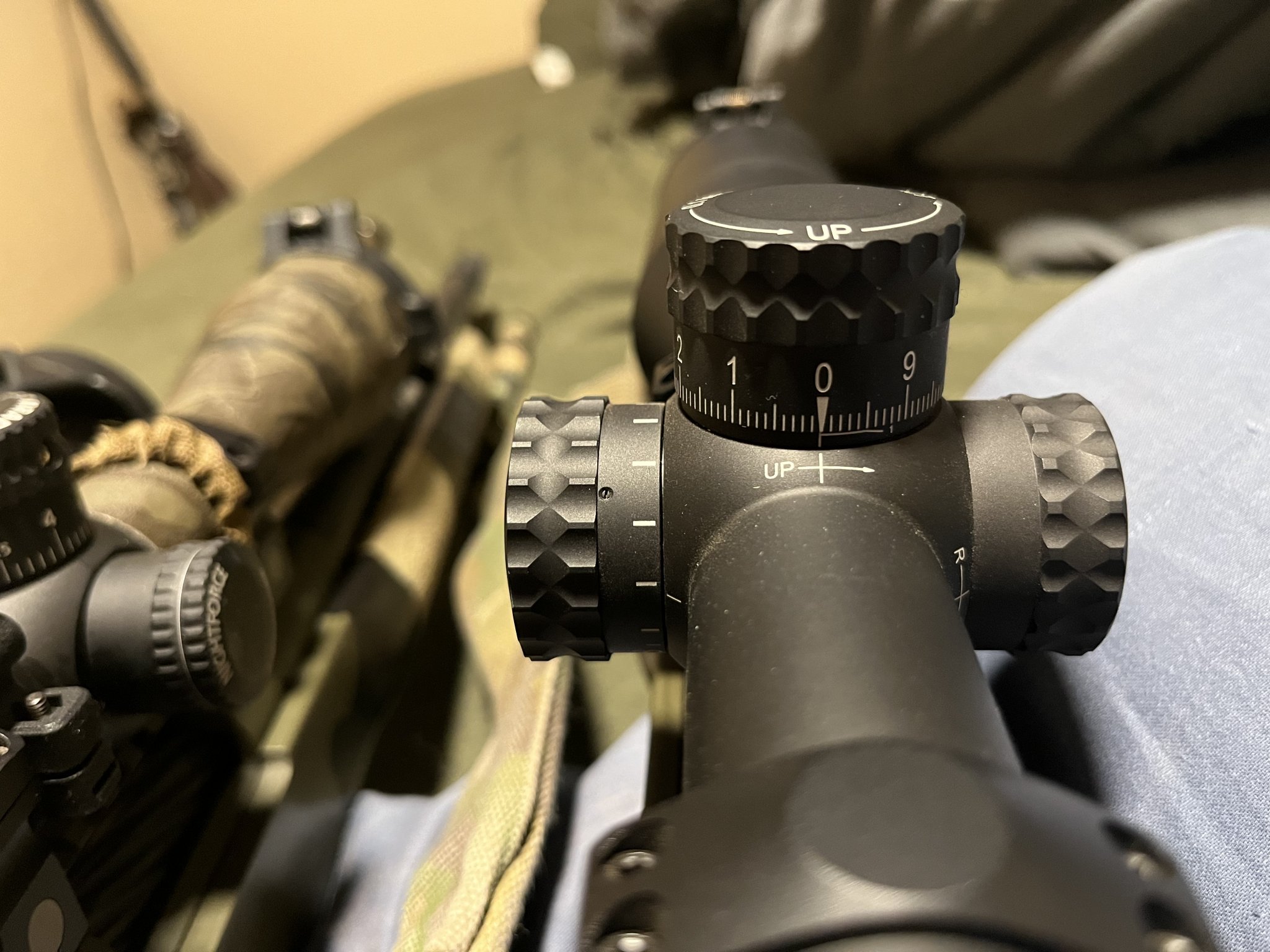

The only way you could “slip” a ZeroHold turret after zeroing is within the tolerances leftover between the OD of the pin under the turret cap and the width of the turret post’s collar channel on either side of the same pin. Not much room.

CS and I, over the phone, tried dialing up, loosening the cap, and setting it back down (in the same spot) trying to align the marks precisely, but it was a no-go. He advised sending it in.

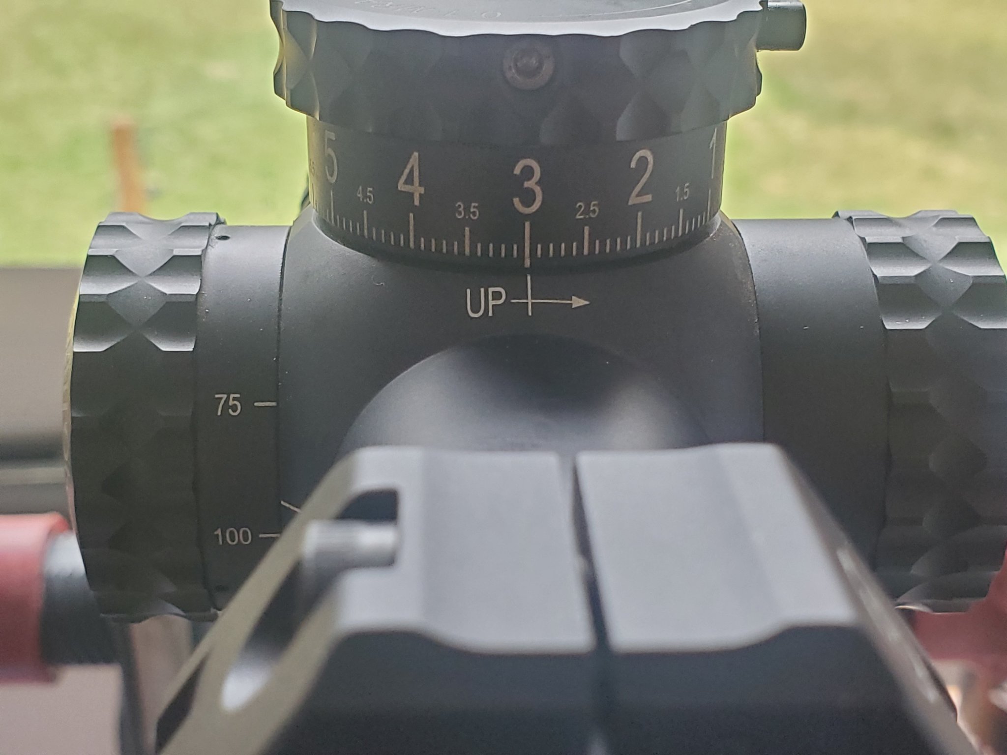

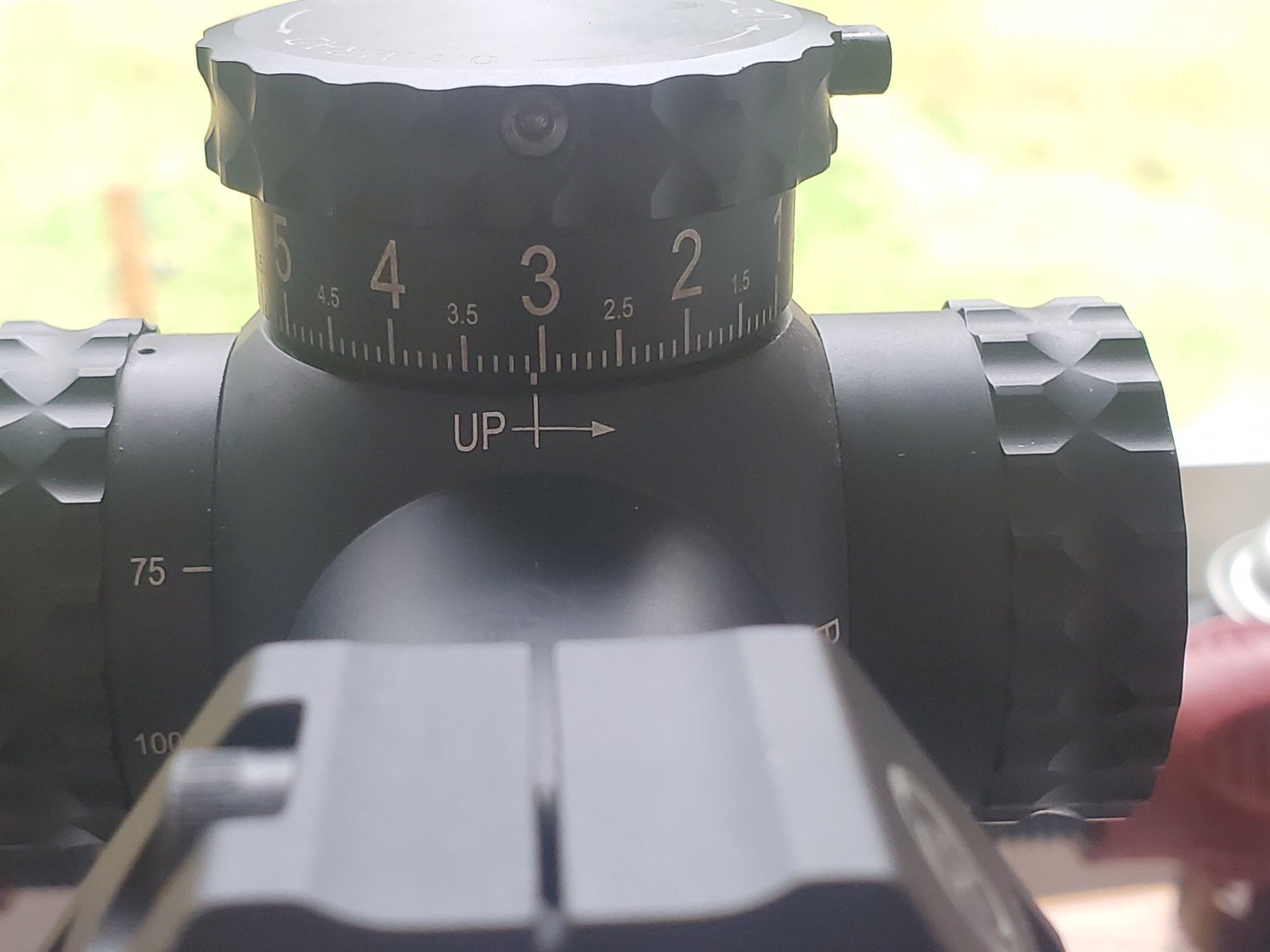

I went home to play with mine at lunch. I'm saying 100% user error. The turret adjust almost a half of a tenth and still lock at zero.
See the attached pictures. Both will lock in at 0. The turret is infinitely adjustable. It helps to move it off of zero to dial the hash mark in perfect.
