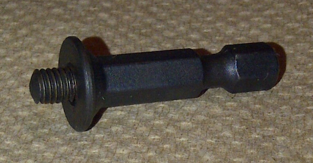

For the RCBS Trim Pro 2 owners.. if you have not tried a drill power adapter that replaces the hand crank, I recommend trying one. There are probably several companies making one, but I bought mine on EBay from dacamreloading for $10 + $2.50 shipping.
I tried using a quick connect first, but had better success attaching a drill directly to the power adapter. I quickly trimmed, chamfered and deburred my last 100 cases. 390A37BD-36B7-421D-A9FE-127903D384C3.jpeg
Reactions: spoe
I just remove the hand crank and insert the shaft in my drill and tighten. Seems to work fine...So what is the need for an adapter? Am I missing something here?
After i removed the handle, I filed 3 flats on the cutter shaft that matched the jaws of my cordless drill. Works great.
