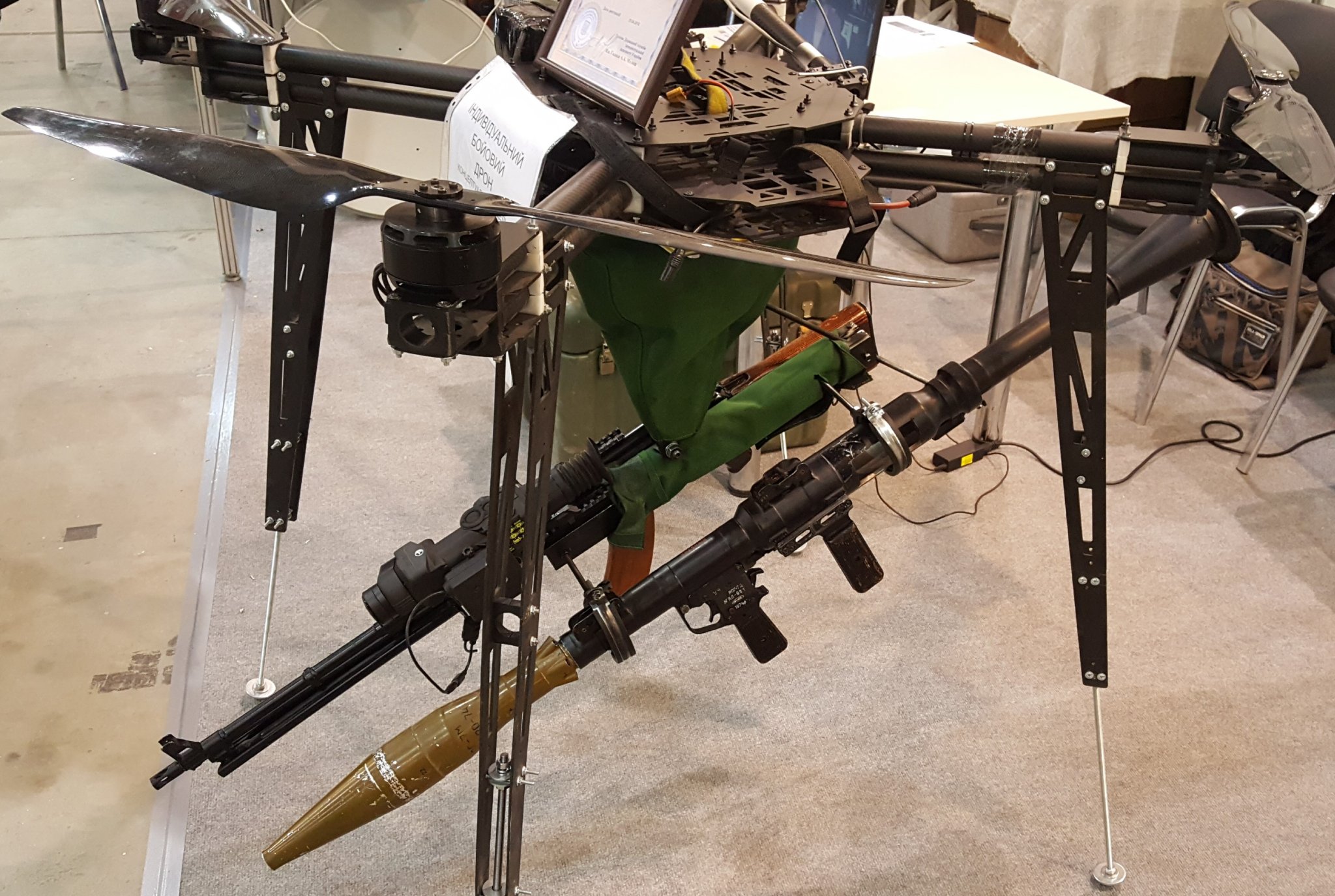

Why not get a drone that could not only reduce hog locating time but actually reduce the hog(s) lol...
Here is one from my last Ukraine visit that would work....

@THEIS. I do like that.... and if I had a reliable source of little curved green things with collapsible feet, id use those too, instead of tannerite.... :- )
@redneck , feeding the 134 might get expensive. :- )

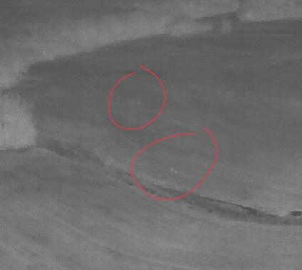

View pro 640 on phantom 4. Those few ounces pulled flight time to 18-20 minutes.
Thermal viewer ran out of power around 30 minutes.
Thermal viewer range b4 degradation of pic, 1000 yards. Got better resolution and id of game with handheld at that range.
Camera struggles at 300 feet.
Back to drawing board.
At 300 feet, deer didn't like the noise and fled field. Saw 30 or more.
Only saw two pigs, neither while drone was up. Next trip with a couple of mods or a different unit.

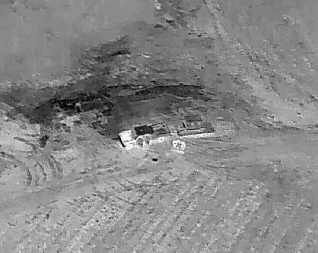

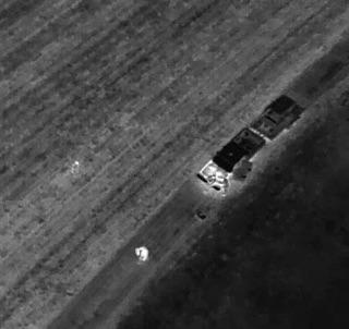

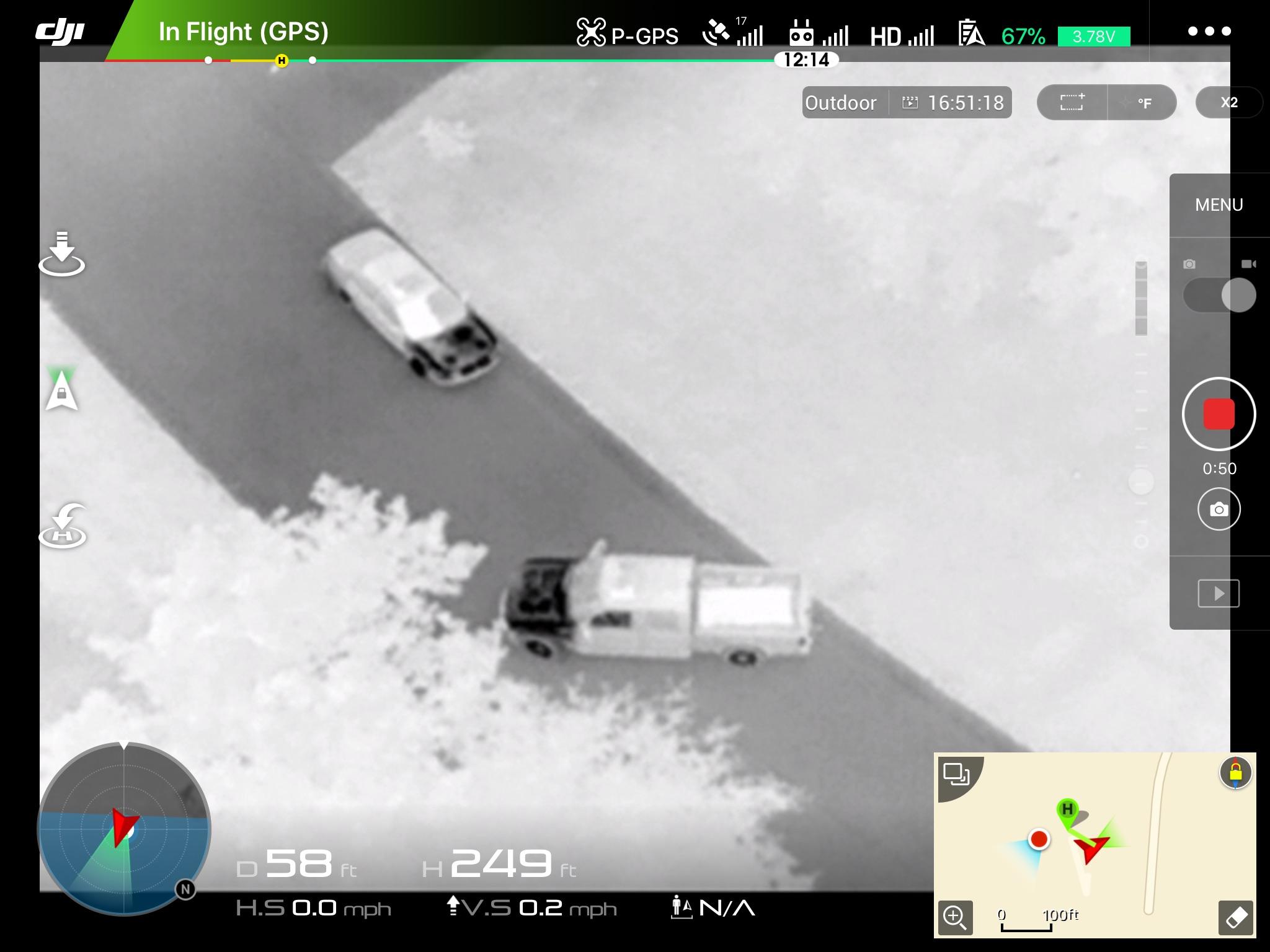

Own Inspire 2 Unit. Managed/stored with LEO Sniper (Ret) in FL. Have Part 107 UAS Rating also.
Much time spent on day camera, Thermal options - research. As you know, bring money. Payload reduces flight time, cold temp's reduce batt life and more. Thermal camera offerings and reviews prove pics you posted. No need for the excellent day camera options available now - but will in future. Waiting. Can refer you to several with experience down south.
Inspire 1, v2.0, zenmuse on gimbal mount. Swap btw zenmuse and day unit. Don't have any pics to post yet.
Other system posted no longer considered except phantom 4 used day only for other stuff.
Car.. ci.. noid.. not fun.
We've operated the Matrice M600 with day + thermal mounted for SAR purposes with excellent results. Full part 107 required for 24 hour flight needs. I imagine it would serve well to spot, track, and document "critter" movement on property and allow you to focus your ground efforts where needed. You're well into the ~$20k mark with supporting equipment/spare parts but that cost may very well be warranted/recouped if crop loses are high.
Enjoying the part 107 prep details. Not....
Pic posted above with said set up

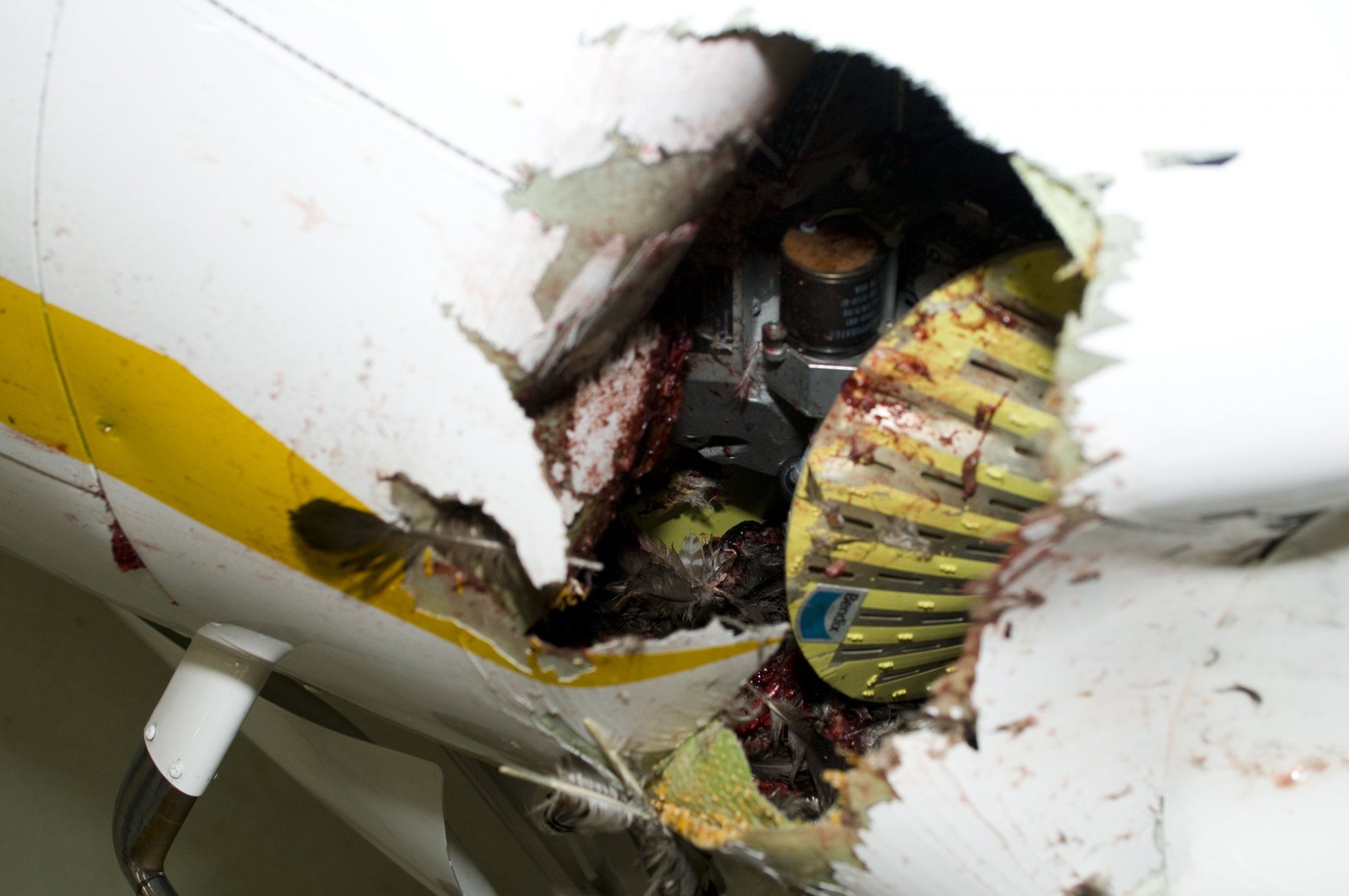

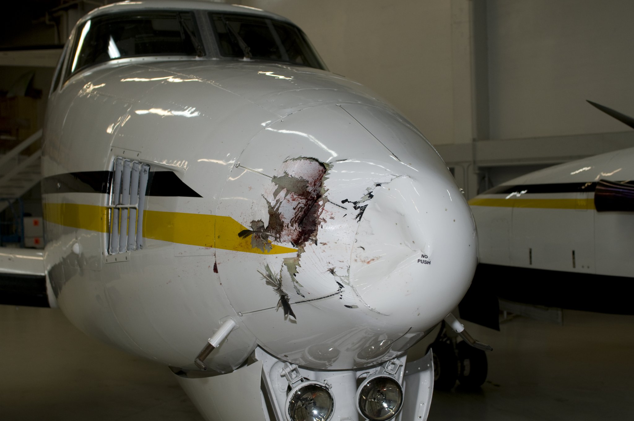

Momentary Thread Hijack... @Basher makes a good point. Talking about things hitting an aircraft. If one of these drones connects with an aircraft the results would be devastating and possibly fatal.. This happened to me 8 years ago, a small bird, estimated to be about 4 lbs, at 200 knots. We found half of said bird inside. $300K in damage. The radome, radar and the first bulkhead had to be replaced. The radar dish itself was bent almost completely in half like a taco. Now imagine one of our helicopters with only a piece of lexan in front of the pilot vs a Phantom... Bad news
