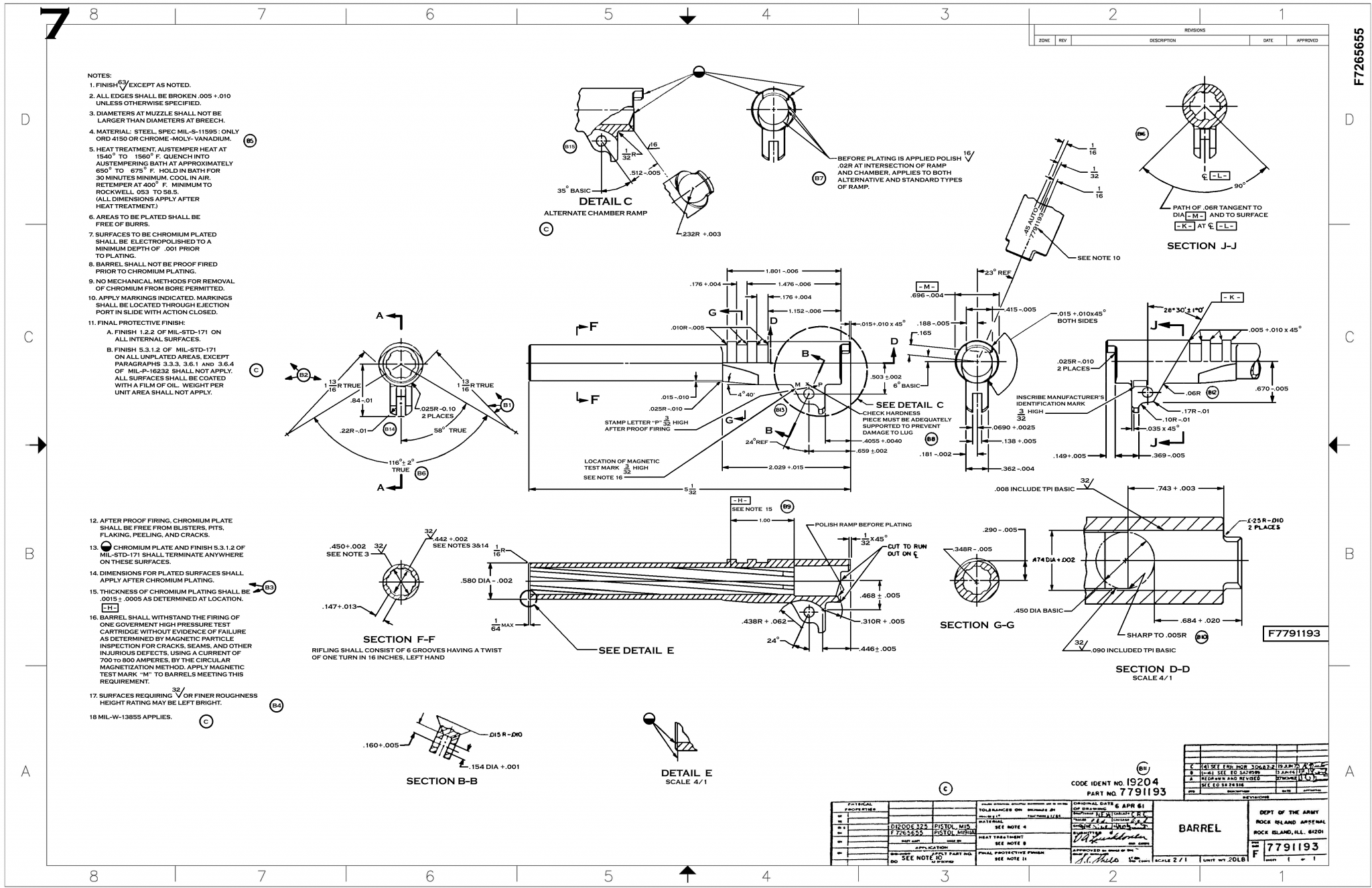

    Basics

    The GI Drawing Number in the lower right corner (7791193, as described in the above post) is the military standard for a rack-grade pistol. If the barrel is made to those dimensions it should fit a true military-inspected and accepted M1911 or M1911A1 as a drop-in.
    Most commercial non-Colt weapons are not built to the original military drawings.

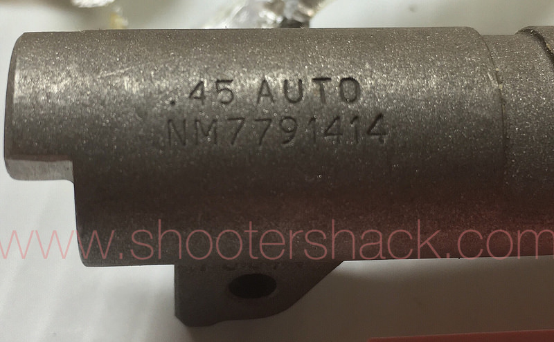

    This is a National Match barrel:

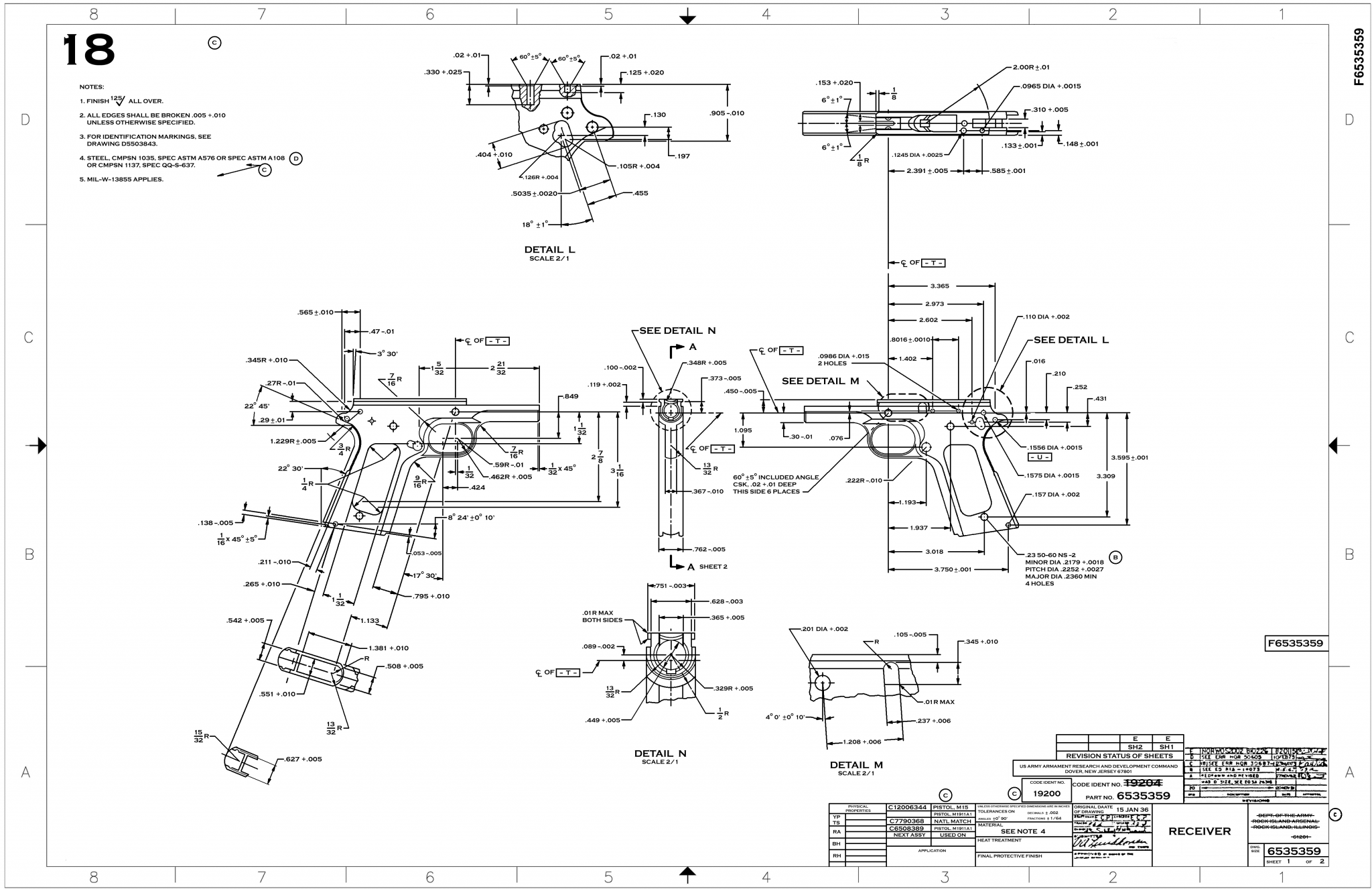

    This is off topic but maybe someone can use it?

    Very true, thank you for sharing this. I once acquired two NM Military barrels and fit them to one 70 series and one old Ithica. They shot very well, better than most could ever hold them.

    Interesting to note that both my Military NM barrels were wrapped in a sealed foil and paper container and both serial numbered. They had matching Barrrel bushings and the hood was polished, not parkerized. I cannot remember if they had a link? i paid 50 a piece and wish I could find some like that today.
