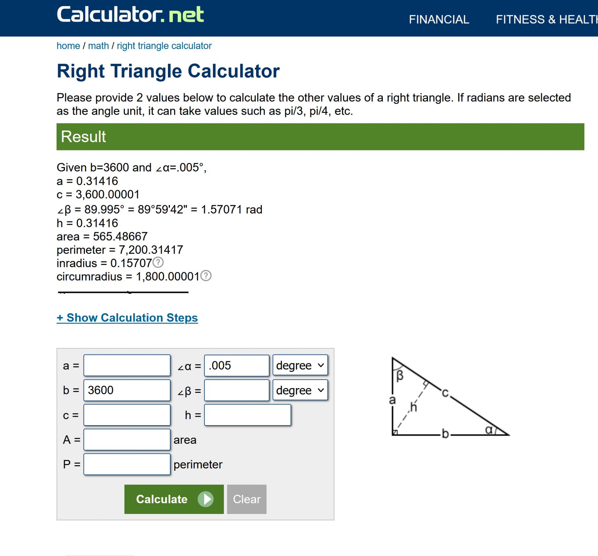

Being an analyst by profession I look into everything. So, some time ago I looked at the geometry. Why? Because shooting is not about inches, it's about angles. Errors in inches on target are a result of angle errors at the rifle end. So, I used geometry to figure the following.
I went to a quick right angle calculator on the web and ran the numbers. At 100 yards, an aiming error of .005 (5 thousands of a degree) degrees will change the point of impact .314 inches high (vertical angle # in this example) at 100 yards (a = .31416)! Here's the website and the stuff I entered - I entered 3600 for the distance so we get inches to inches. 100 yards is 3600 inches.
This was awesome. I love this thinking, thank you. Reducing the amount of input from my firing hand has most certainly made a difference.
