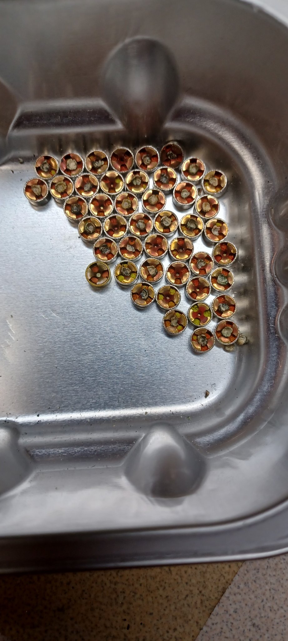

I looked in the cases but it's hard to see. So I just deprimed a couple and found media in some so I just deprimed them all. This was what I got. I'll throw those old primers in the Armageddon box. Not a very serious screw up just wasted some time. Thanks for your time.
As long as they pass a visual, there's nothing wrong with those primers
Here, let me help you . What's your crystal ball say now ?
