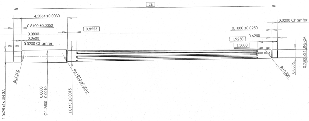

Can someone please tell me what the diameter of the extension and 6" clamp area on a DTA barrel. Thanks for your time.
Here ya' go. Couldn't get it to work as a PDF for some reason.
Good luck.
C.
Reactions: Average guy
Thanks for the help. Exactly what I was looking for "C" .

Hi,
Does anyone have a print of the Desert Tech Contour. I cannot read Chads as I cannot get it to enlarge.
