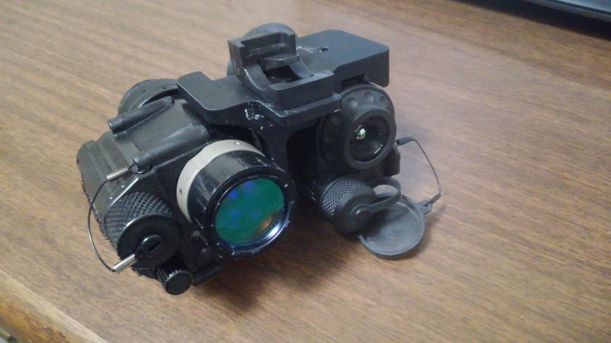

    I'm going to attempt to borrow a 3D printer to make my own bracket from Rhino to Flir/PVS. I'm going to borrow a buddy's PVS some time to get measurements for CAD. The $550-800+ price tag on the available mounts is hard to stomach for what they do. Not dogging American made, not saying they're not good, but all I need is for it to hold the units in front of my face and offer a little adjustability.

    Got a couple of tweaks to work out but this should end up working fine. Just walking around the back 40 it seems to work well. The thermal takes over in the shadows and the NV takes over in the "bland" temp spots.
