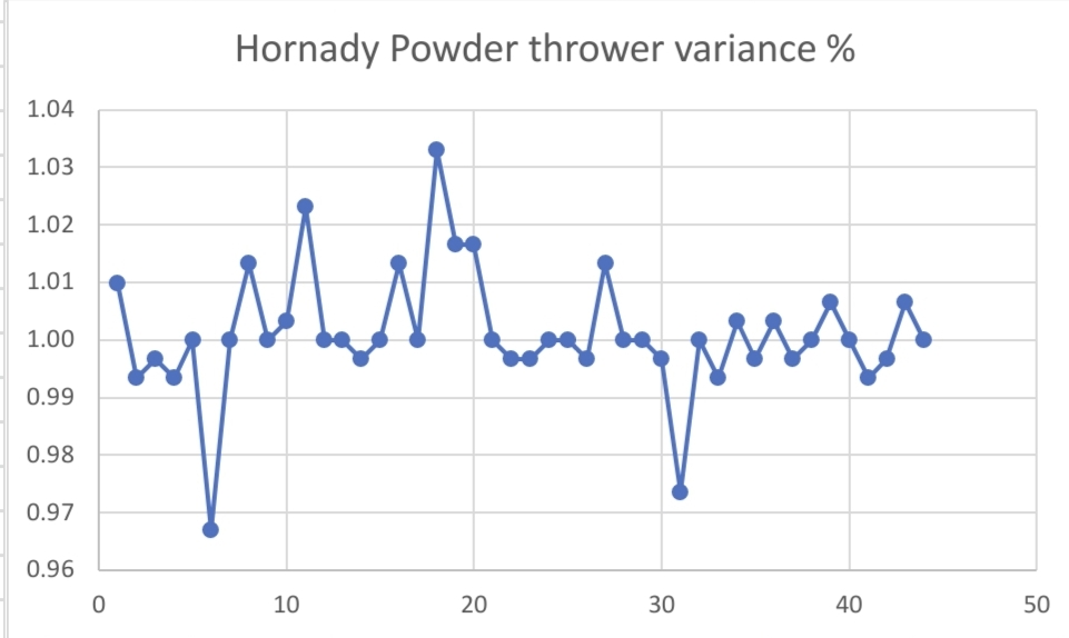

    -How much variation should I expect from the powder thrower? I weighted 44 charges and gave an extreme spread of 1.54 grains. 10 charges varied more than 1% outside the median charge.

    headspace maybe is not a problem, if only you have it the same from case to case.
    and for powder charge you should see, what group you have with the best load (not crimp, powder accuratly measured...), and than load for semi auto with crimp, powder thrower and see what causes the group to open up too much for your taste, and what does not infest your groups too much... imho...
    just reload for the best (and single feed), and than see what you can expect from this rifle and what is ok for your taste.
    with hard primers like BR4 it is hard to see pressure signs, because they are so tough and I even couldnt pierced them with over load because primer pocket streched... almost every other primers can be pierced, but no BR4 in my rifle...
