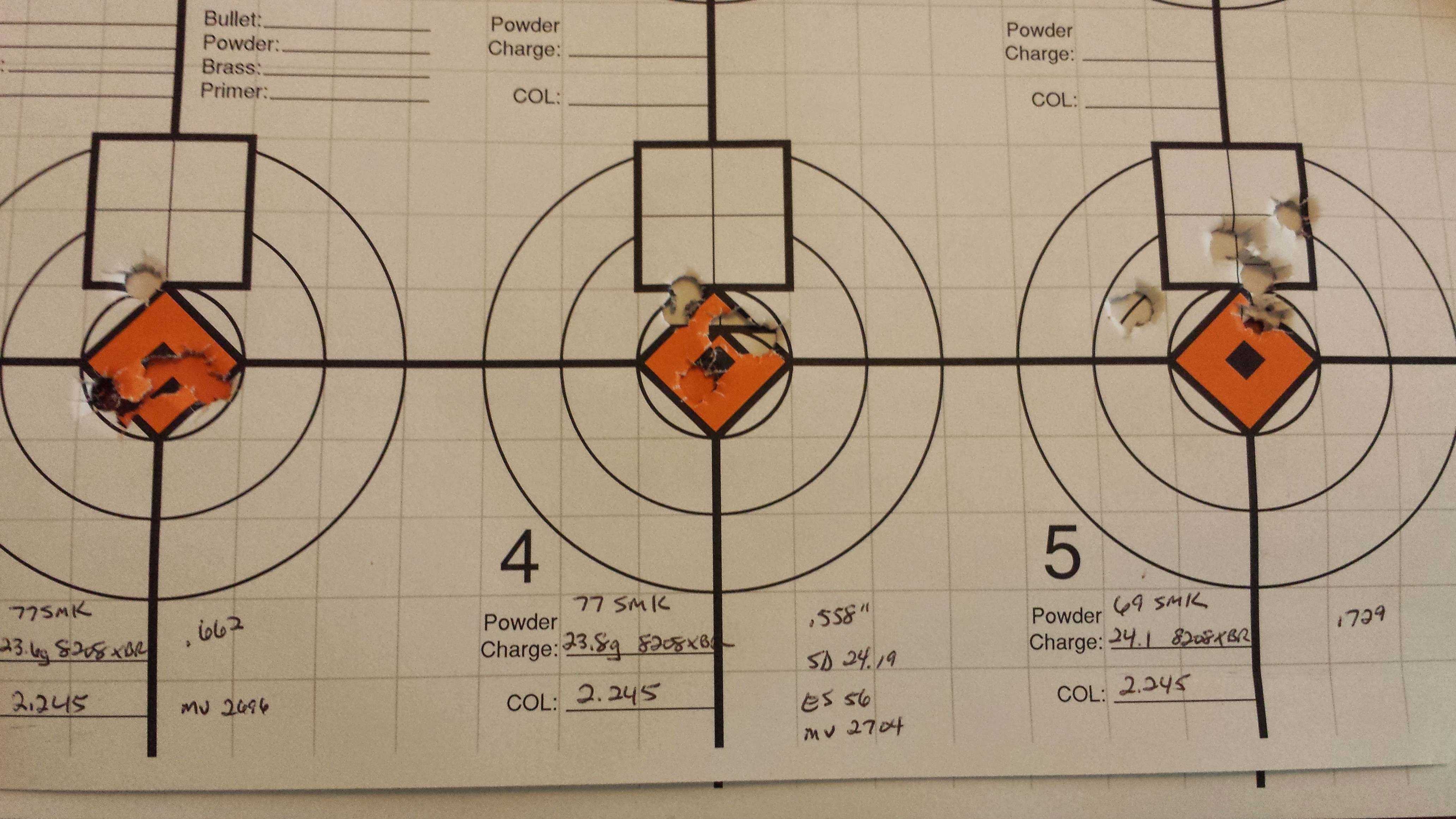

My try at mk262 clone through my 16" 1:8 twist Shilen barrel, Wylde chamber using Saker suppressor.
LC 11 once fired
23.8gr 8208 XBR
77SMK
2.245 COAL
CCI #41s
I will go back and run a ten round test to get better data. I will try the 23.5gr load again as well, don't know if I pulled that one or not.
LC 11 once fired
23.8gr 8208 XBR
77SMK
2.245 COAL
CCI #41s
I know it's an old post, but did you get a muzzle velocity on that 69 smk load as well? How did the 23.5gn load do with the 77's?
