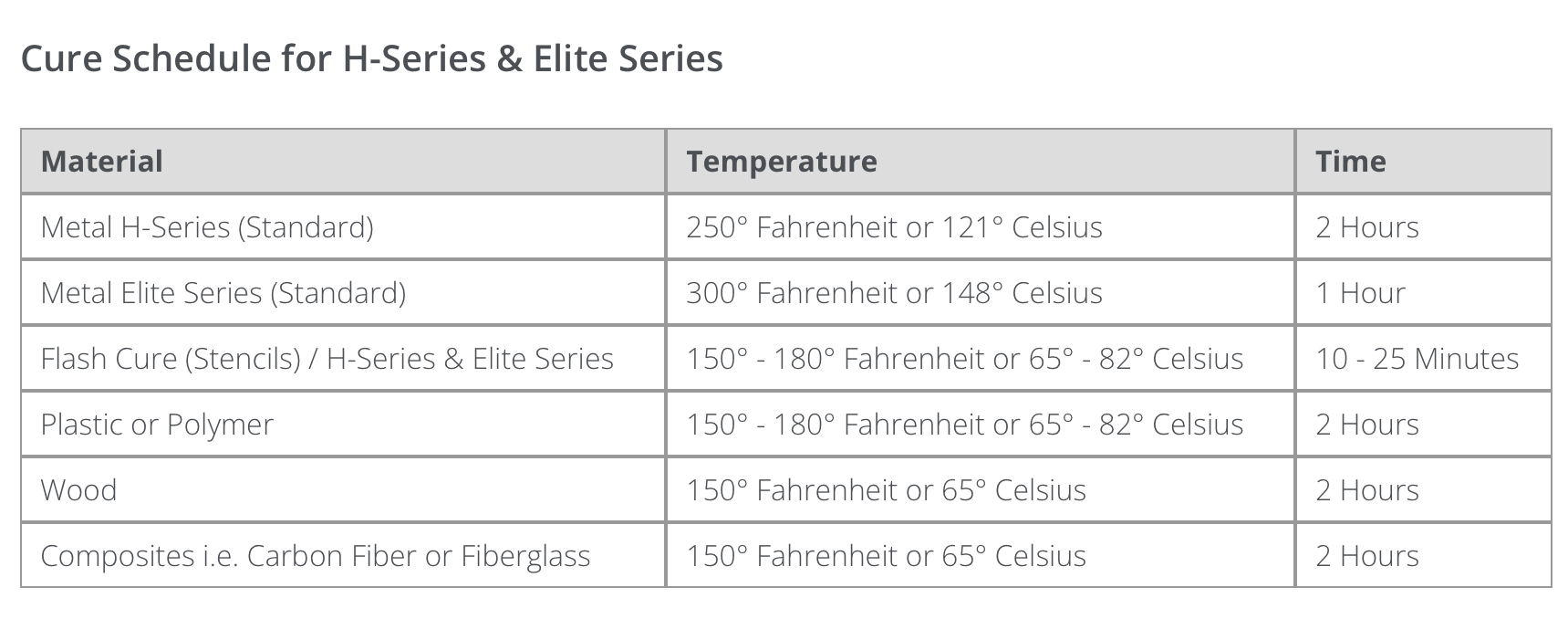

I’ve used all of them with success. Duracoat is fine for stocks as well as air cure (C-Series) Cerakote. I’ve used both. Read up on Cerakote’s curing guidelines. You can cure H-Series at low temp (150 -degrees) for plastics and composites. So you have tour choice of any coating really….
You still risk stock damage even at low temp curing. There is a chance the injection foam will re-catalyze and expand under heat and crack the stock. I believe LRI has commented curing over 300 stocks at low temp without failure, but I cant recall for sure where I read that.
Safest bet is air cure Cerakote or Duracoat, but bake cure can be done at low temps.
