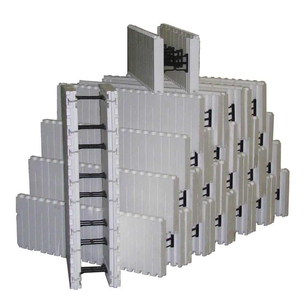

soo, i got to many toys and reaching the point where i want to secure all this a little better.
i am thinking of making a safe room in my basement, it will double as a tornado shelter, and mancave/reloadingroom
im thinking 10 x 20 ft size for the room.
the plan is currently, make the walls with the smart blocks from home depot:
what i dont know is how to do the ceiling, currently the ceiling is 8ft high, and offcoarse wood, anyone wanting to get into it just needs to cut a hole in the filing room floor.
anyone has an idea for the cealing? i want it to be concrete also

If you want to be serious about doing a shelter/saferoom/safe then you should consult an architect/engineer.
My money,if I had the lot I'd do a monolithic pour with access to your home.
Doing it your way is going to get expensive quick because mistakes or forgotten things add up quick.
But pouring concreate into the ceiling area is no big deal with proper shoring /forms and a slickline

It's very difficult to build a safe room once the house has been built. Unless you have a 10 ft tall ceiling in your basement, it's almost impossible to do. It's very difficult to do with a 10 ft ceiling too.

You'll have to go lower which will involve underpinning and redesigning your foundation.
It may sound expensive consulting an architect, but the basement floor is probably 3 inches thick.
Think weight.

As has been advised above, you NEED to look at the foundation/footing underneath wherever you intend to put these 'walls' and add a concrete ceiling to. That is a LOT of weight that your original foundation wasn't designed to support. Not only that, but the location of your existing footings don't do ANYTHING for what you are intending to do.
If you don't start with a good foundation for what you are planning, you are creating problems for your existing structure. These can be HUGE problems. And because 'you' are doing this (no matter the reason why) if/when you have 'residual/consequential effects and damages', you will NOT be covered by your insurance policy. Because somewhere in their fine-print, they have the statement of :
"We do not pay for poor workmanship or materials"
That covers a LOT more than you want it to.
Be smart, be safe, and be prudently responsible. And yes, I actually have worked with building cement walls with the styrofoam blocks similar to what you suggested above. I helped a co-worker put together his basement of a house he was 'building'. We assembled and leveled/aligned the complete basement in 1 day, (taped the corners) and the pumper-truck and cement truck arrived the next day. It was incredible how GREAT the soundproofing as well as the R-value of the walls were, as this was Northern B.C. and the winters are COLD up there. A small 1500 watt construction heater is what was used to heat the whole house that winter, until the gas inspection was finally completed and then the gas could be turned on. But I digress.....
Those walls are heavy without a ceiling. Add a ceiling to it, and I guarantee that the 'basement floor' will NOT hold that without cracking/crushing/crumbling in due time. Depending on how you attach that to existing walls, that too will lead to catastrophic consequences. Concrete can handle an incredible amount of 'compression' whereas unless it is 'pre-stressed', it can barely hold itself under tension.

You are but one who's dreams have been dashed when it comes to this safe room. I'd almost bet anyone who addressed this thread has put some thought into doing exactly what you want to do. Once given the parameters of such a room, most walk away from it.
If you have an attached garage, you could possibly dig out under the garage and build what you're looking for, but be sure, it won't be cheap and it will be a lot of work. My garage had about a 3 foot dead space under the pad, so I knew I was safe to dig there. Getting concrete to build walls took a lot and you must also run additional french drain to the existing drain to prevent the safe room from becoming a swimming pool.

If you were incorporating the safe room into an attached garage project, then it might be more palatable. The roof can double as the floor.
I built mine outside of my basement, using the patio/deck as the roof.
It may have already been mention above (I didn't read all the replies.) But, one thing to think about regarding a door. Tornado's create vacuum. So have your door open inside the room. The vacuum will keep the door from getting ripped out during a tornado. Also, even if the house falls inside the basement, you can still open the door and claw your way out.
