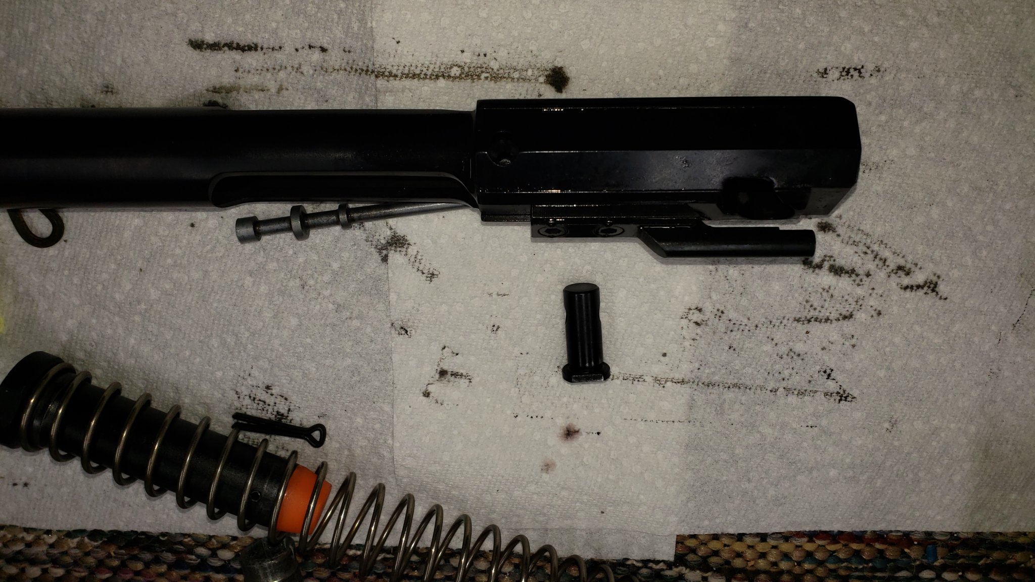

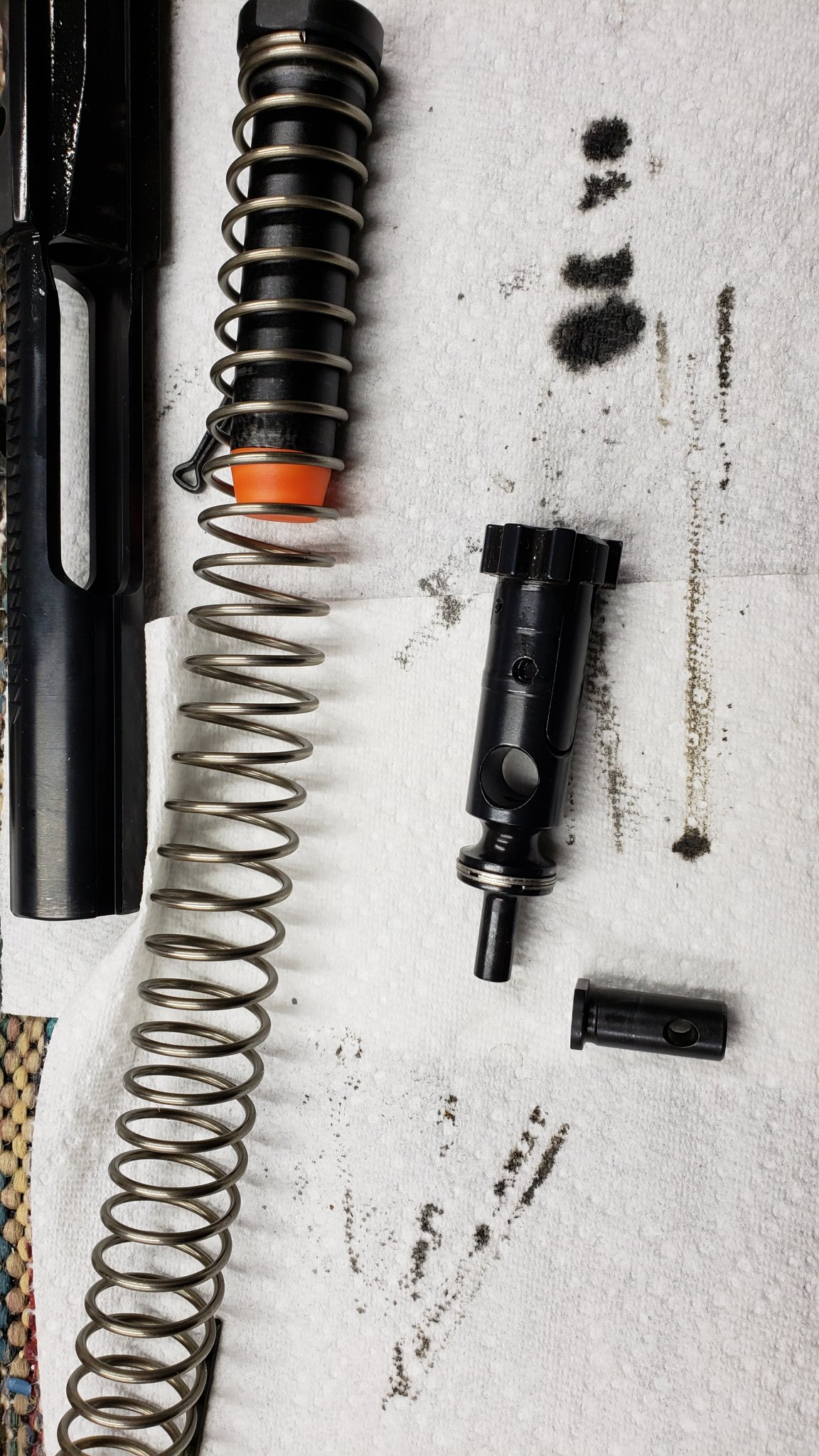

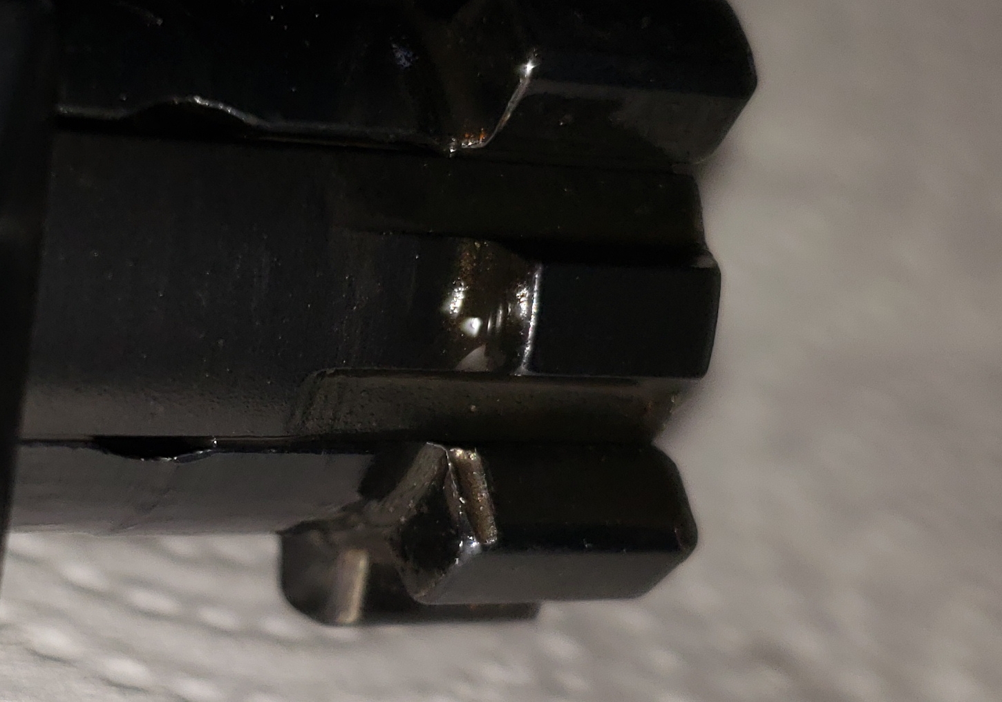

What causes this type of wear on the bolt. Gun is a PSA 10. Had this same kind of wear after around 150 rounds. only quite a bit worse. Sent it back. They put a new barrel on and complete new bo
lt carrier group. Possibly heavier spring and buffer but not for certain. They didnt send a list of what they did or the cause of the issue. I have fired about 80 rounds threw it this weekend and its starting to eat the bolt again. Im guessing over gassed and opening to soon after the round is fired but im not a gunsmith. Any help is appreciated.

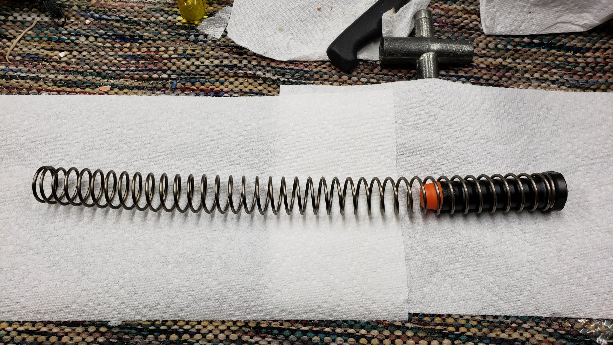

Almost all big ARs are over gassed badly. An adjustable gas block along with a Tubbs Flatwire SR25 spring and at least H3 5.4oz buffer will help mitigate the early bolt unlocking.

Brass is landing at about 2 o'clock. It has a heavier spring as well as a longer buffer than my Bush Master ORC .308. No markings on the buffer. Im going to call them today and send it back again. Then when i receive it back put an adjustable gas block on it.

Not as bad but another 100 rounds and i think they would be.

I just checked all of my BCG's in 7 firearms, and every other brand BCG I have used / tested... AIM, Brownells, Toolcraft.. nitrated , NiB, phosphated.( All fired with PSA builds, variety of barrels Criterion, BA, FN, and lengths, gas length systems.
Zero of them had any form of battering yours shows.
Nothing even close.
At this point, if all the bolt lugs are showing battering... I wonder if the cam channel is cut correctly.
Can the OP check inside the upper receiver for any odd marks , at all , at the cam channel areas.... or anything that might be restricting free movement of the cam pin through the upper... maybe the bolt is not freely, fully locking in place.
Also please weigh your buffer.
