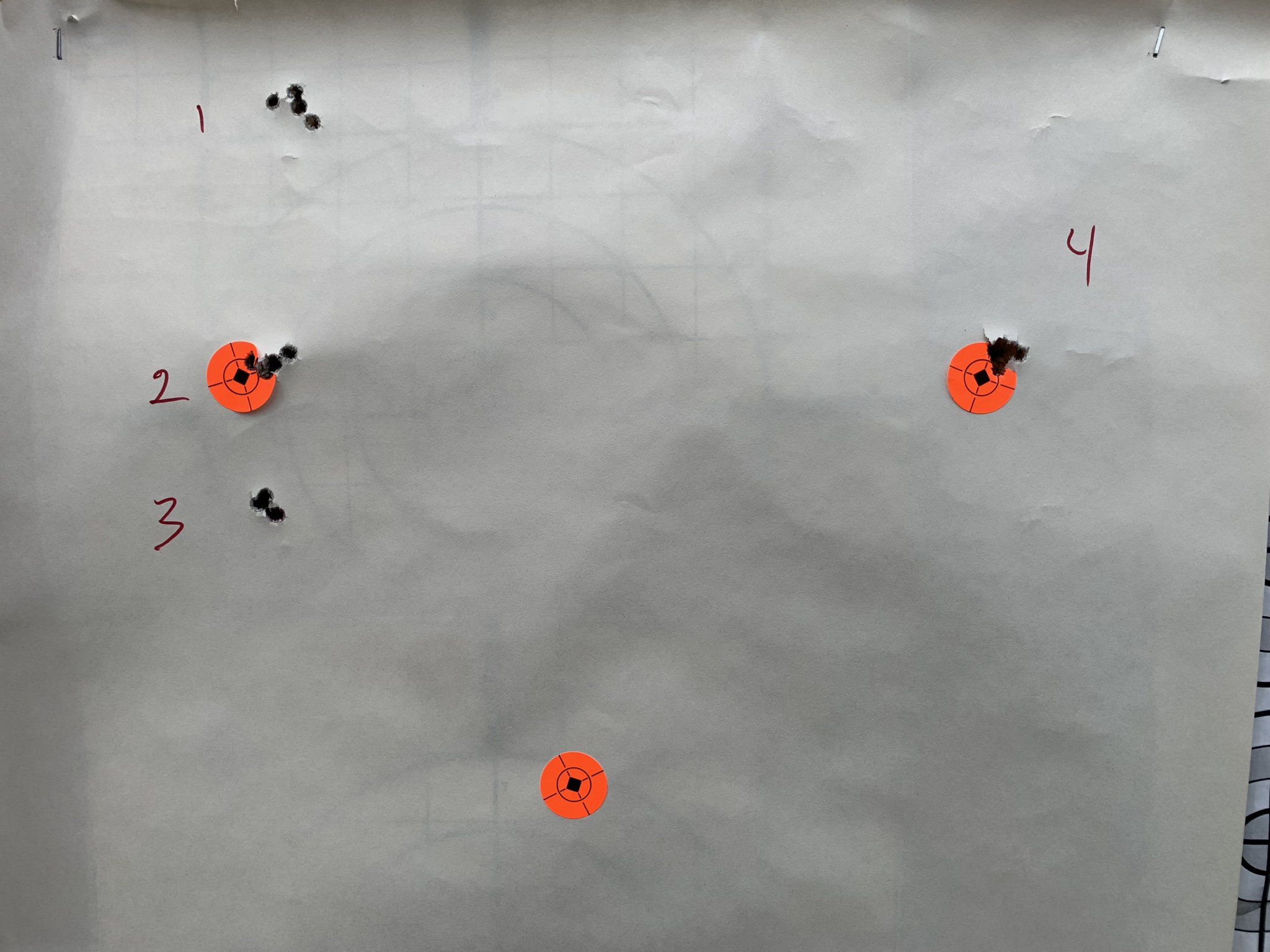

    6br here is why
    4 groups of powder test , Varget and Tac.
    2 different powder charge weights each, 29.5g and 30g.
    On of the groups had an SD of just over 60 and one 3.5.
    All groups are not so bad for 100yds.
    Would I want to shoot the high SD at distance nope, but under 400yds I would get stressed at all…
    It’s a super easy round to load for.
    I have shot 90g-115g bullets out of it and all of my groups looked like those every time.
    6br to the dasher are stupid simple!
