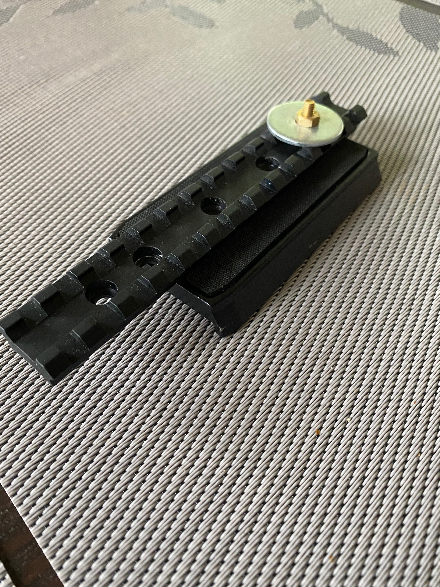

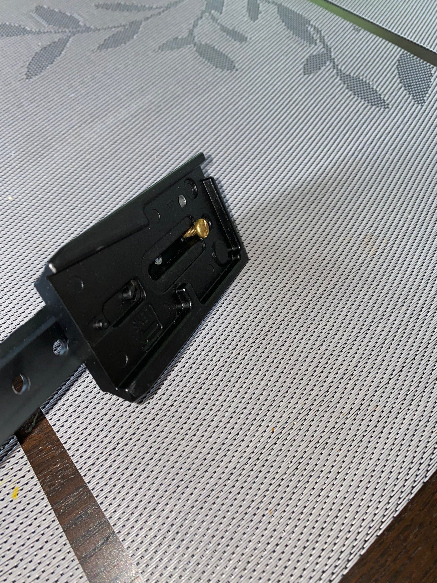

I just did exactly that this week to try out my new 7-35X ATACR.
I had an ARCA plate lying around (cheap on Amazon or similar if you dont) and a piece of Picatinney rail. The Arca Swiss rail I have has a small "nub" where a hole on the picatinney can seat onto, then bolt the other end of the pic to the plate and its solid.
I found it worked great, the best results for me came when (either with the 7-35X or the regular spotter that usually lives on there) I got the scope to the area I wanted to observe and then look through it without touching / holding it anywhere. Last time I was at the range this let me see trace easily.
