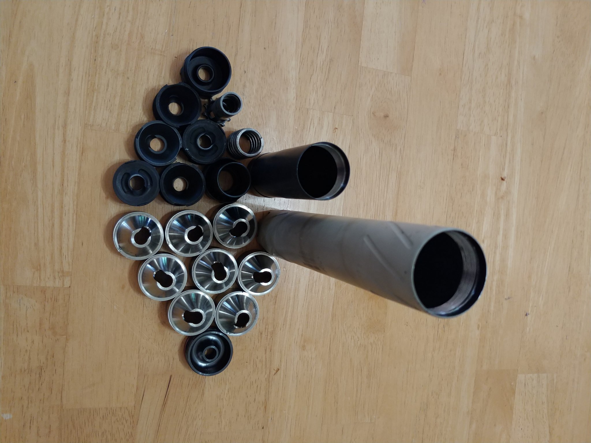

The one with the anodized black baffles is an aac ti-rant 9m can with about 300 rounds down it. It has an aluminum stack, titanium tube.
The other is titanium tube and baffle stack and has roughly 400 rounds on it since the last cleaning.
