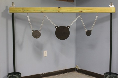

I came across these brackets that fit a T Post that work great for building a target frame onsite in minutes.
Put it together with screws and it can be broken down for easy transport.
I put this one together to do my Tall Target test. Very easy to level.
You can find these at Hang Fast Targets
You can even hang targets from them
I second this product. I have used these for about 9 months on an eight foot 2X4 holding three heavy targets. They were cheap and worked great.
