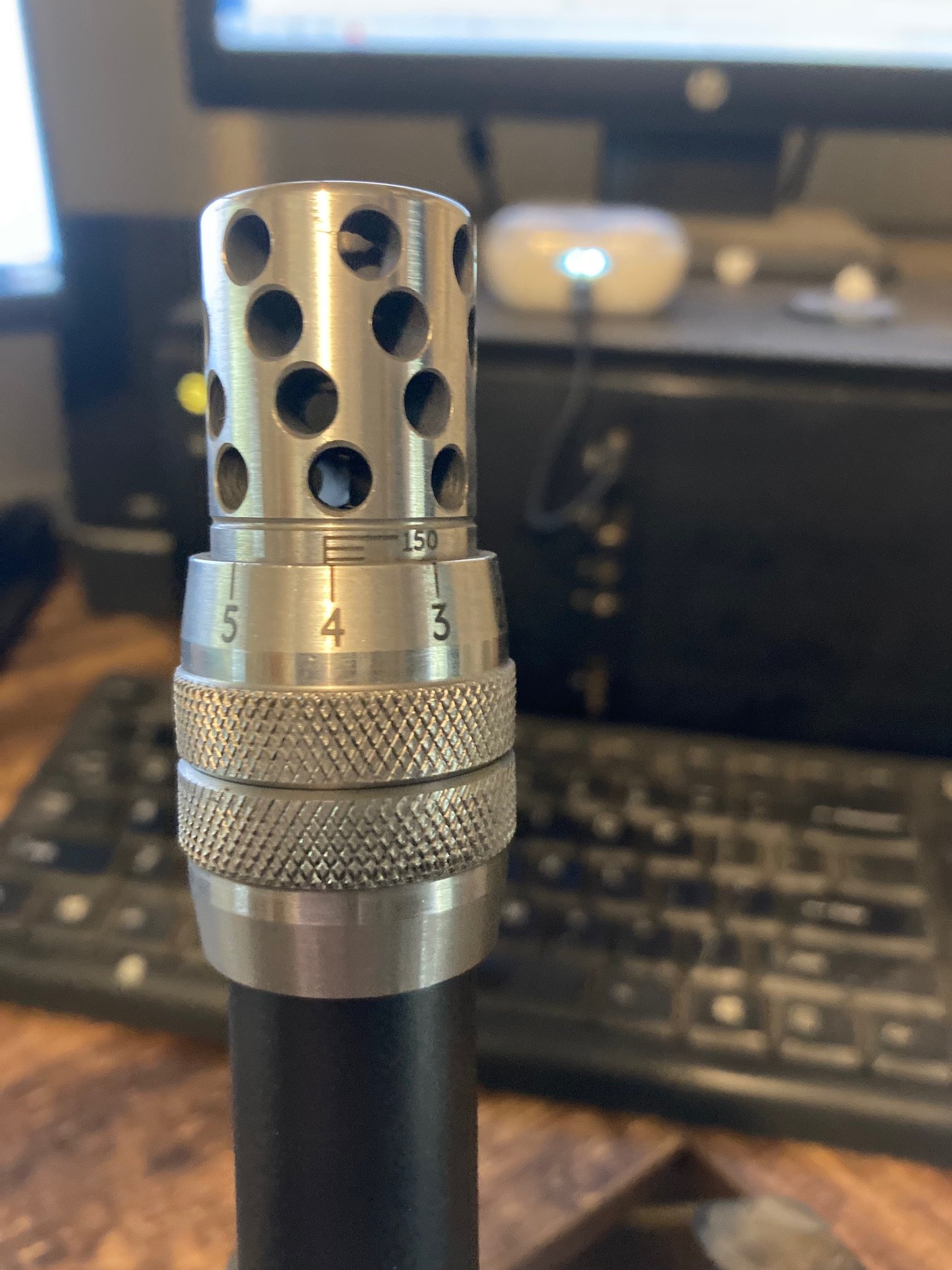

Some thoughts on barrel tuners as I don't agree with some of the reply's to your OP. There are a lot of tuners being built today and I'm sure they all work basically the same. Having said that, there probably isn't one any better than a Standard Harrels. If Your barrel won't respond to a Harrels. It won't respond to anything else. Your barrel needs to be at least 22 in long for a tuner to be effective. Lot testing ammo is not an alternative to barrel tunning. Tuners are used to improve accuracy no matter what discipline you shoot. They're not just for benchrest. If my barrel was threaded which by the way I would never do, I would consider a thread on tuner but definitely not a ported one as pictured in one reply .Ports are used to reduce recoil and are useless on a 22lr, but what they will do is carbon up and change point of aim and accuracy. Ports must be kept clean and that can be a real pain in the ass for no useful reason!
